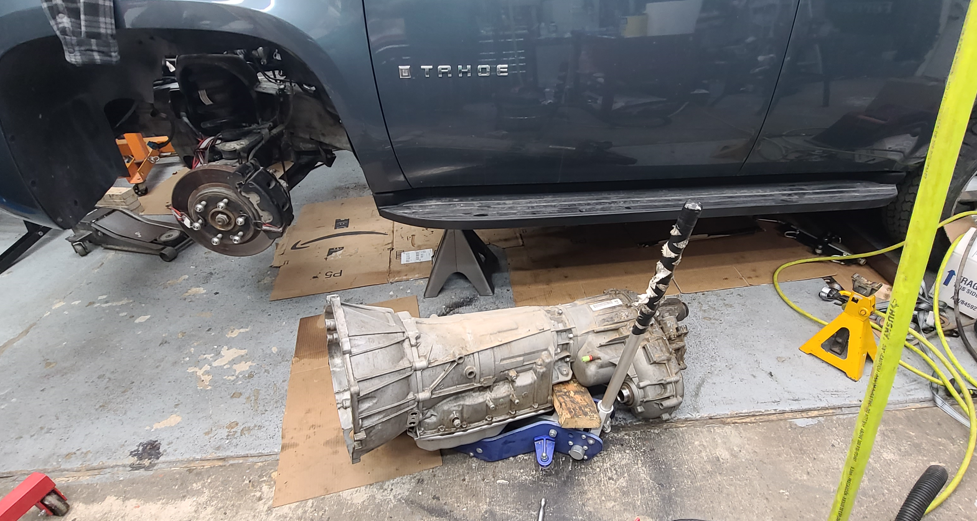

Just Fishing
Can't fix stupid
Aug 30, 2020
4,156
9,085
Utah
I got my transmission out using a motorcycle jack and a pair of harbor freight 12 ton jack stands.
I used a stacked block of wood that i screwed together in layers to get it up high enough.
Dropped the transmission down, jacked the truck back up to remove one of the stands.
Then fit the bell housing through the wheel well.
Then back with the stands until I'm ready to pop it back in there.
