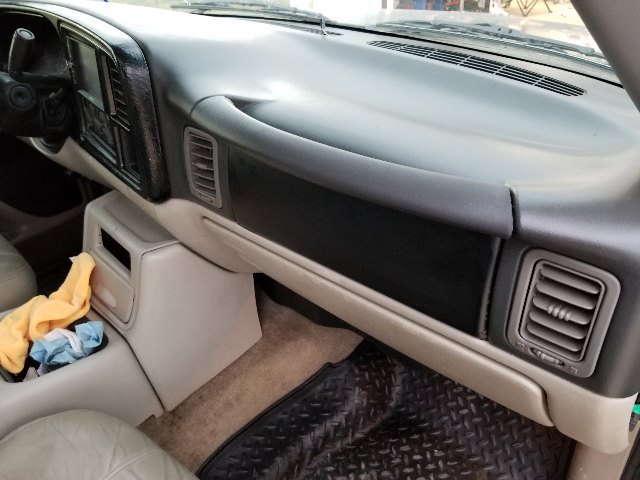

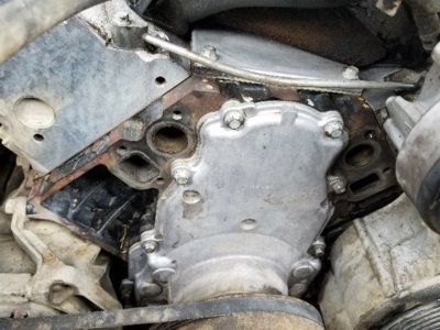

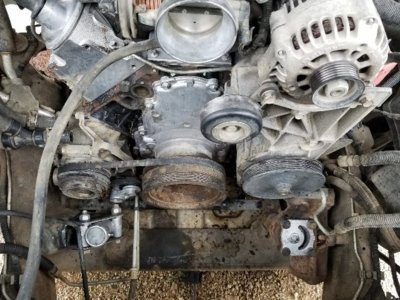

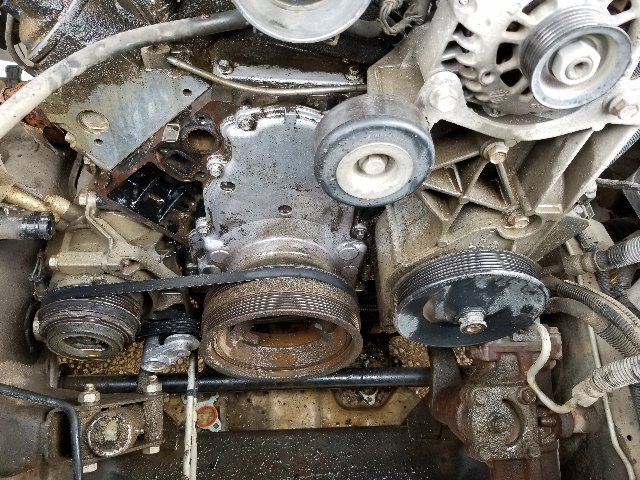

So in the last few weeks, the fuel filter crapped out; I replaced the Schrader valves, accumulator, pulley and belt, and orifice tube for the A/C; and the water pump had to be replaced.

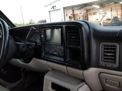

I made some progress on the interior, replacing the dash with a dark graphite one from an 03+ silverado, and a few door handles and door panels.
Next weekend's project will be replacing the shocks with bilstein 4600s and working out a seat upgrade from 6-way to 8-way power.

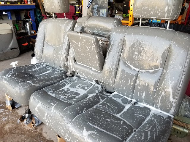

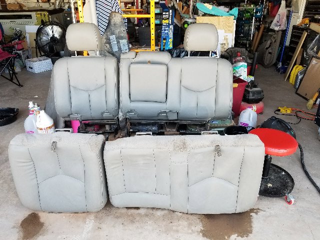

Some catch up photos....

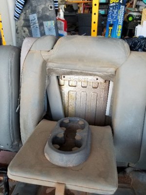

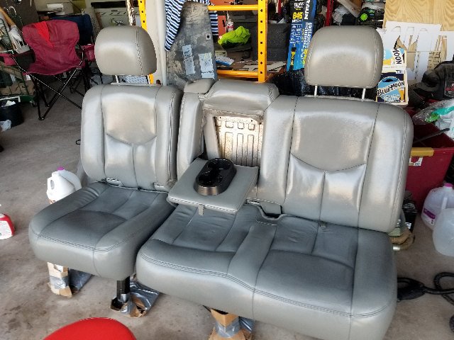

We pulled the rear gray carpet from the donor truck and I cleaned it for about 2 hours and finally gave up. Here's the result.

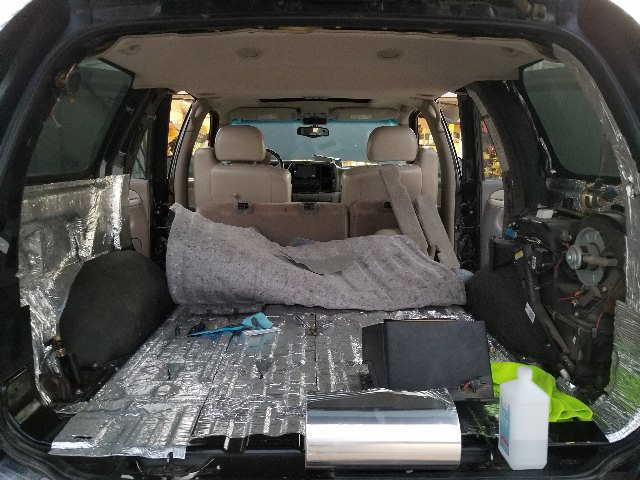

And before installing the rear carpet, we laid sound deadener/heat shield. (Frost King insulation from Lowe's.)

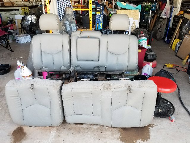

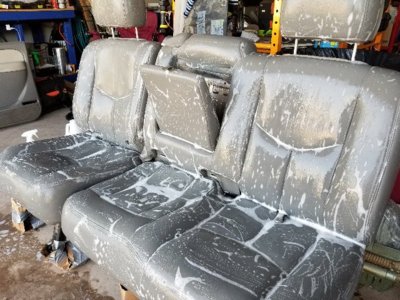

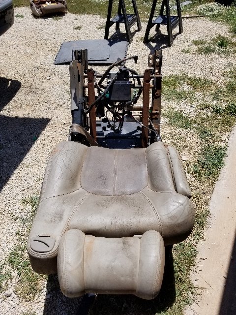

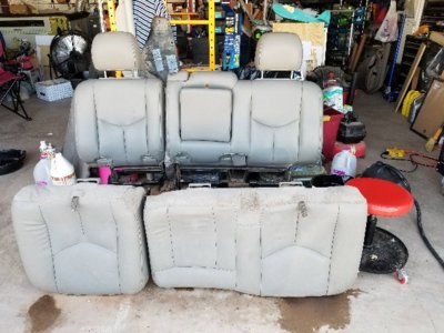

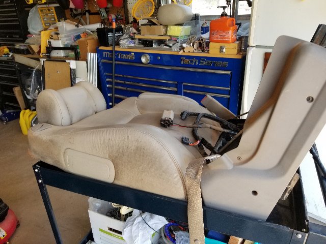

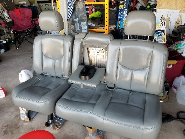

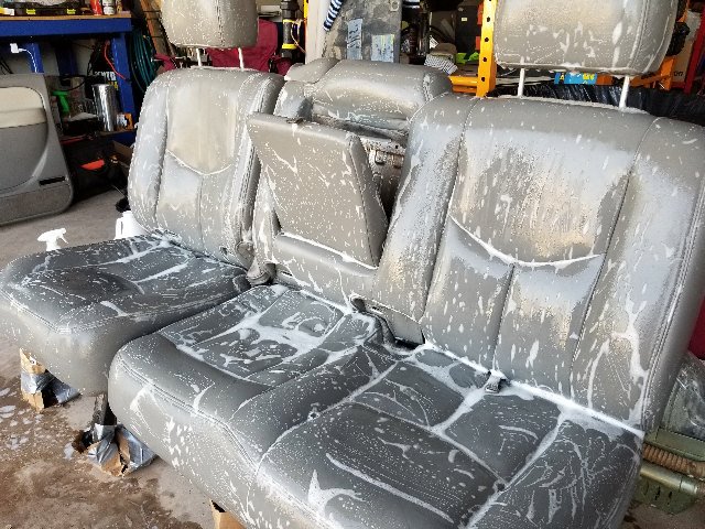

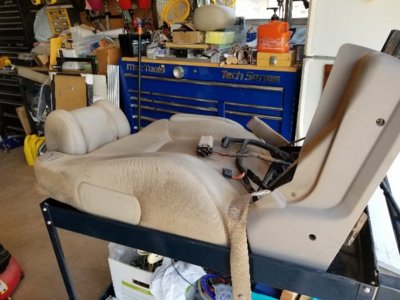

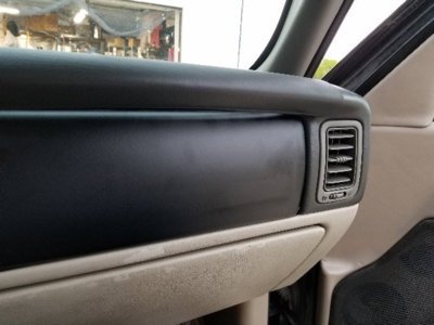

Two weeks ago I hit a local salvage yard and pulled some good leather and gray plastic from an '05 Tahoe, and a dash from an '03+ Silverado.20180414_154447_640x480.jpg 20180414_160822_640x480.jpg 20180415_121656_640x480.jpg
