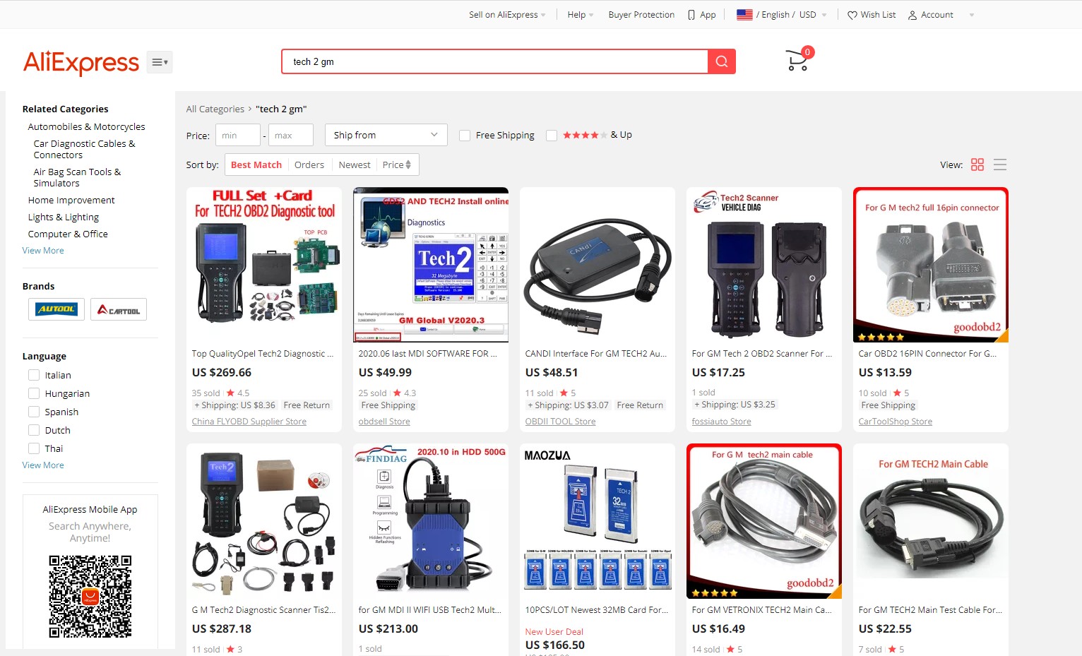

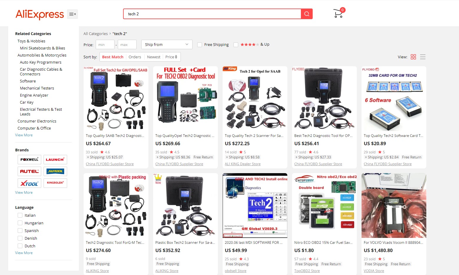

If you are interested in purchasing a Tech 2, you can obtain one at AliExpress with about a 2-3 week delivery time. The seller within AliExpress that I used was AliKing, but make sure that you purchase a Tech 2 for GM, and not Saab or other make of vehicle, as it comes with programming for specific makes of vehicles.
