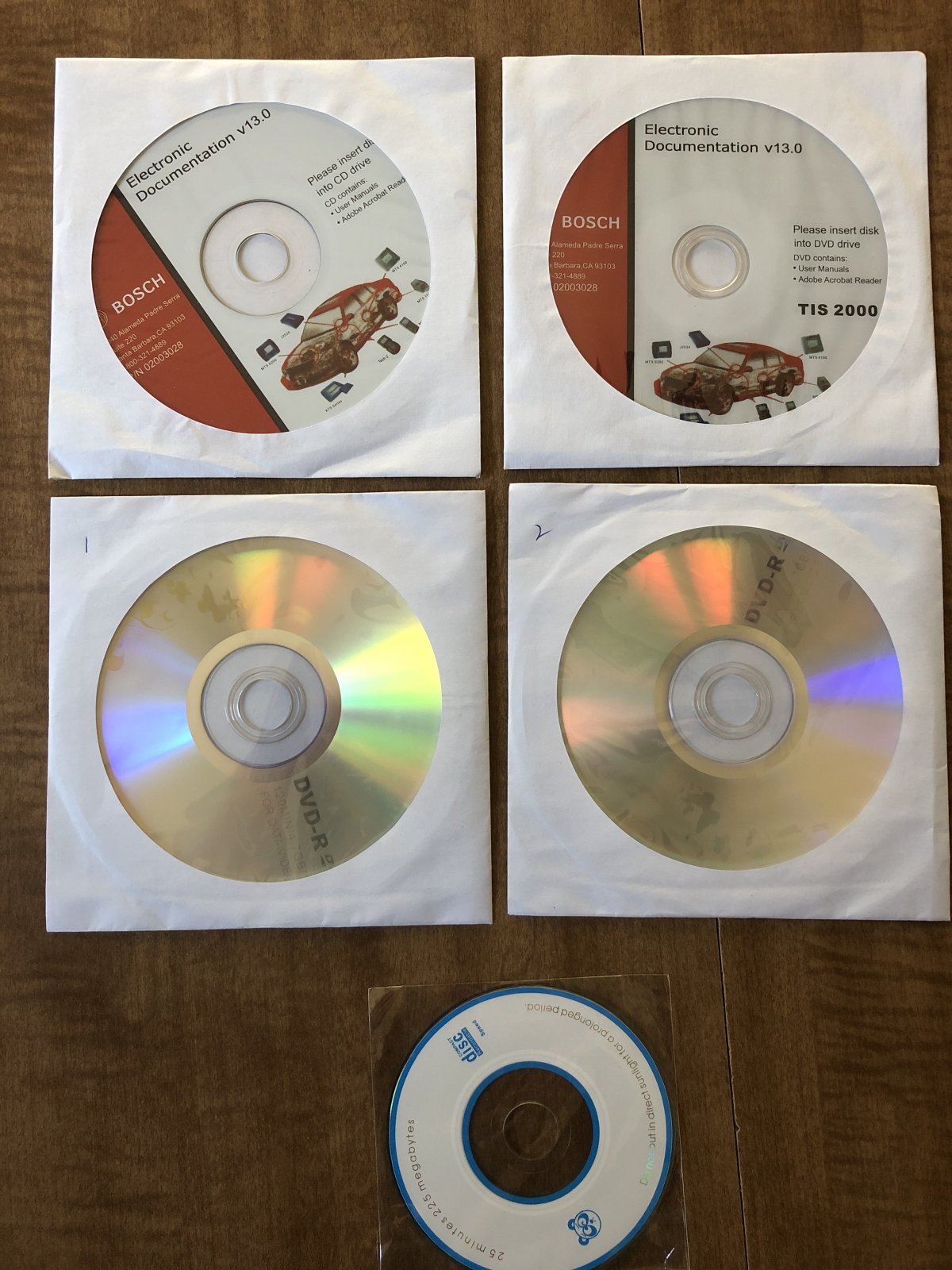

Just got mine from Chinacar diags
They did not send the decals because they said DHL would confiscate it. I asked that they send them to me separate. .
Haven't really used it yet other than to verify my oil pressure .
Sent from my SM-G973U1 using Tapatalk
What are the decals for?
