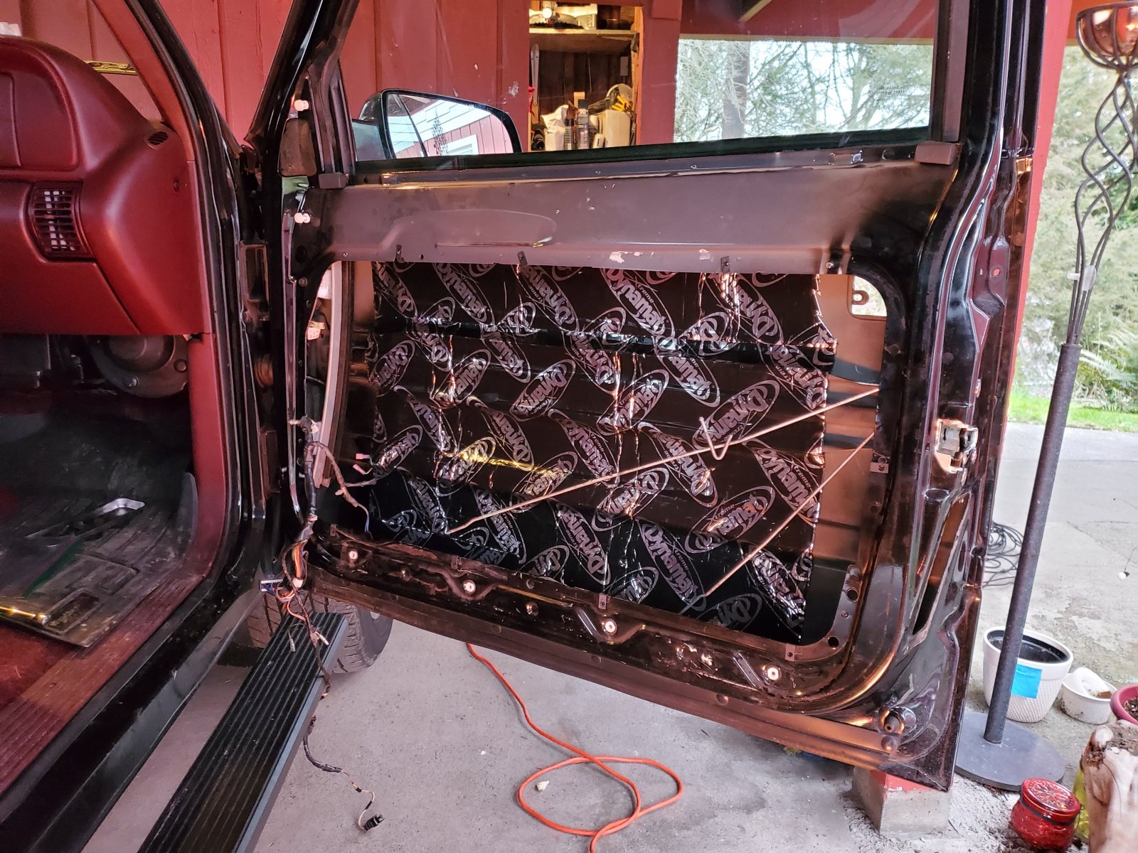

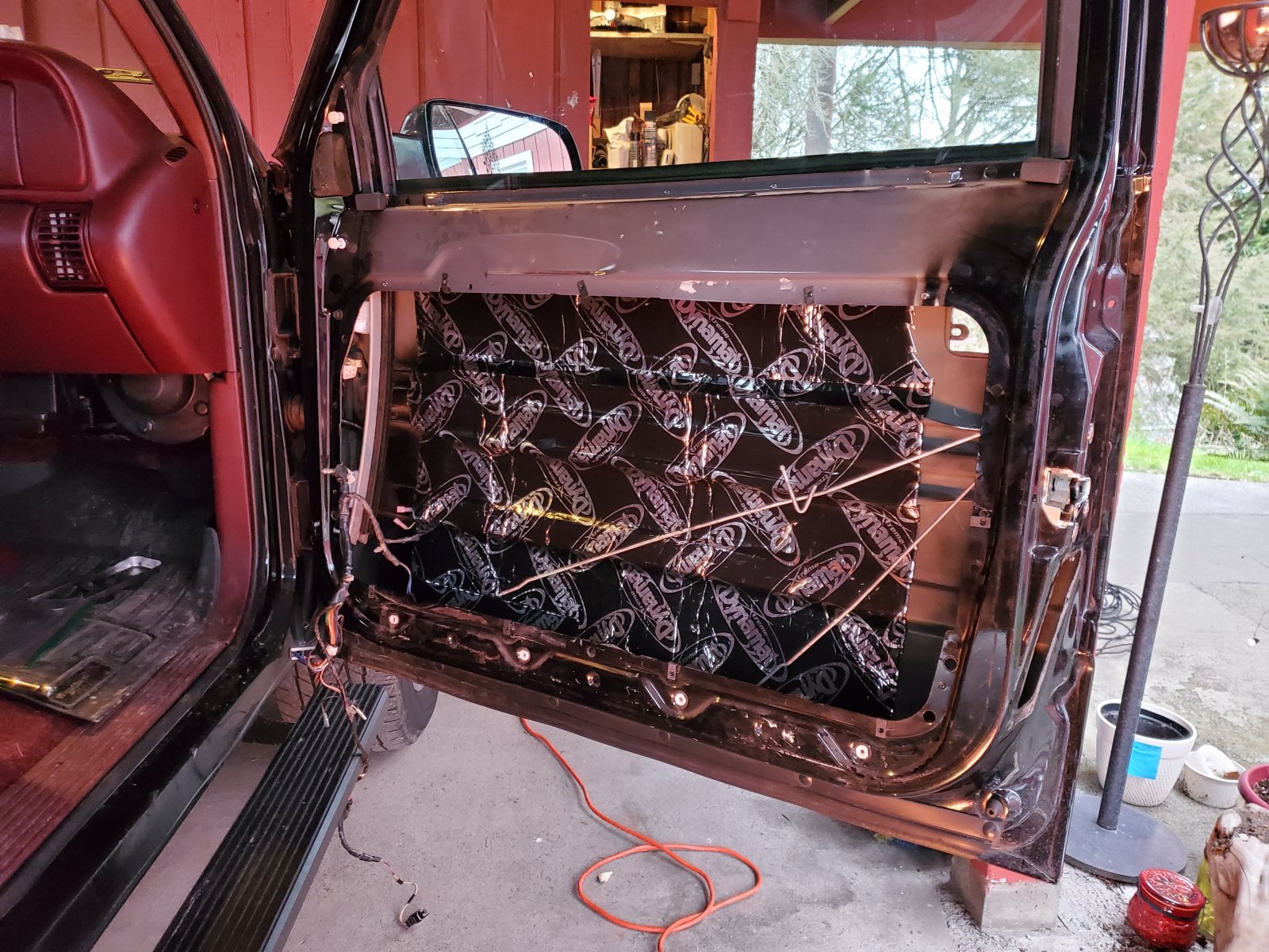

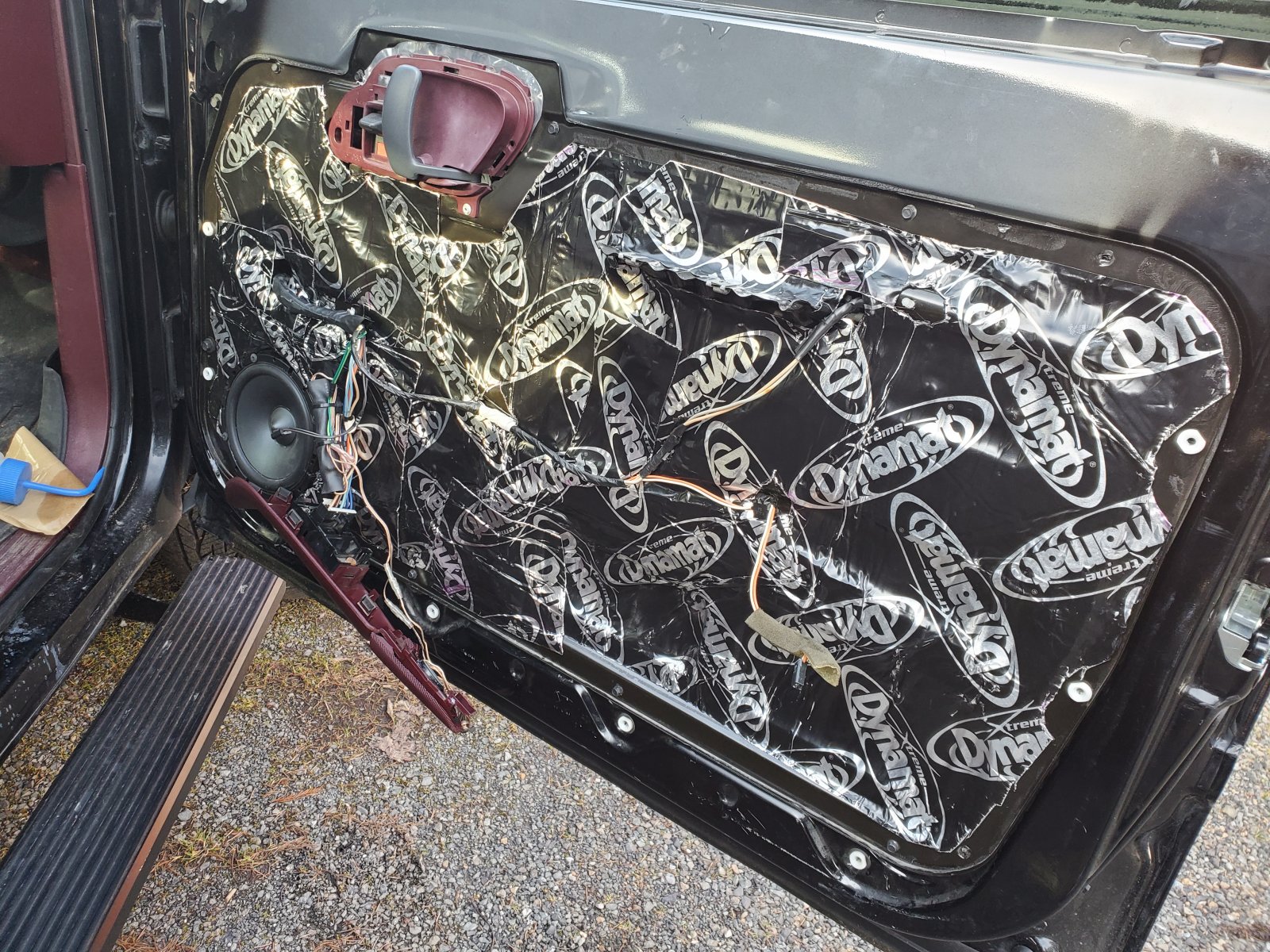

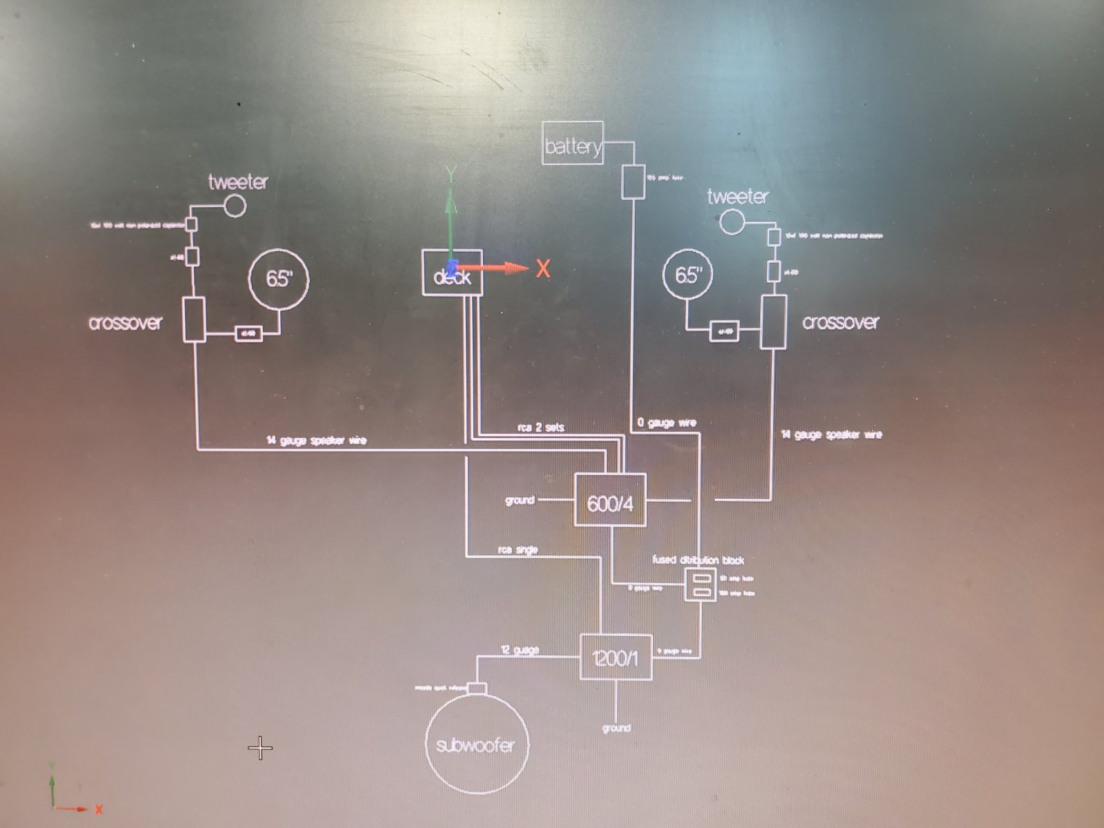

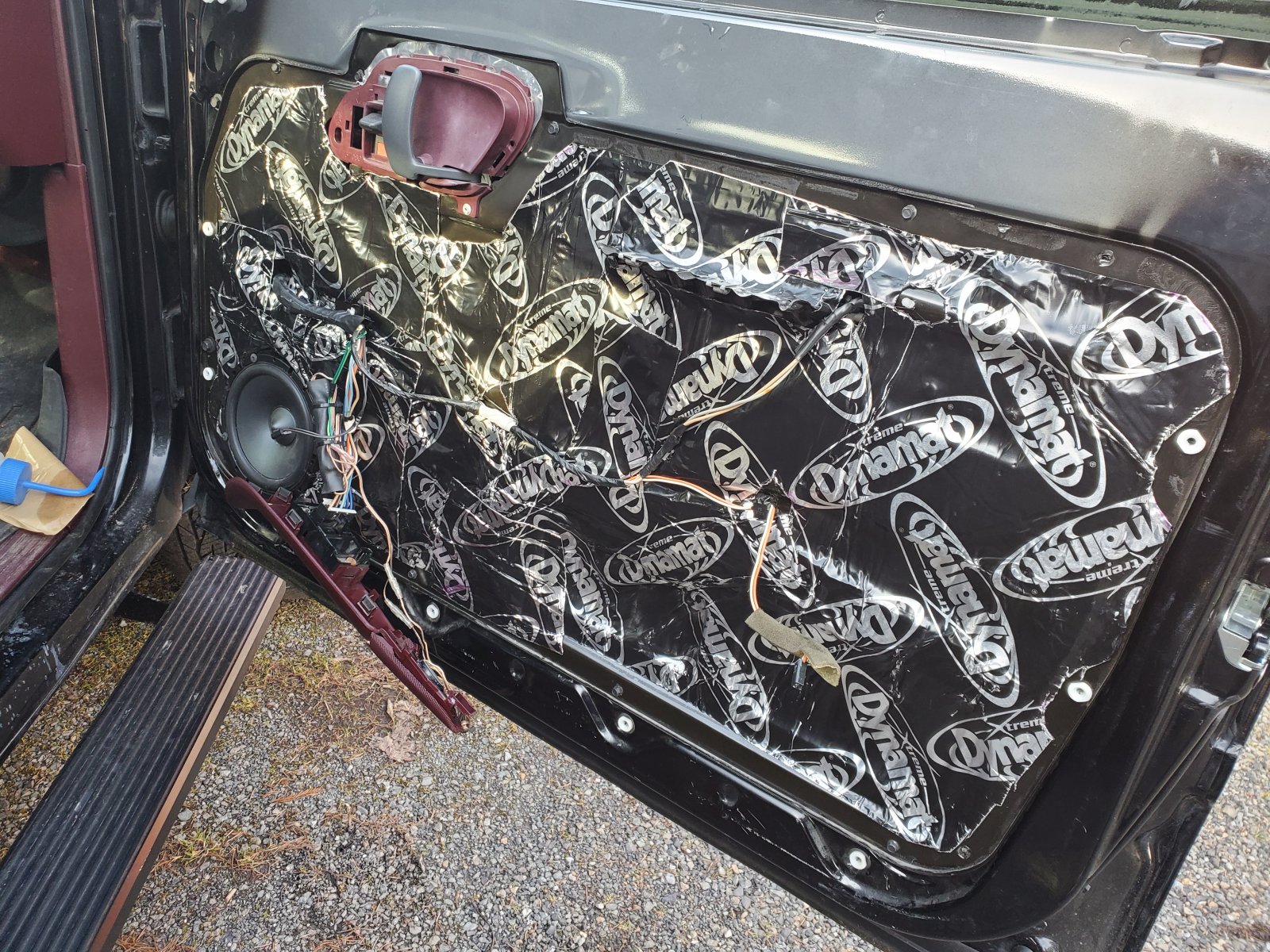

Been a long time coming, I havent had my sub and amps in a vehicle for about 3 years... maybe more. I'm going to try to do this like a build thread and document nicely what I do... we'll see how well that works haha. I'm just starting to hoard parts here is what I have so far. 1998 2 door tahoe by the way.
from my previous vehicle
12" jl audio w7 in the pro wedge box
jl hd 1200x1 amp
jl hd 600x4 amp
jl bass knob
bought specifically for the tahoe
metra 95-3003g double din dash kit
Progress will be slow but it should be interesting. I'm making a custom amp rack, putting 6x9's in the back component 6.5's in the front and a backup camera. Also considering doing some... or a lot of sound deadening.

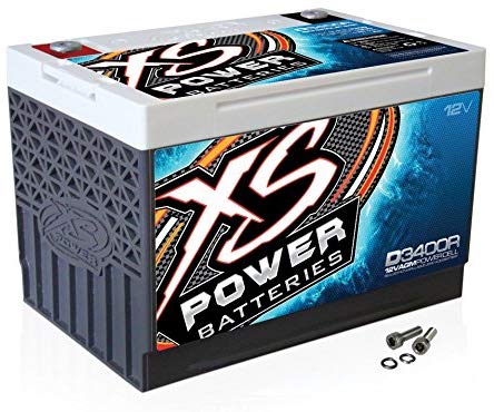

Possible dual alternator, high output alternator or extra battery maybe both. I know these amps will dim the headlight on a optima yellow top so I have to do something
