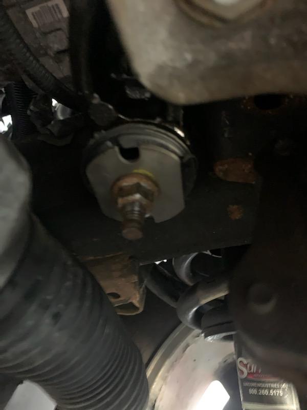

I've had a clunk in my 07 Yukon XL Denali, since I bought it as-new-to-me, and I have finally solved it.
Whenever I was stopped and pushed the accelerator pedal, I would hear/feel a clunk somewhere under my seat. Similarly, whenever I was slowing down, and the transmission downshifted, I would hear/feel the same clunk. I went out of my way to avoid the situations that led to the clunk, so as not to create any potential further damage, until I found out the source of the clunk.
I had thought that the cause of the clunk was the drive shaft slip yoke, as suggested by members of this Forum. As such, I purchased a new nickel plated slip yoke and two new universal joints for that drive shaft, and I had them installed by my local mechanic. Unfortunately, after the installation, the clunk was still there.
Further inspection of the entire drive train and support structure revealed that the bushing assemblies on one of the front differential support mounts were badly worn and required replacement. As such, I had both front differential support mounts and all 4 bushing assemblies replaced. After the installation, the clunk was not longer there.
Our knowledge base for clunk causes and resolutions has been increased.
So I have already found the 2 arms below your pictures but what exactly are these called as im not finding them anywhere. Thank you and sorry im late to this issue.....
Front differential support mounts. Be sure that they come with the bushings on both ends of each mount.

@Stratrider10, welcome to the forum and it is explained what they are in the post. Are you saying you cannot find these mounts when looking up by application?
Okay I was a bit confused on this as I saw the 2 arms and didn't recognize that the bushings were a part of the next photo then..... sorry mate I thought there was a total of 6 bushings instead of JUST the two per arm, like it was another portion. The '07½ yukon denali awd is kinda a new one for me as my previous '07½ tahoe didn't have ½ the issues I'm having with this one. Needs some new front struts and rear shocks but holy cow the cost on those are ridiculous was told you could get some front struts that will cancel out the electronics of the stock but ‍♂️ been working on cars for about 12yrs but nothing with this many bells and whistles. This is my wife's SUV while I drive old reliable '97 K2500 and love the crank windows because they never fail. Thanks for the help guys I really do appreciate your help and time on an old post.
