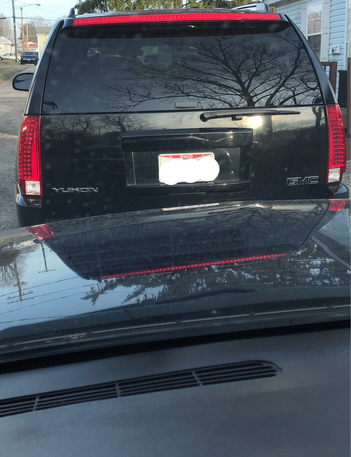

BOOM - felt like someone punched me in the back, neck and shoulders... I got rear-ended... 21 year old girl, texting... for the most part everyone was "okay", she had double air bag deployment and her passenger went to the hospital for a minor head injury, I'm fine... however, the back of the only non human non canine thing i care about was effed up... hitch cover/panel destroyed, rear bumper cover destroyed, lift gate gouged pretty good, step pad and chrome strip - gouged and scratched pretty bad, exhaust tip slightly bent... Michigan being the only true "no fault" state, I'm responsible for my insurance deductible which is $500 I dont have lying around... the appraisal/adjuster from the insurance company comes on monday, and i am far from looking forward to arguing with him or her on whats what and making EVERYTHING right...
So Now What... - As with anything in life, trying to spin this into a positive... I spoke with the insurance company today and they asked me if I wanted them to cut me the check directly, or write it out to the shop I am going to choose to do the work... I have never been in an accident before, so i guess this never even came to mind... but maybe i go that route, use the money to go for the escalade bumper swap... do the labor (minus the painting) myself... and maybe, just maybe (all depending on the appraisal quote and what the labor comes out to) I'll have enough to come close to doing the Corsa exhaust along with it and come out on top??? Fingers crossed... I'm wondering, if any of you guys know, just how much of the stock exhaust system is different and what parts/numbers are needed (between muffler and tips) from the premium escalade and the denali... like what pipe piece is needed and where the split happens, in case I cant afford the corsa just yet... wish me luck, I/we could sure use some!
"you should see the other guy!" photo...
and finally... the... "if ONE more person tells me "ohhh... its not that bad!" I'm going to lose my shit" photos...
