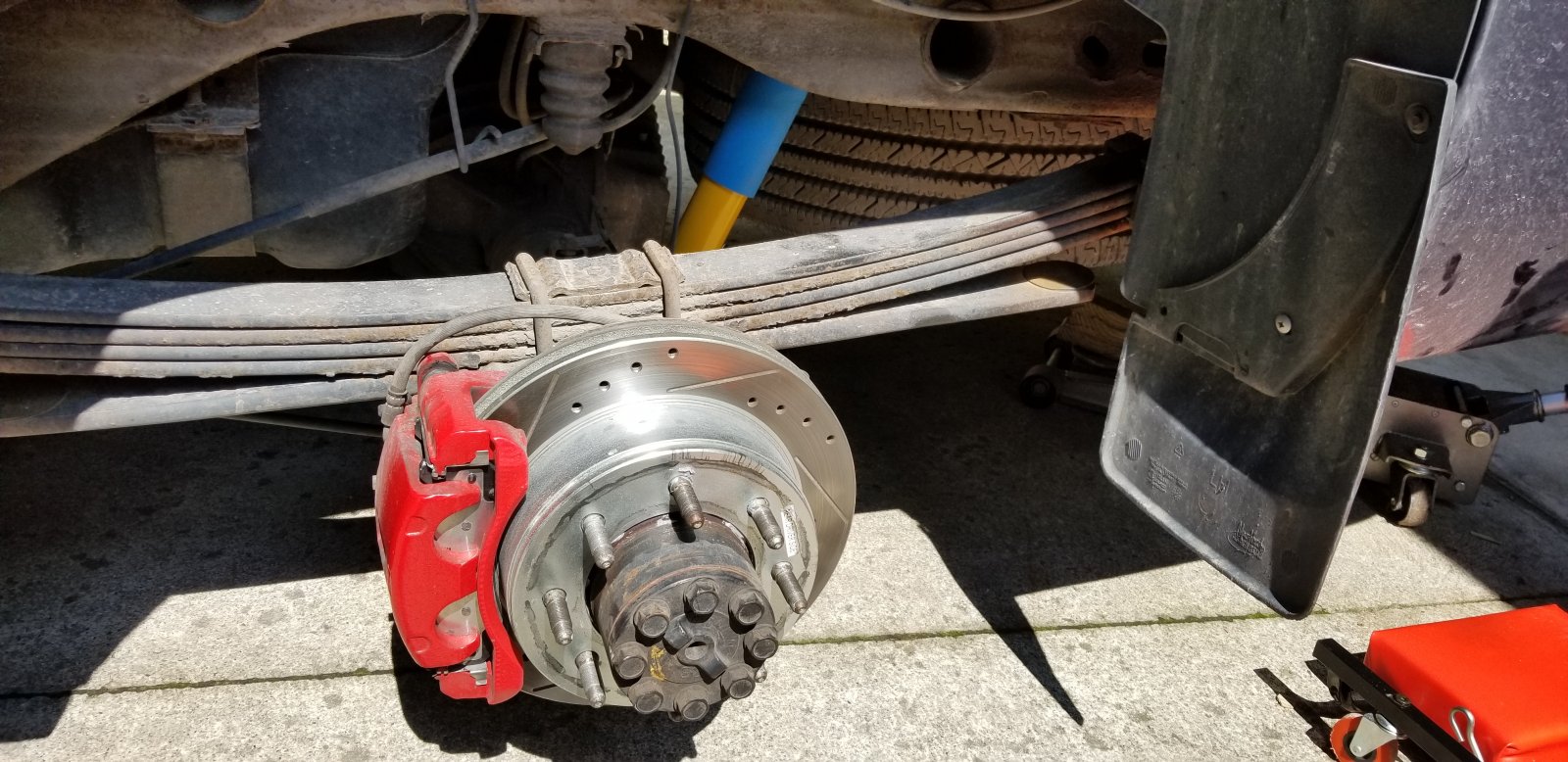

Parts trickling in...new AC/Delco PS pump, new AC/Delco master cylinder, Gates high-pressure hoses - all received.
The Powerstop kit from Walmart was only half right. Two sets of front calipers/rotors/pads. One 8-lug, one 6-lug. :confused: :(
Ordered the same kit from Auto Anything, just got the notice it's shipping out today. So probably next weekend we'll get on replacing all that stuff. It'll be a good Father's Day present to myself.

Well, I guess this is why the emergency/parking brake never worked, eh? :confused:
I have to admit I'm torn - I like my stuff working properly, but I've also gone 7 years without it, so do I spend the extra money?
We would need to pull hubs and we'd need seals, gaskets, lube, e-brake shoes and e-brake hardware.
I think I'll pass at the moment.
Without the parking brake, all that weight is on the parking pawl in the transmission, even more so if she's not parked level.

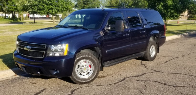

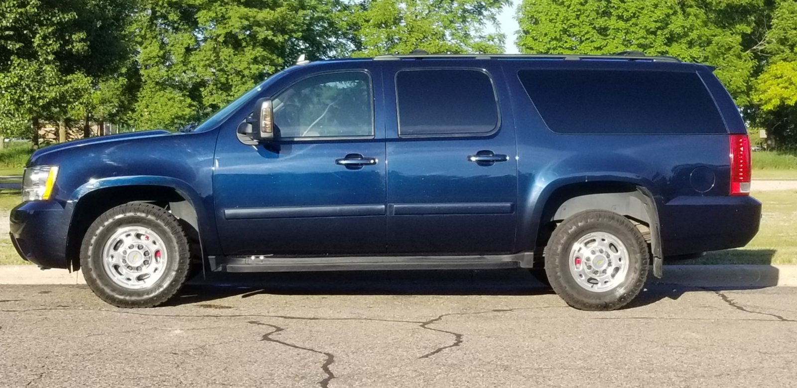

My 2500 Suburban has been the best vehicle I've ever owned. Completely reliable (except for the computer running me out of gas a few times), very low cost of ownership as the odometer rolled 200k miles.
Had a major issue with her - loss of oil pressure. The result was engine damage, and the oil looking like metal flake paint. I looked at used car prices, 2500 prices, and decided I'm going to keep her long-term.
GM remanufactured engine - 100k mile warranty. Replaced some leaky cooler lines. A few other things. Decided AGAINST any performance mods - cam, forced induction, etc - since whatever I did was still bolting up to a 200k mile transmission. If the transmission goes, then, well, we might do some "improvements."

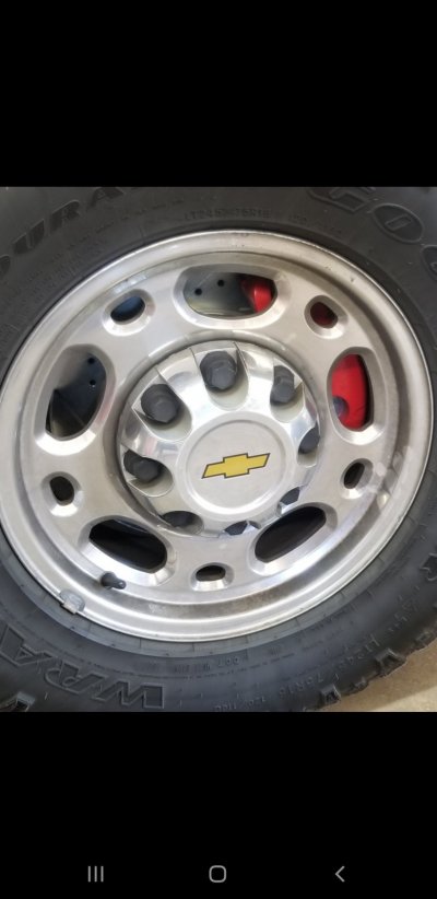

Next up - new braking system - Powerstop Z36 calipers, rotors and pads, new power steering pump (hydroboost brakes), new master cylinder. Freaking Walmart had the best price on the PowerStop kit - $824. Should look pretty sharp with the red powder-coated calipers peeking out from the wheels.
Closing in on $10k invested.
A few pics to start....More updates coming....Brakes will be done in a few weeks...
