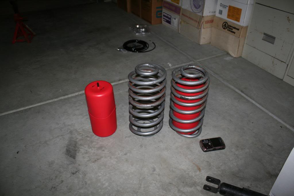

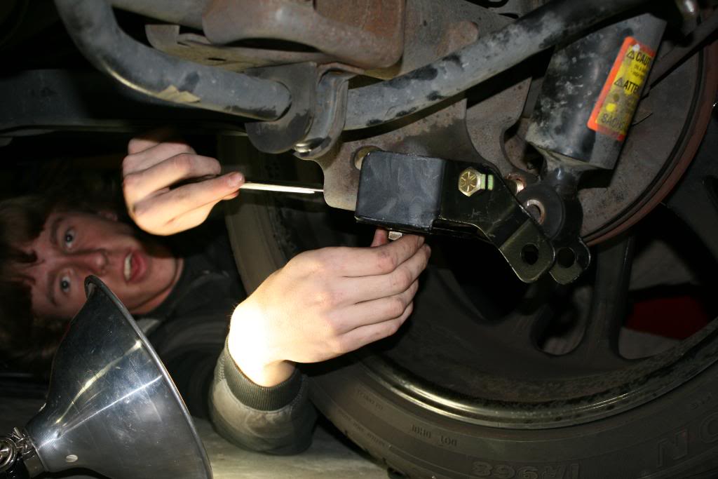

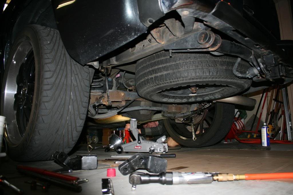

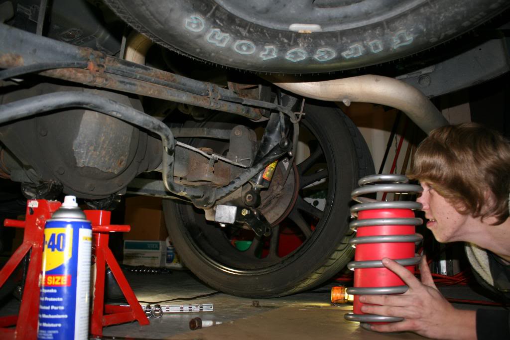

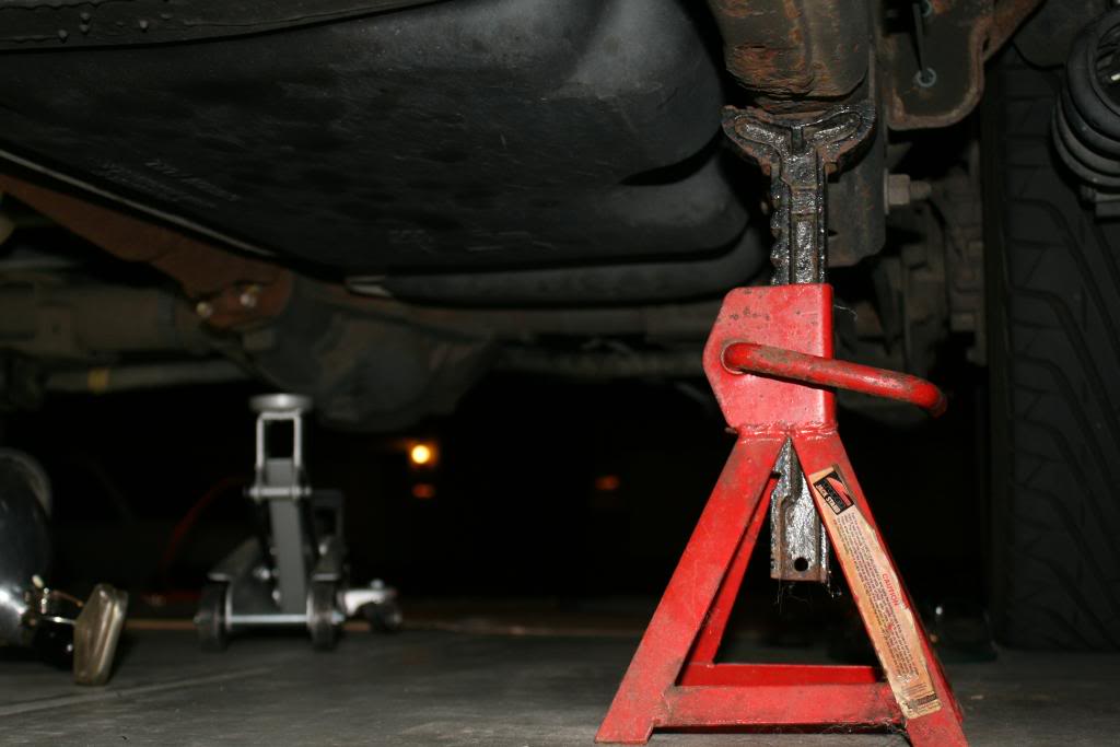

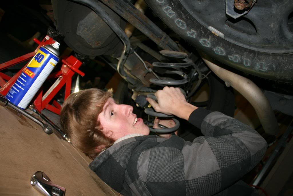

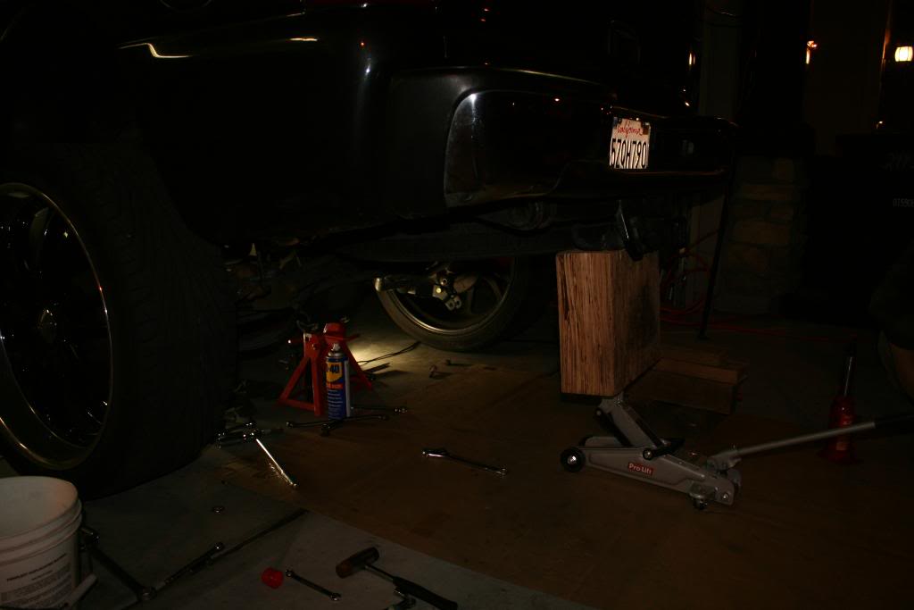

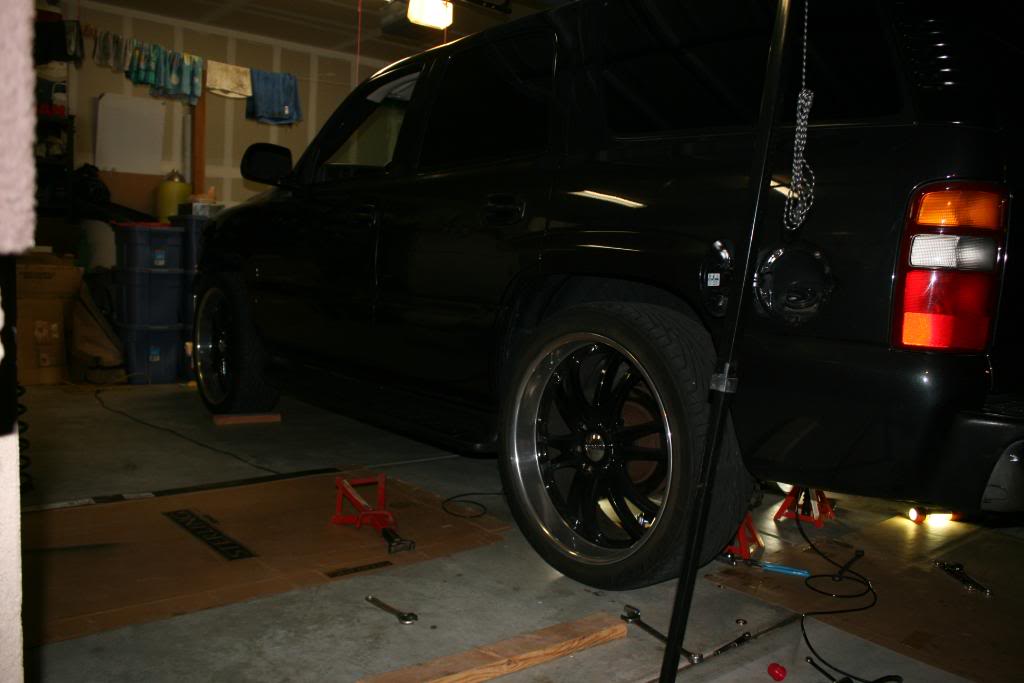

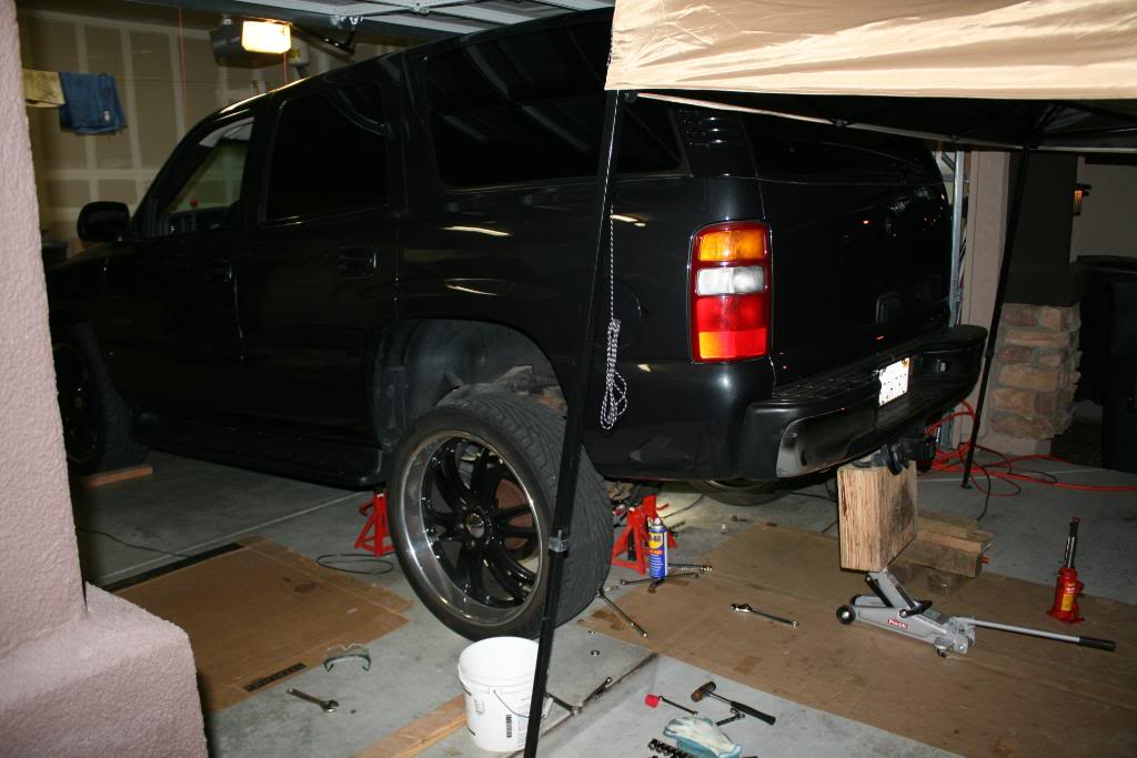

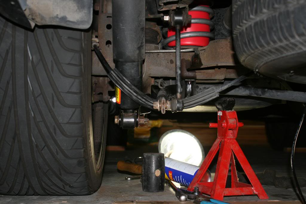

I don't think I mentioned this was all done with a 2 ton floor jack, some blocks of wood and 4 jack stands
everything had to be readjusted after we would do one step.
take off sway bars.. readjust
take off shock mount.. readjust
mount the shock relocator.. readjust probably 3 times
it was a big learning process
but both Blizzard and I were in for the thrill of seeing it once it was off the jack stands and on the ground :D

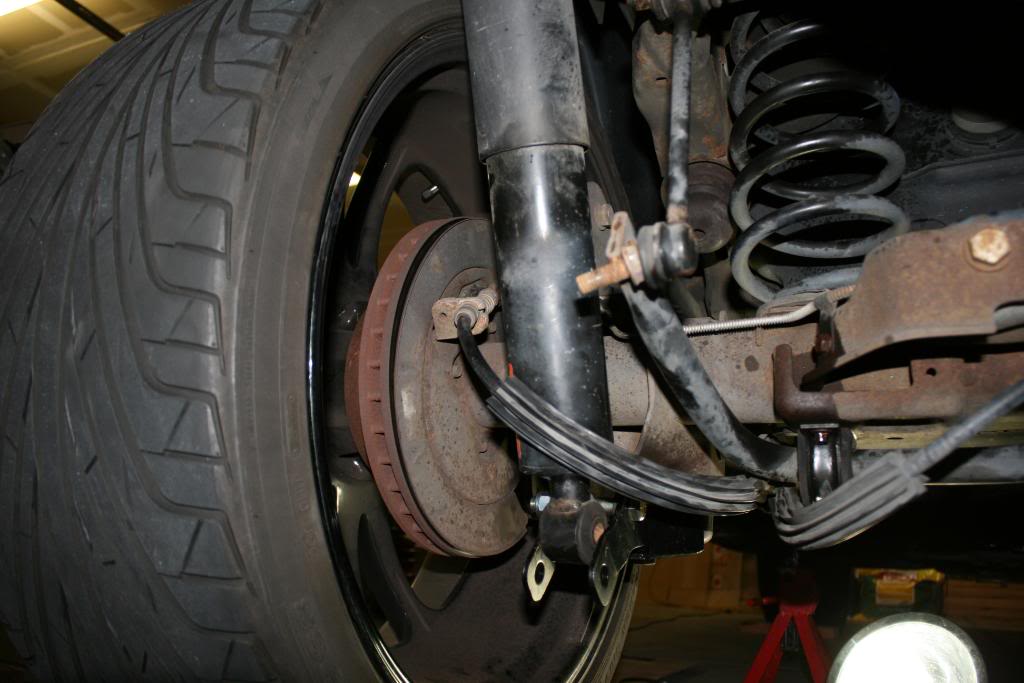

I remember when i put the wheels on, that the upper shock bolt in the rear was very close to the tire. its as easy as just taking it out and flipping the bolt the other way were the head of the bolt is toward the tire and not the shaft. just so you dont chew up some tires.

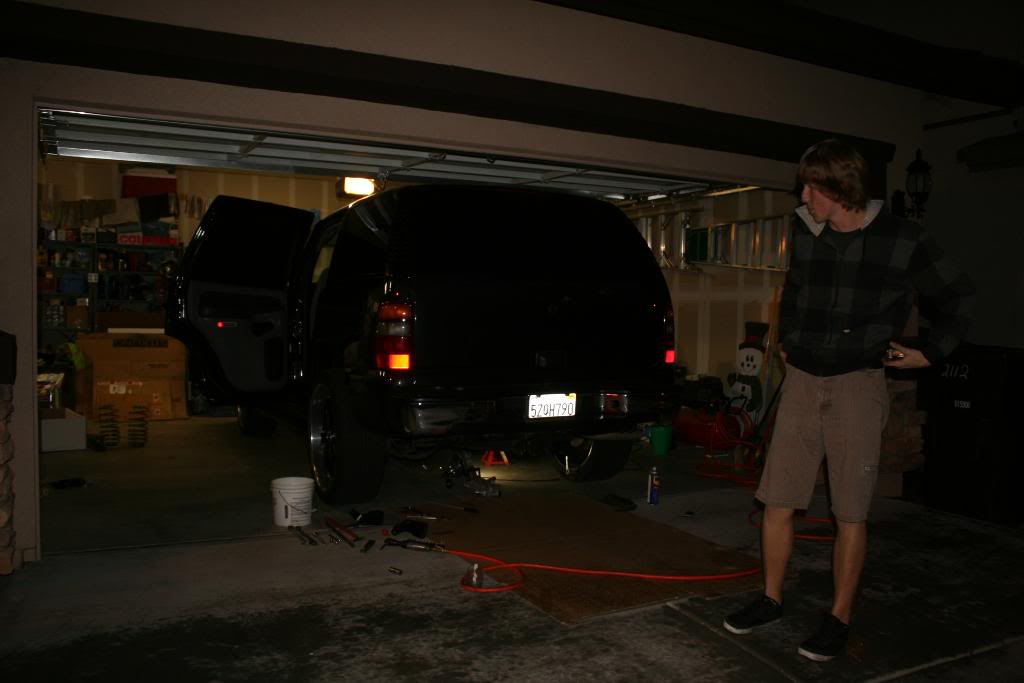

yeah just got home from autozone in rocklin only place that had a 2/3 gear puller for rent
my 2 claw puller was too small
blizzard just called me so I think he might be headin over soon

can't get the damn keys out!
let some WD40 sit on them for a while....

still ain't coming out lol and the cross member is pissing me off
