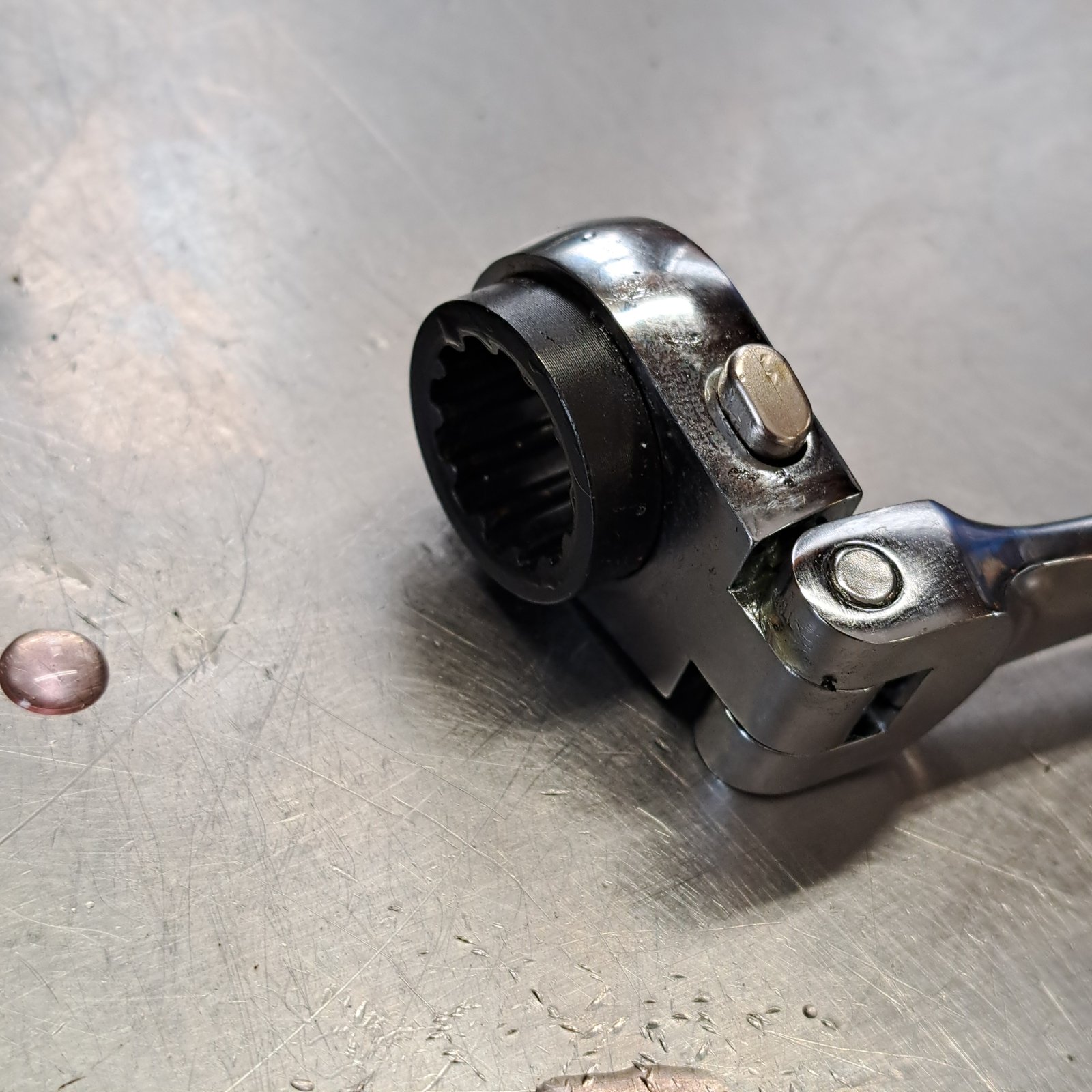

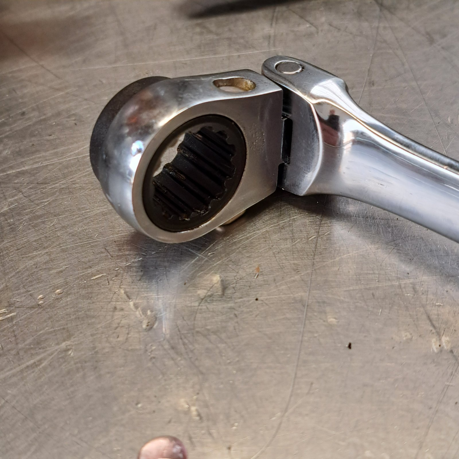

Once I got home from the interview and talked to my girl about why I was not taking the job and she was happy and then told me to quit moping around and do something on her truck or my Tahoe. Yesterday I did the door drip rail seals on her truck and I had the Dorman exhaust manifold clamp for the driver's side rear, of Tahoe, and decided to do it. It was a bit of a PITA. Took me 1.5 hours on my back while it was on jack stands. Removed the firewall heat shield and disconnected the front driveshaft and moved out of the way. Still very tight quarters. The lower bolt at back of head is easiest to get to while having the bolt in the bracket hole and finding the threaded hole while holding bolt and bracket with one hand. The top hole has less room but is easier to swing the bracket in to position and find the hole and get a couple threads started. Then you just hold your tongue right and thread bolts in with tips of fingers because there is not enough room to hold your palm back and reach with fingers to thread easier. I tightened down till the bracket was snug and then threaded in the bolt that goes in to threaded hole and ends up pushing the manifold tight. Then I used ratcheting wrenches and again held the tongue right and tightened all down but you really have no room for leverage to tighten very much. I then got an offset long wrench and was able to tighten down quite tight. The bracket bolts are 14mm, the firewall heat shield is 10mm and the 4 bolts at the driveshaft are 11mm. Only damaged the right hand in two places and most of this was done blind because you cannot see past your arm and hand.

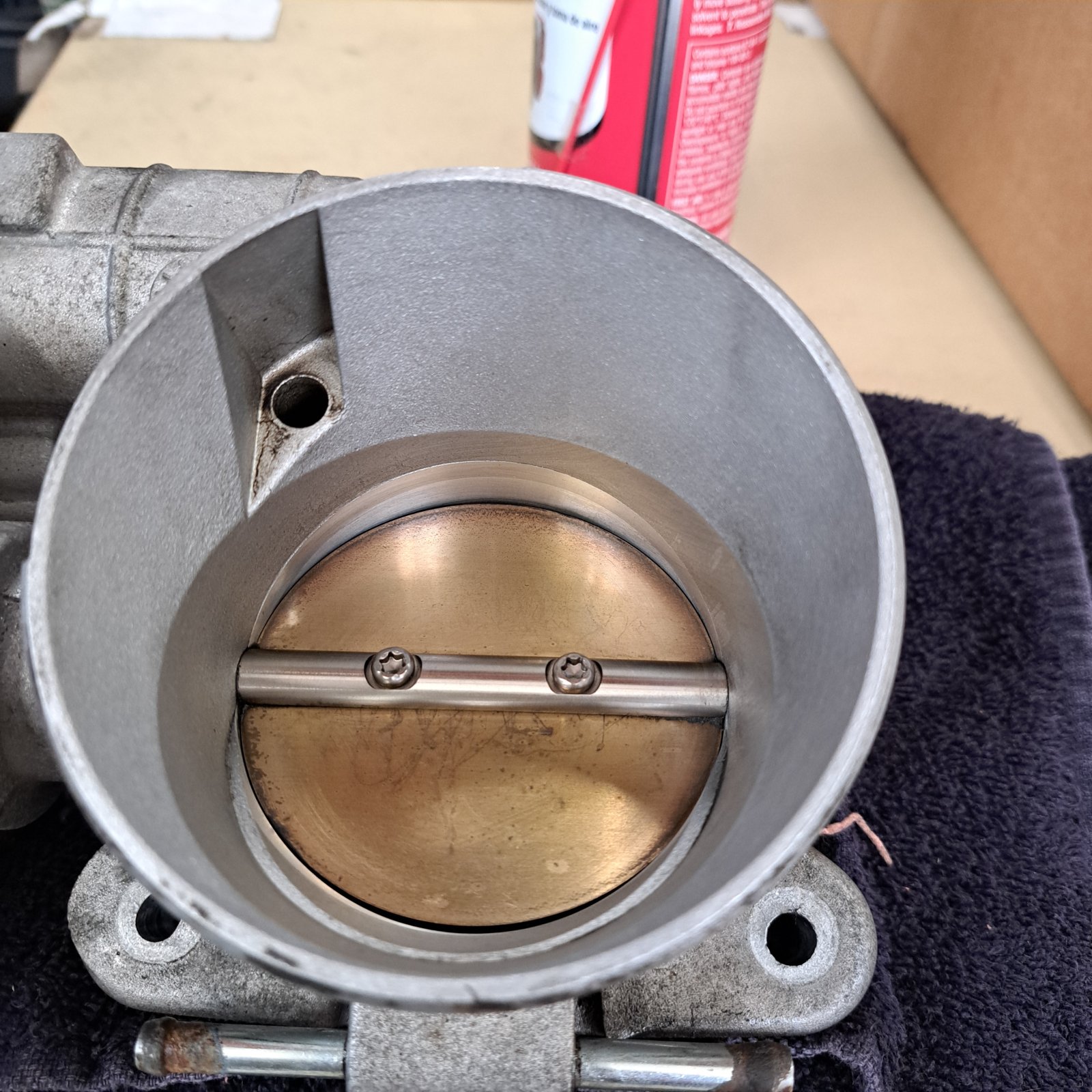

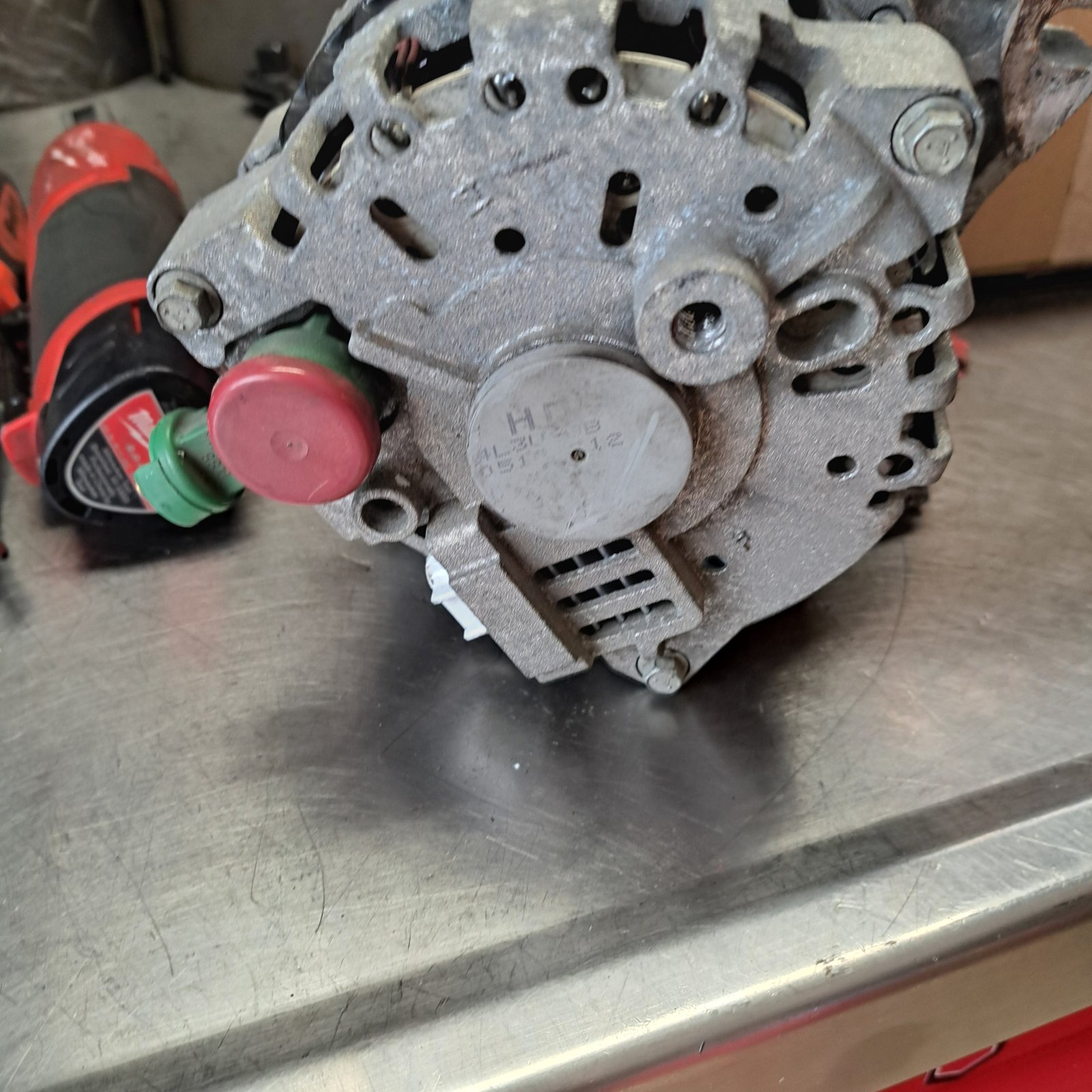

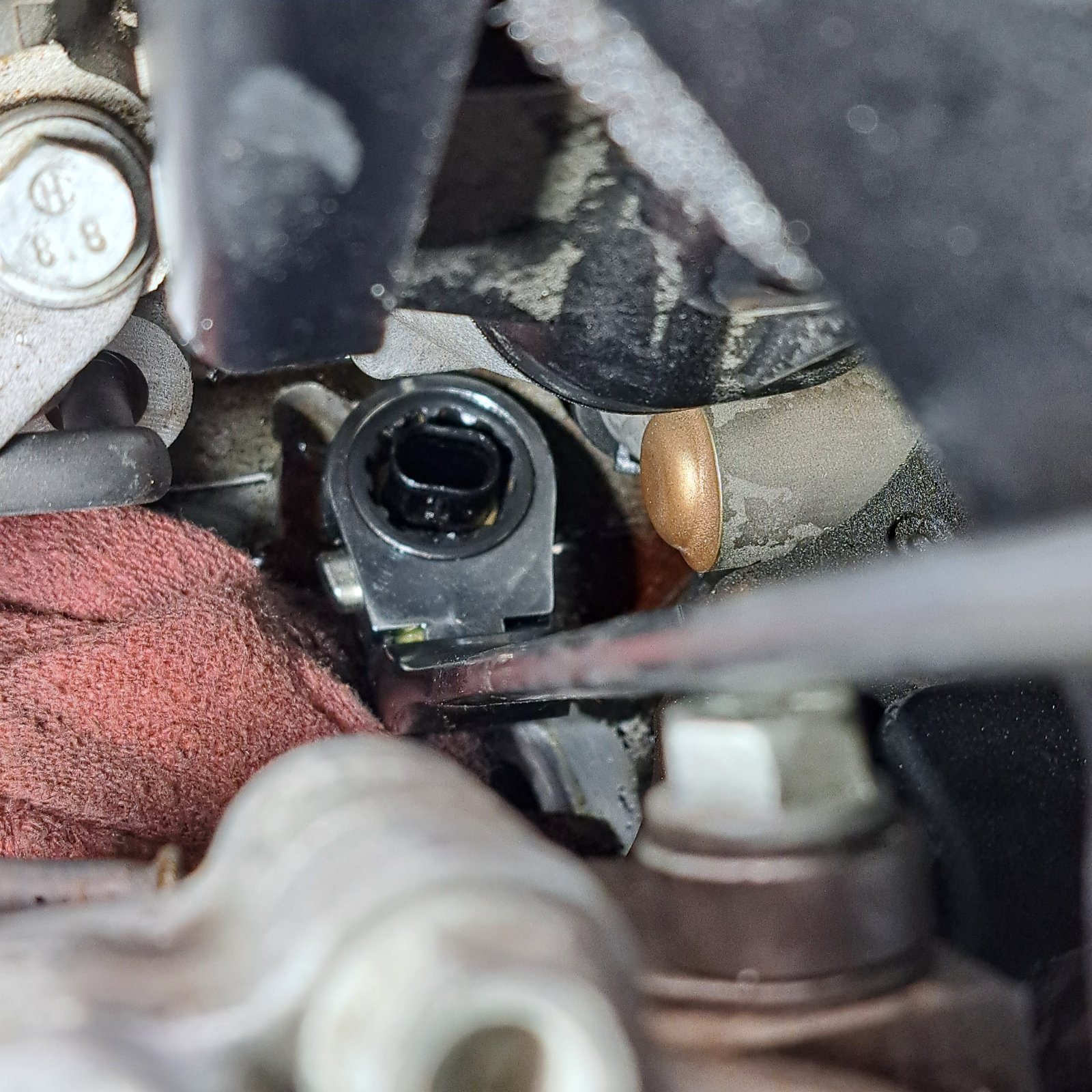

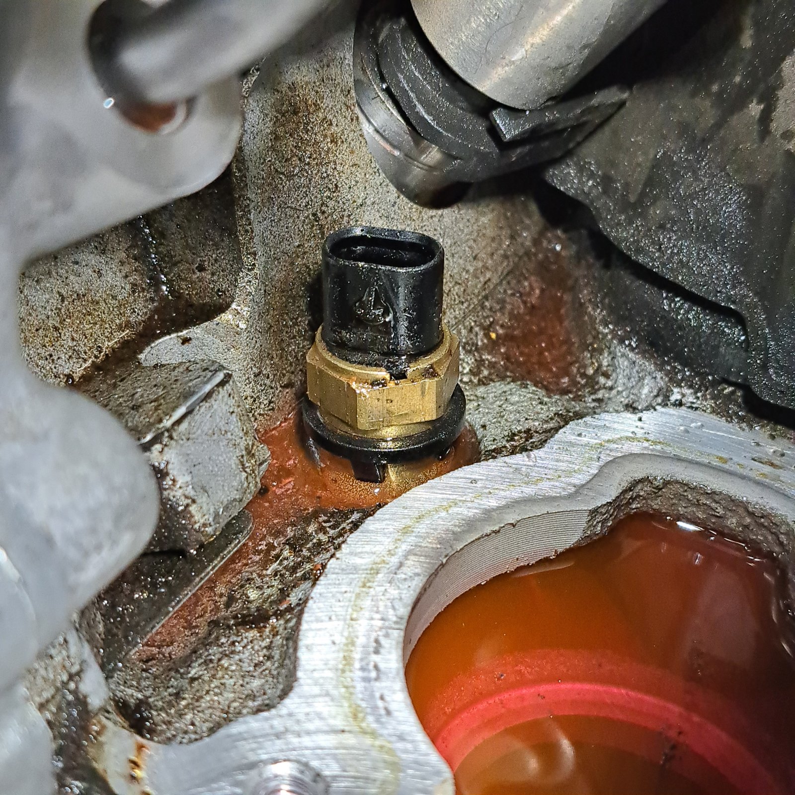

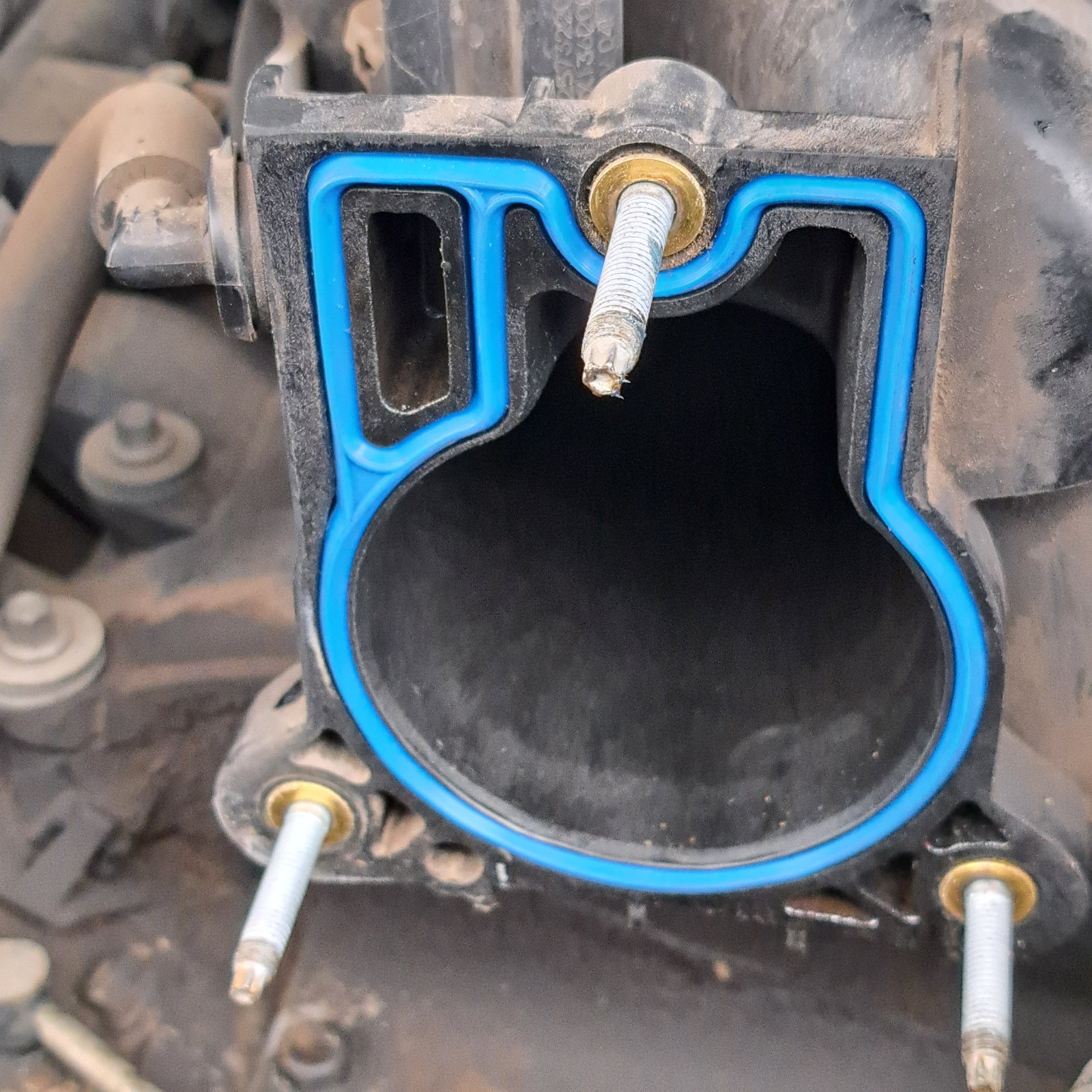

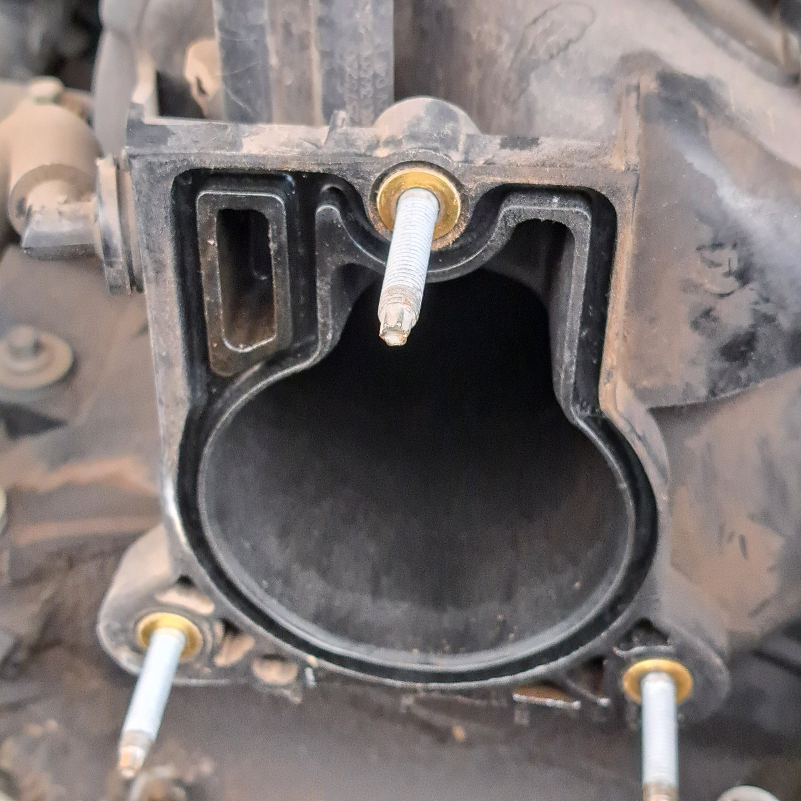

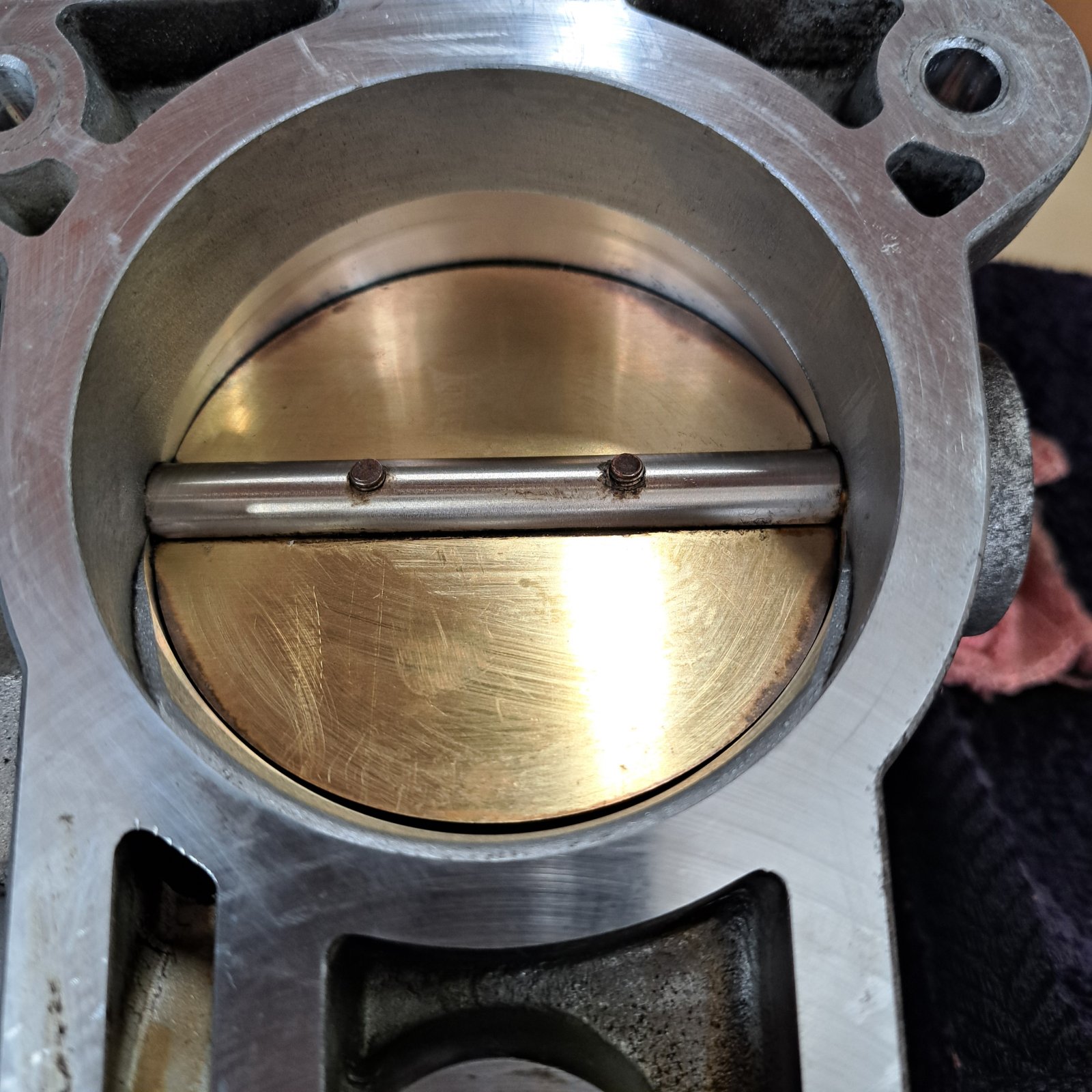

First day turning wrenches in the shop in Junction City, Or. The 2006 F150 4x4 5.4 engine is being replaced and the transmission rebuilt with a new torque converter. I started at 10 am and stopped at 1 pm. Bagged and tagged the fasteners as I tore down and will be doing a cleanup on components that will be reused. Look at the flapper plates for the intake. I shot pics of all 4 on d/s and the other 4 looked the same. We are getting a new intake and actuator for the plates. This is getting many new parts as we go: Throttle body, radiator, fan blade and clutch, injectors, plugs, ignition coils are less than 6 months old-I installed them a while back for a misfire code, all mounts, belt, tensioner, idler, water pump, new reman FORD engine, oxygen sensors, a/c condenser, trans cooler, knock sensors, cam and crank sensors, receiver drier, hoses, accumulator, flushed a/c system, new transmission cooler lines, temp sender and sensor, MAF, purge valve, fuel filter, fuel pressure sensor and I am sure I have forgotten some things....Plus, he did some training with me on the shop management program and writing tickets the way they want and working on entering info in computer and finalizing tickets and billing out. Seems like will work great but I am just playing it by ear for now.

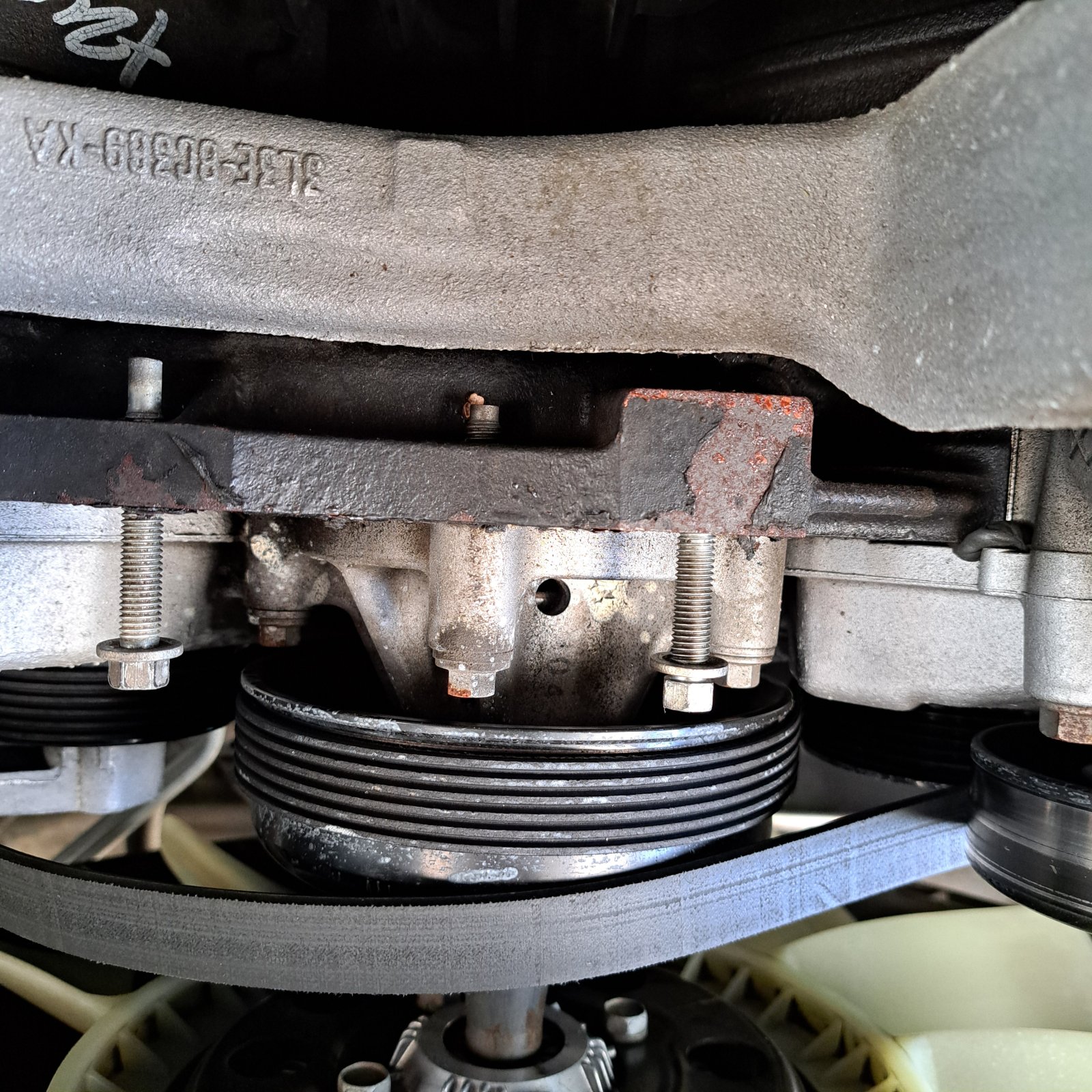

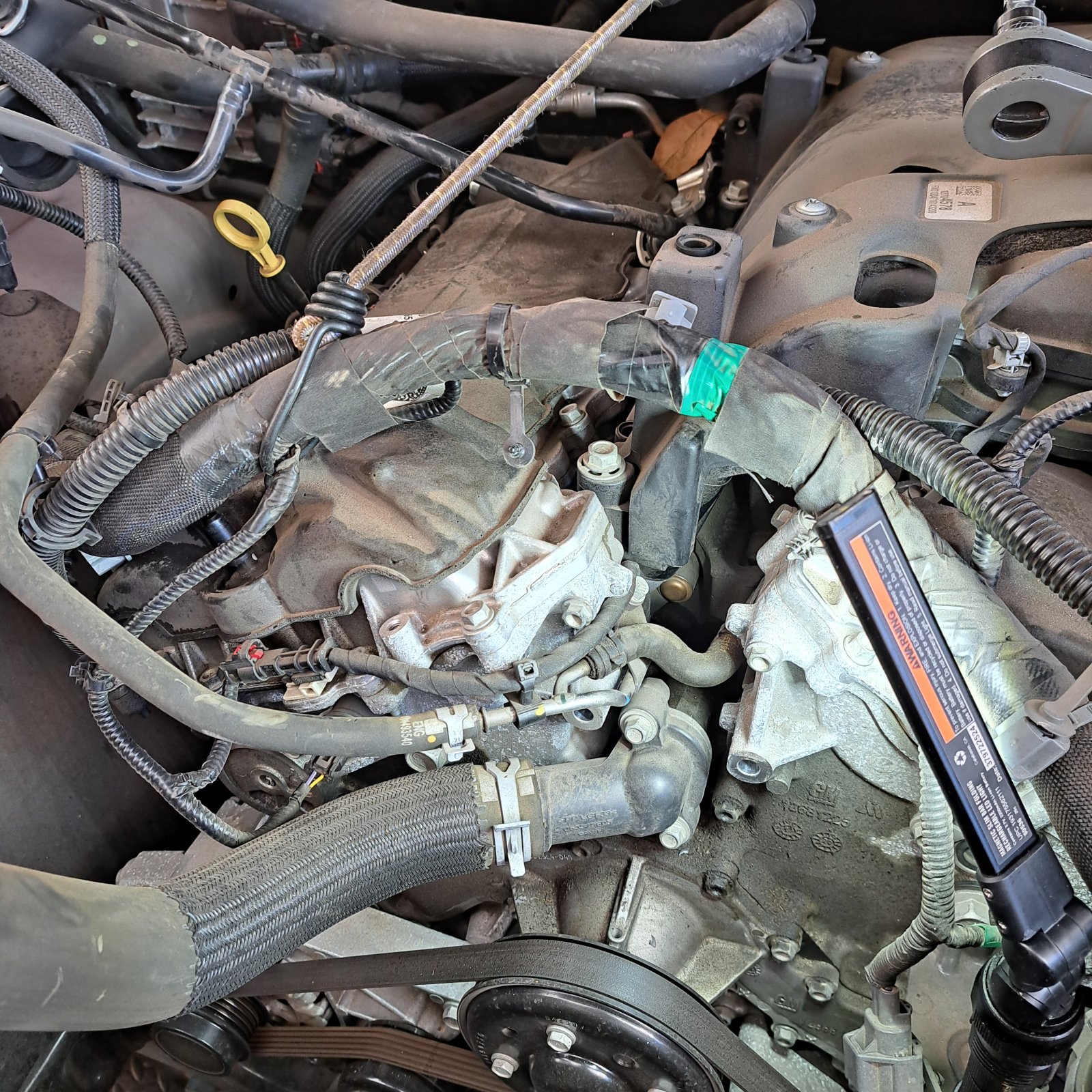

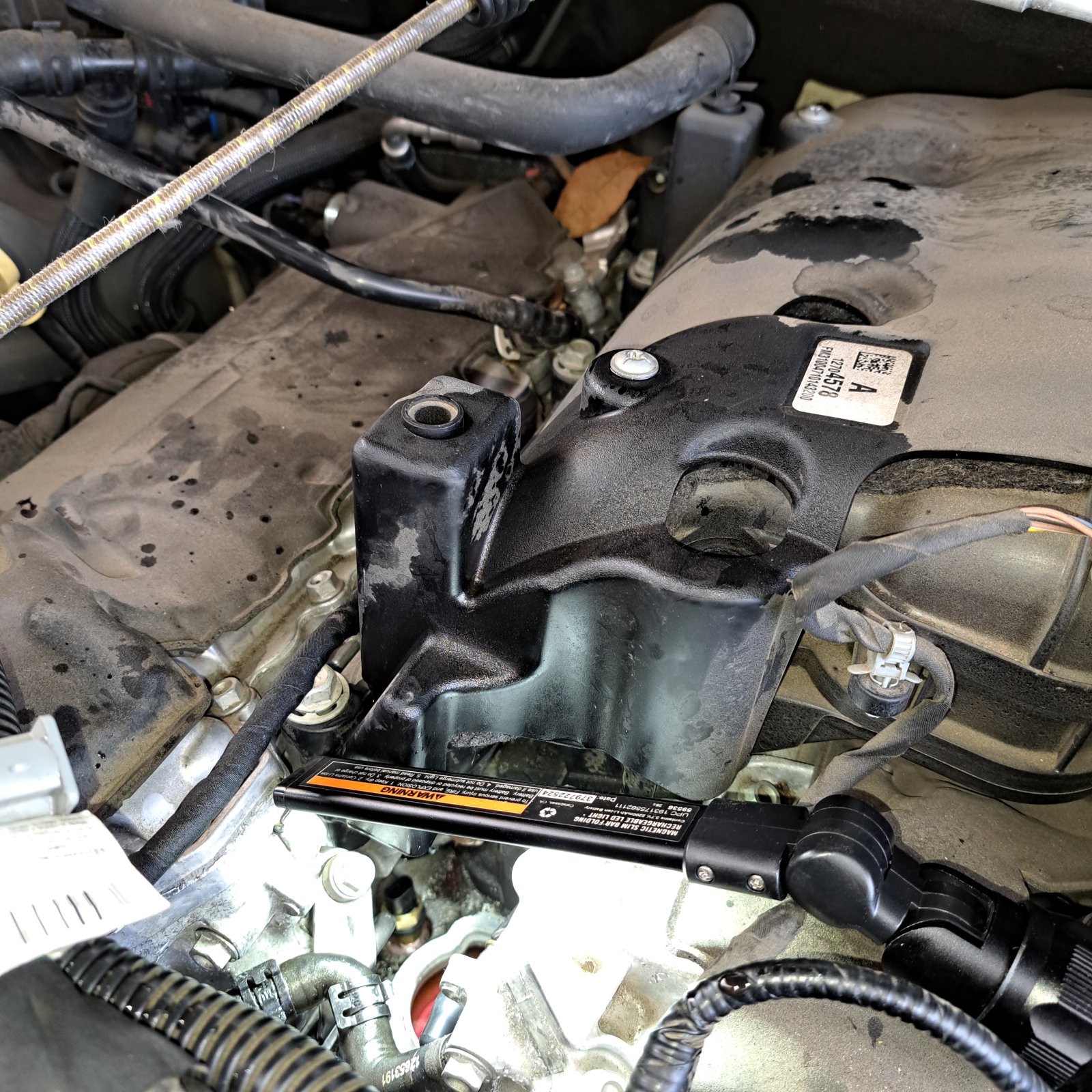

Back to work on the 2006 F150 engine and transmission swap today. Worked from 9:30 to 2:30. Removed: ignition coils, tensioner, thermostat housing/crossover housing, wiper arms and upper cowling, engine bay engine power control module and bracket, radiator, both heater hoses from the heater core tubes, finished removing harness connections for engine and a/c compressor, drained a/c system, had to hand wrench 6 mounting bolts for the a/c compressor and p/s pump-no room, rear ground strap and coolant tube mount stud at back of engine, hood coming off tomorrow and unhooking the motor mounts, pulling new engine out of Ford engine crate pod and mounting on engine stand and setting the old engine in the pod after exhaust manifold removal. Then parts swap and new parts installed that can be done ahead of time. Will clean out engine bay and prep for new engine install. Sorry, no pics today of all this but will get them in the morning when I get there.

Ok, the 2006 F150 is completely ready to have the engine jerked out. motor mounts undone, harnesses bungy corded back out of the way, flexplate off, oil dipstick pulled out, a/c accumulator removed and compressor is completely out, the condenser is out but I have no pic of that, battery and tray removed and then we discovered that the engine picker does not have a long enough arm to get the new engine out of the shipping pod so we can mount to the engine stand. Gy in a business next door has a fork lift but was not there. Some day next week, will get new engine out and mounted to engine stand and pull old engine and drop in the engine pod for core return. I will swap the exhaust manifolds over and whatever other parts I can install on the stand and then the fork lift will be back to drop the new engine in. I cut my middle knuckle on my left hand first thing this morning.
