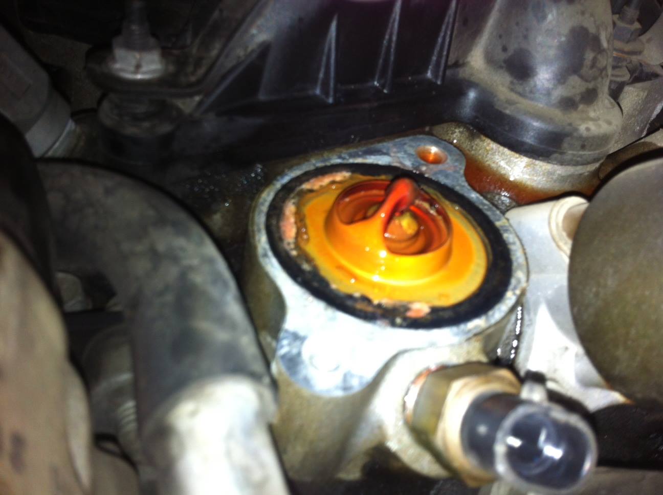

I've been sending my mechanically inclined Dad pics of some of the work I've done over the last couple years so i have a bit of a record.

Orange coolant (Dexkill?) gunk on, likely original, thermostat
Old and new coolant temp and gauge temp sensors and thermostat showing coolant residue

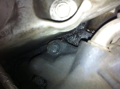

To go with the oil cooler lines there's also the adapter at the oil filter where the cooler lines connect to that leaks.
