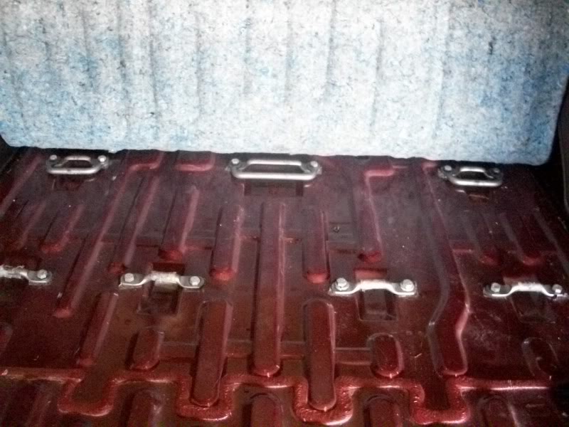

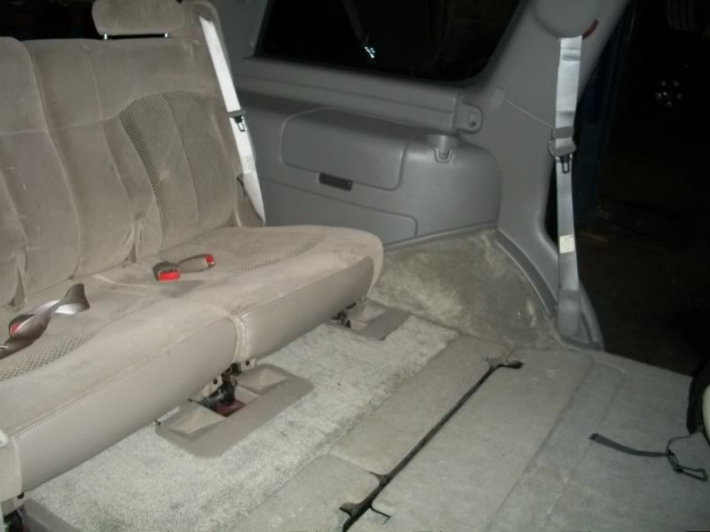

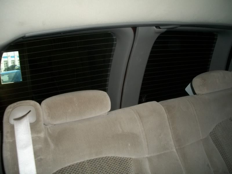

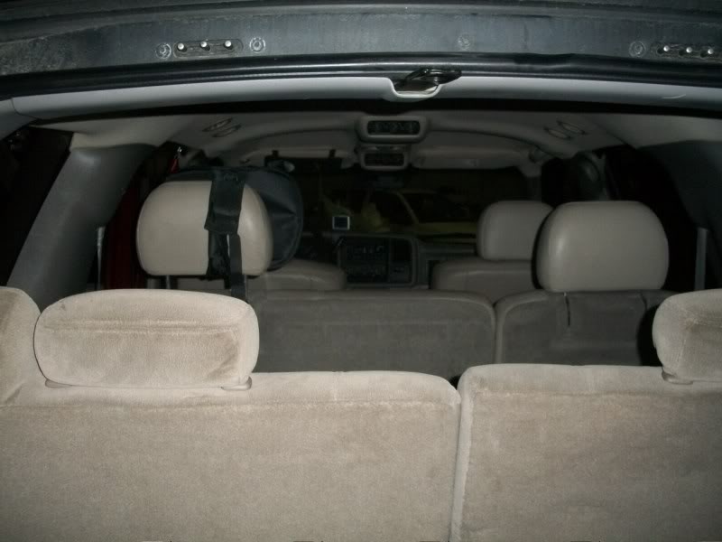

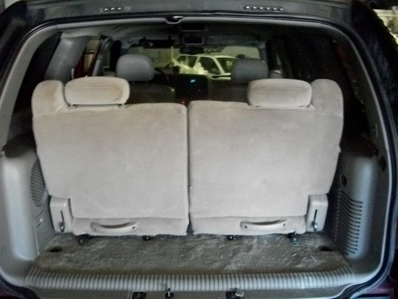

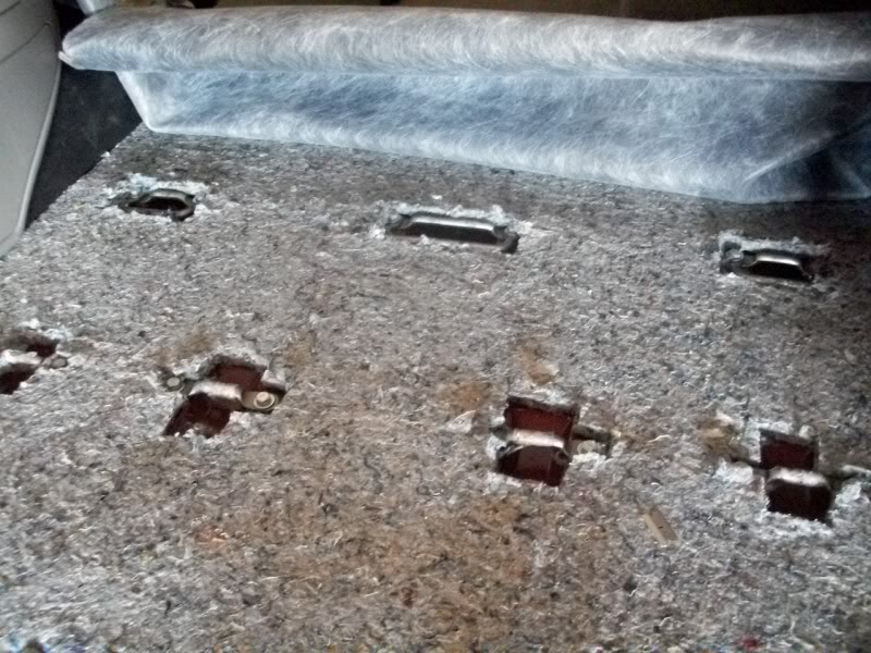

I have a 2001 Tahoe with the barn doors and everywhere I looked (searched here couldnt find anything) said that retrofitting third row was IMPOSSIBLE. Not sure how true that is because I wrapped it up this morning. I scored a set of rear seats (tan, no leather, but free) and all the brackets. I just had to buy bolts. The holes were in the floor. Turned out great until I cut the carpet in the wrong spot and installed the trim backwards :emotions122: oh well you wont see it when the seats are out cause of the cargo mat. Enough talking, here are the pics

One thing I noticed was that the 02 bolts were larger than the 01, trip to the Depot and I was in business :rocking:
