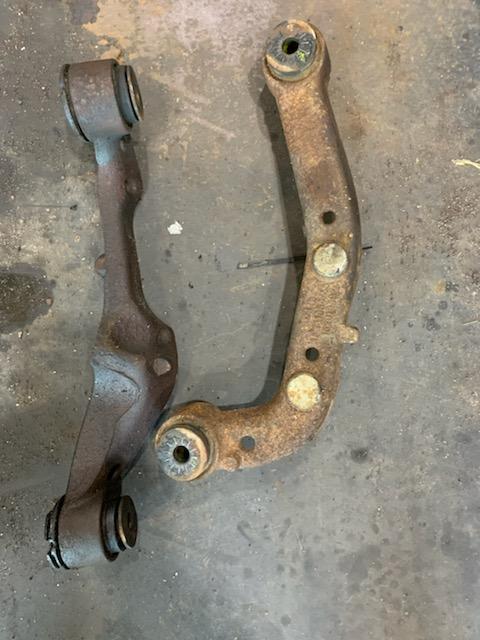

I had the same clunk, and first I replaced the slip yoke with a nickel plated one, but the clunk was still there. Then, I replaced the front differential mounts, and bushings, and the clunk went away.
