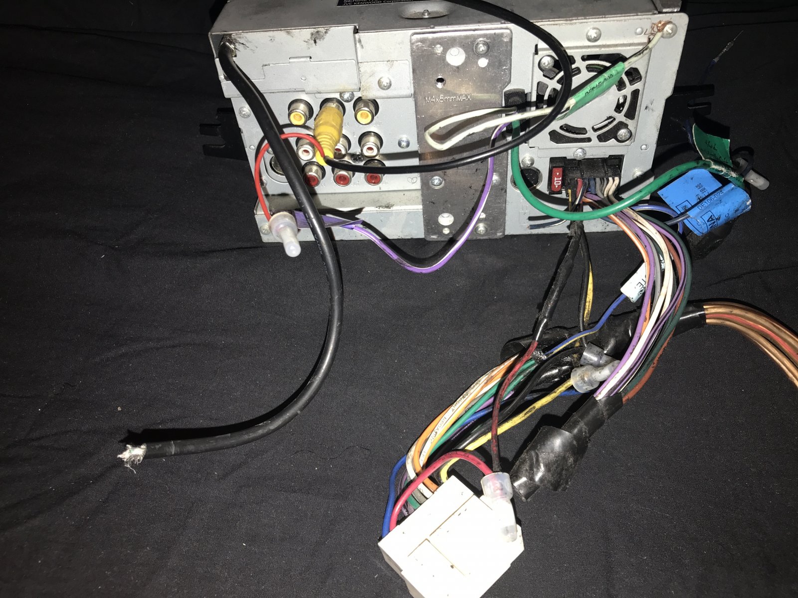

Can an aftermarket head units main power wire be fixed after it was cut. The dude stopped and left the radio on the curb when I came down the block. It’s a JVC double din

usually you just replace the harness but I would imagine it could be soldered just as well as long as there is enough of it remaining
pictures might be helpful

I thought I did. It’s there now

that big black wire is not a power wire it is the antenna wire, the best option for that is to just strip it back some on both ends and patch it back together, replacing the whole thing from the front is a real pain

Thanks
