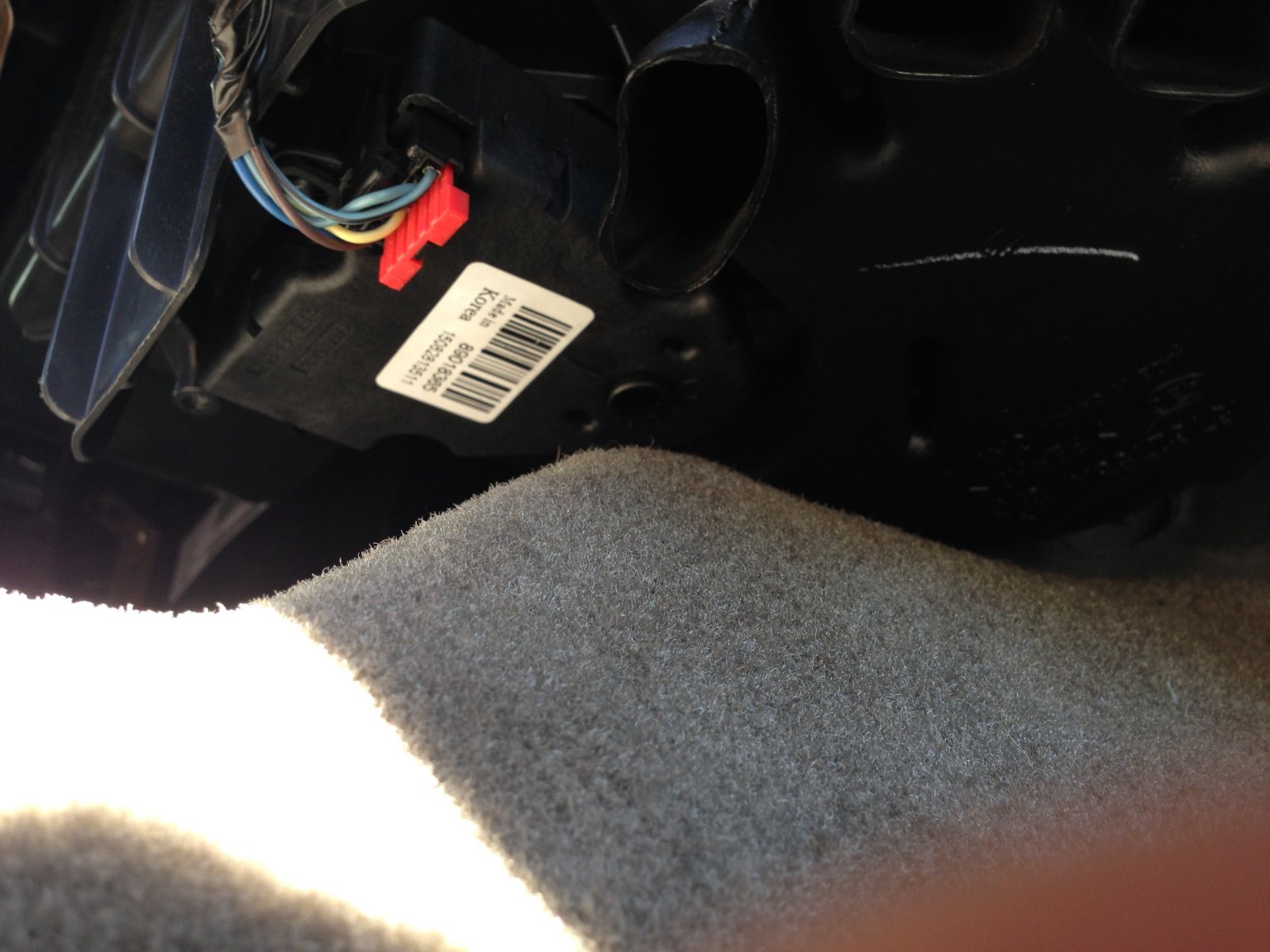

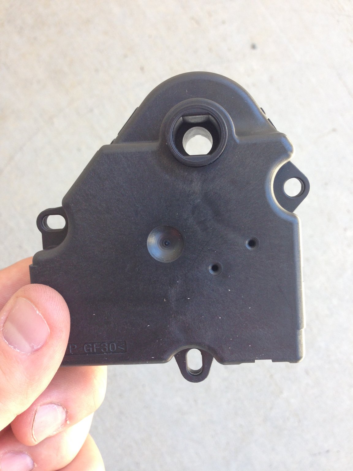

This is what the part looks like:

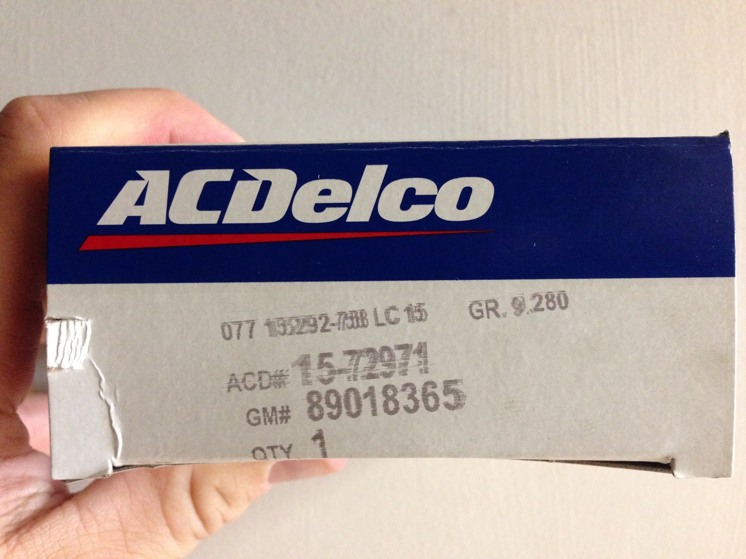

Here is the part box and part number. keep in mind I have a 2005 Tahoe LS 4.8 with manual ac controls not the digital readout. You might require a different part number based on your specific Tahoe.

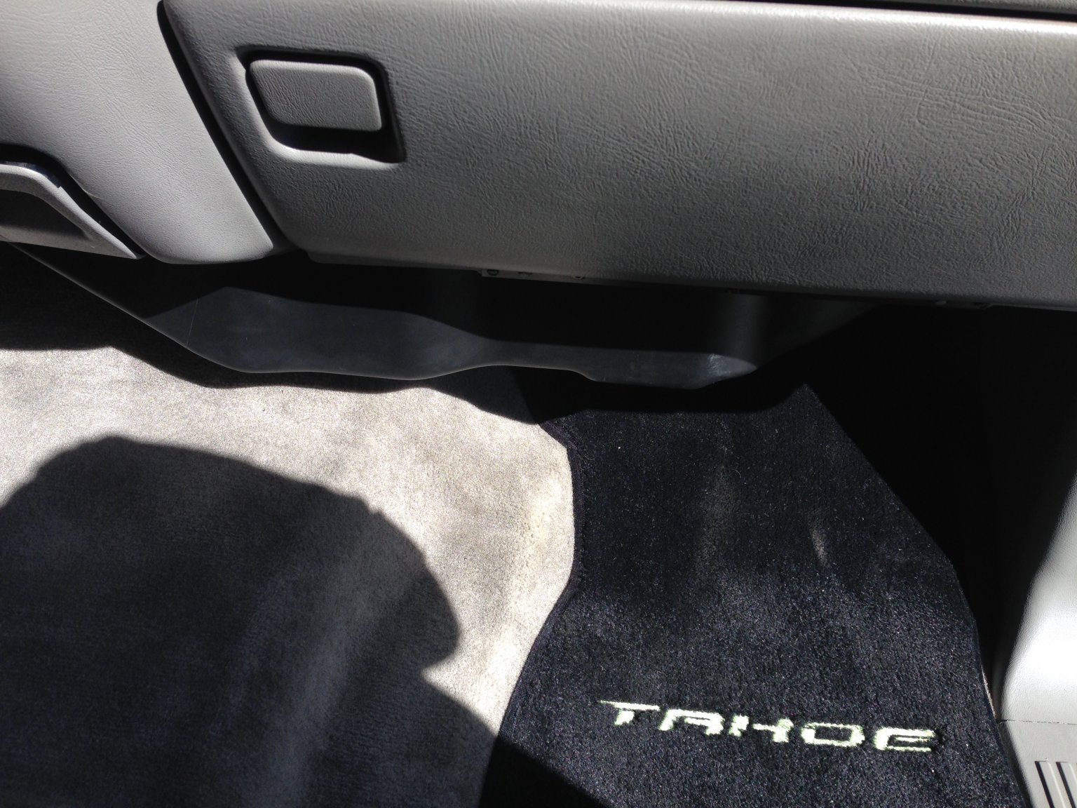

You have to remove this black cover under the dash. There are 4 screws underneath then it just pulls free from the foot vents.

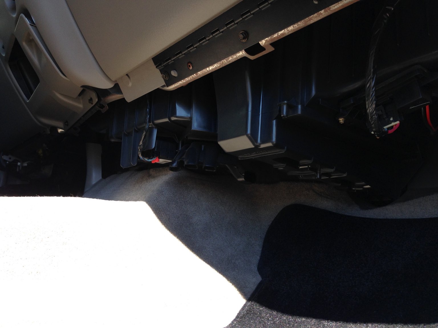

Once the black plastic cover is removed it will look like this:
You can see the actuator hanging down in the middle of the photo close to the tunnel. Here is another close up photo of it.
All you have to do to replace it is unplug the red wire harness and remove two screws that hold it in. Then pull down and it will come out. There is a guide pin that must be lined up as well as making sure the D shaped slot lines up with the blend door (see photo above with the part and you will see what I am talking about) when you install the new replacement part. You can twist the blend door part it lines up with on the truck NOT on the actuator. In all honesty the most difficult part was putting the screw back on the black cover above the tunnel. There is not much room to get in there and you cant see it at all must be done by feel.
