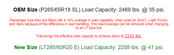

I originally had stock p265/65R18. So I went up in wheels and tires.
Here is the response I received from Continental
With the stock tires I would also air down to 18psi to drive on the beach. Any recommendations for a new psi to air down to now.
Thats the same process i've used for going from P to LT. I dont know why more shops don't train their techs to use the load vs inflation tables... its really not that hard.
You have about the same sidewall height and an inch more tread width to start, so ~20 psi should still be good for the beach. Can try 25 and see if you still need to go lower.
