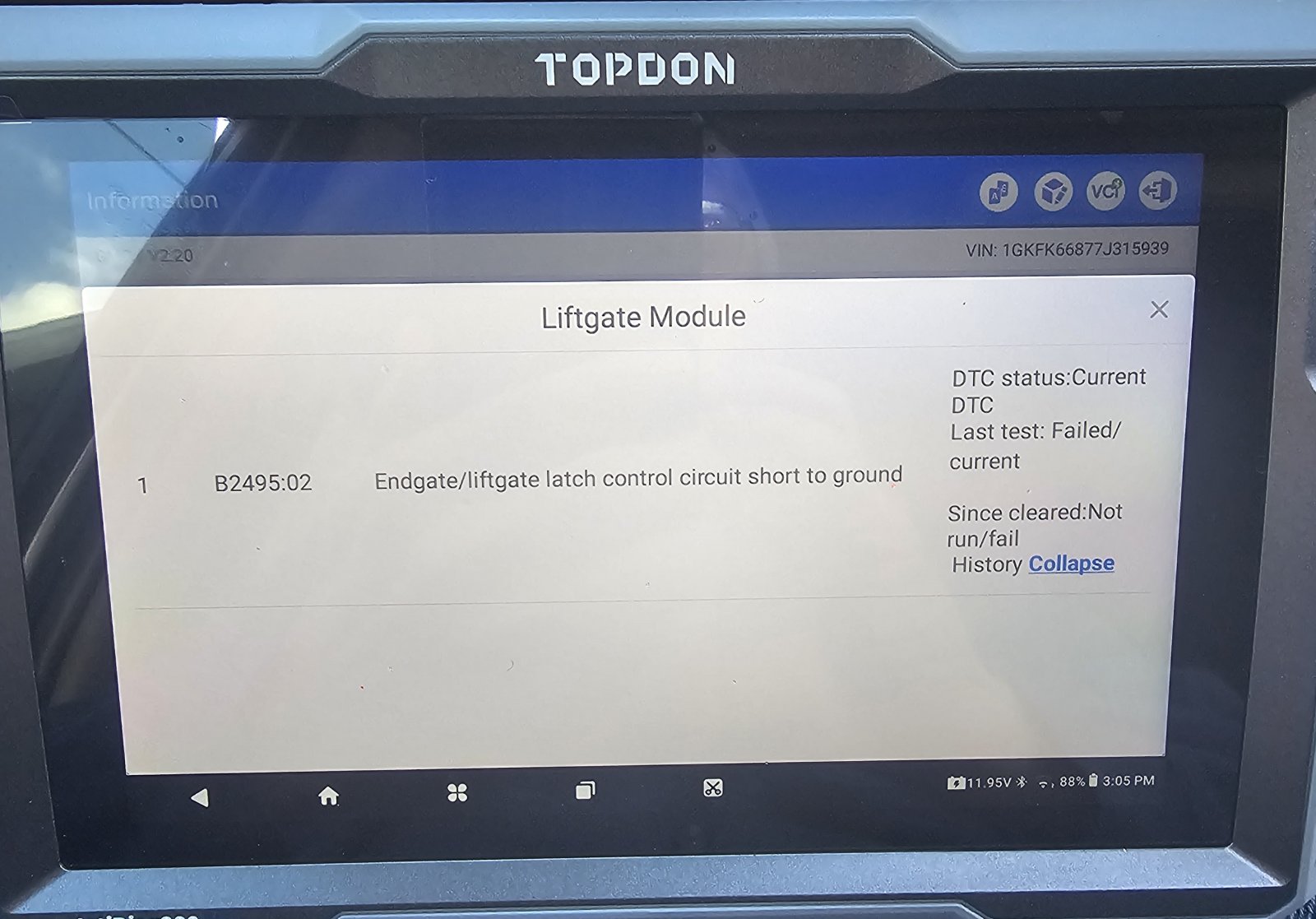

23 systems were scanned. 9 were detected with DTC's for a total of 21 DTC's
Most are history codes that I assume happened when I bought it and the battery was almost totally dead related to loosing communication with BCM.
3 codes are hard faults. Lumbar support, Lift gate module and the other I don't remember but was minor also.

The scanner told me my Lift gate module has a short to ground. Maybe it is, maybe not. I'll need to test it on the bench, I think.

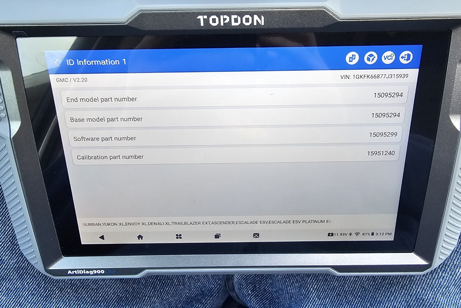

It can diagnose Active suspension and test it.
It has the ability to activate all shocks individually for testing. It has and can graph all 4 shocks together or singly for live data.
