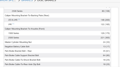

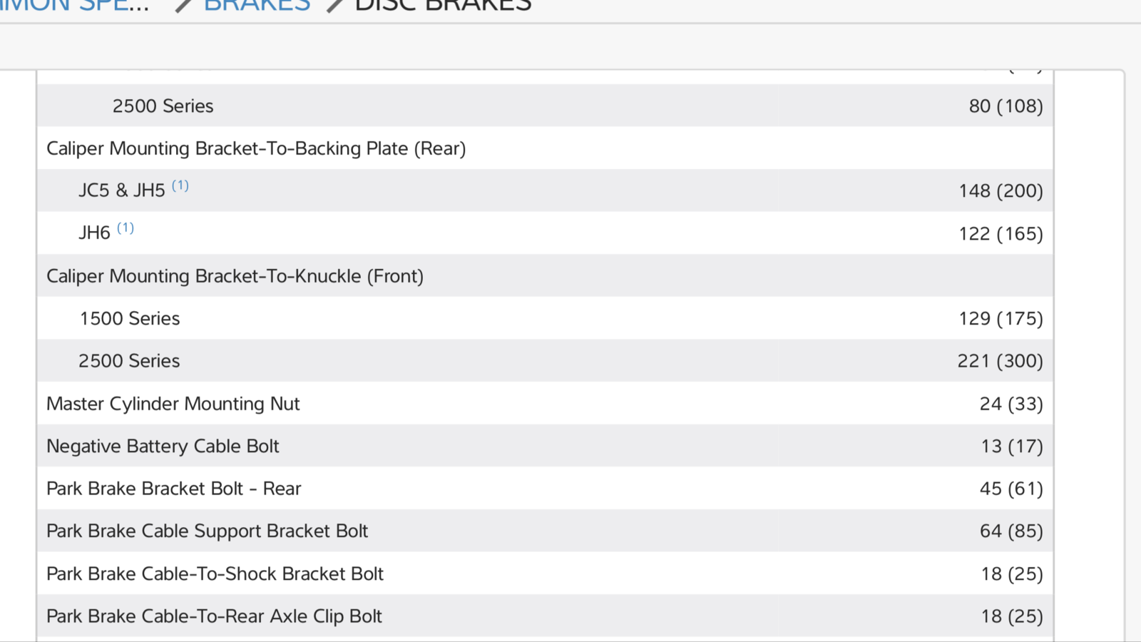

Hi All, The chilton book says the torque speck for the rear brake bracket to hub is 148ft lbs. And break bracket to front knuckle is 129ft lbs. 2003 Chevy tahoe 1500 4x4.
That seems like too much. Can anyone confirm this? Thanks Kelly
