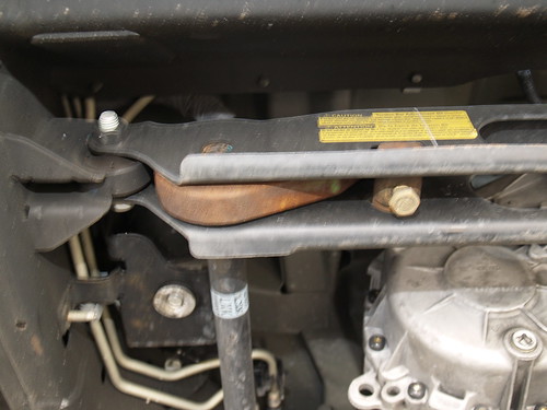

The916
see what the bolt is going into on this picture?
that is the spacer that stops the torsion key from just unloading once you take that bolt out
"completely cranked out" would be resting on that spacer meaning the bolt would serve no purpose

The916
thats not my picture its from the 2/3 eibach write up
