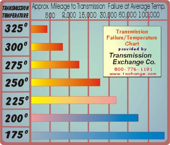

SmallXL
May 20, 2010
104
take it for whatever you feel this is worth (everyone has their own opinions)
