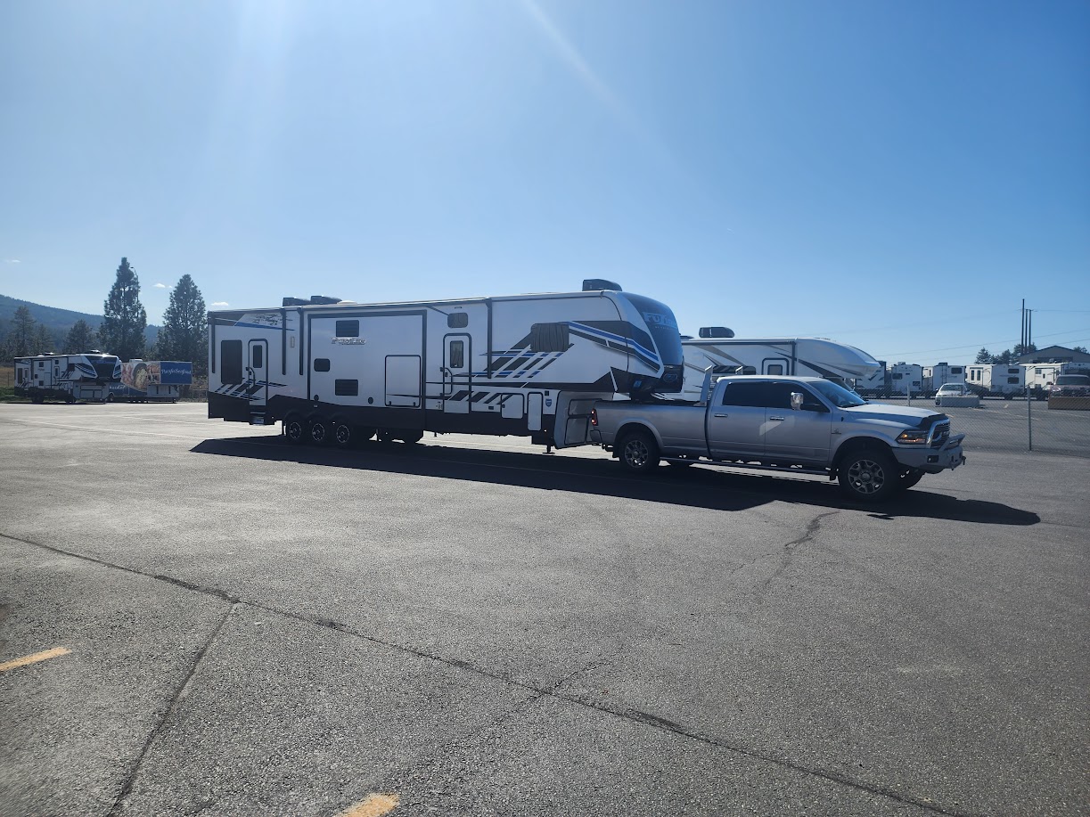

Can’t wait to go gamping with my 2024 Dodge 3500 Diesel pulls 38,000 lbs.
IDK if that picture is taken in wide view or not, but that looks like a heck of a trailer to stick with tandem axles. The trips on mine might not be ideal for tight turns but with the weight i'm glad the trips are under her.
