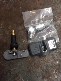

the "new style" from teh 2015 wheels TPMS sensor on left, 2005 style (Dorman 974-007 replacements) on right. they work great so far, hopefully they will last another 10 years. ac delco were like $10 more each, and didn't come with the nut or whatever thats like another $5 each. anyway, the styles interchange fine, no problems whatsoever. again, the tire guy insisted this wouldn't work.
