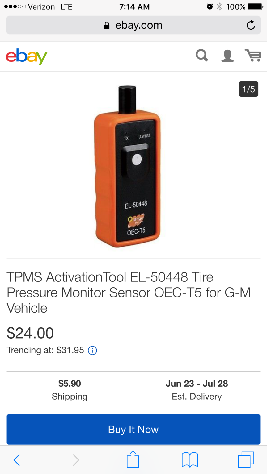

Pretty sure there is no batteries inside the sensors. They work off a frequency. They are electronic so they can last as long as the truck or can last a few days, no real life expectancy on them. You will get difference answers from different sources. I just bought the programmer myself makes everything easier than airing up and then letting out air. Check amazon, ebay, summit, jegs for the programmer. Well worth it in my opinion even if you're not a mechanic and use it often. Never know maybe your friends will be able to use it some as well.
