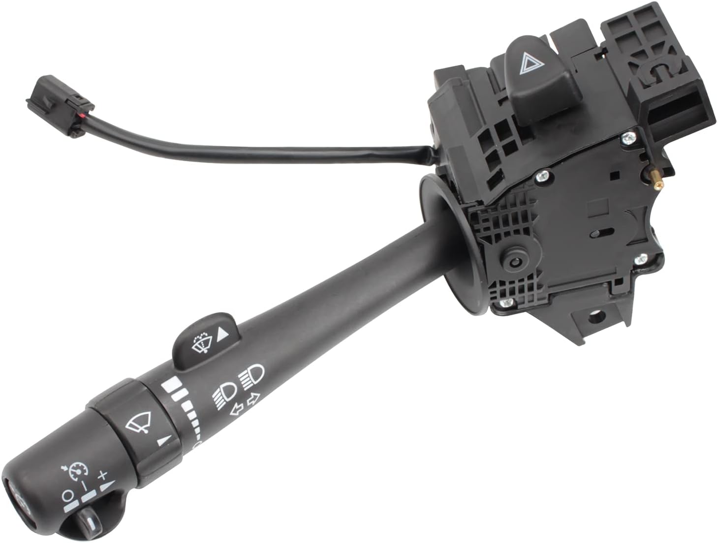

Everything on my Yukon works. And only the brake lights on the trailer don't work. All else does. Tested two different trailers, same results. I was told this could possibly have something to do with it? I replaced the OEM on last September with one from Amazon but all trailer lights worked till just recently.
