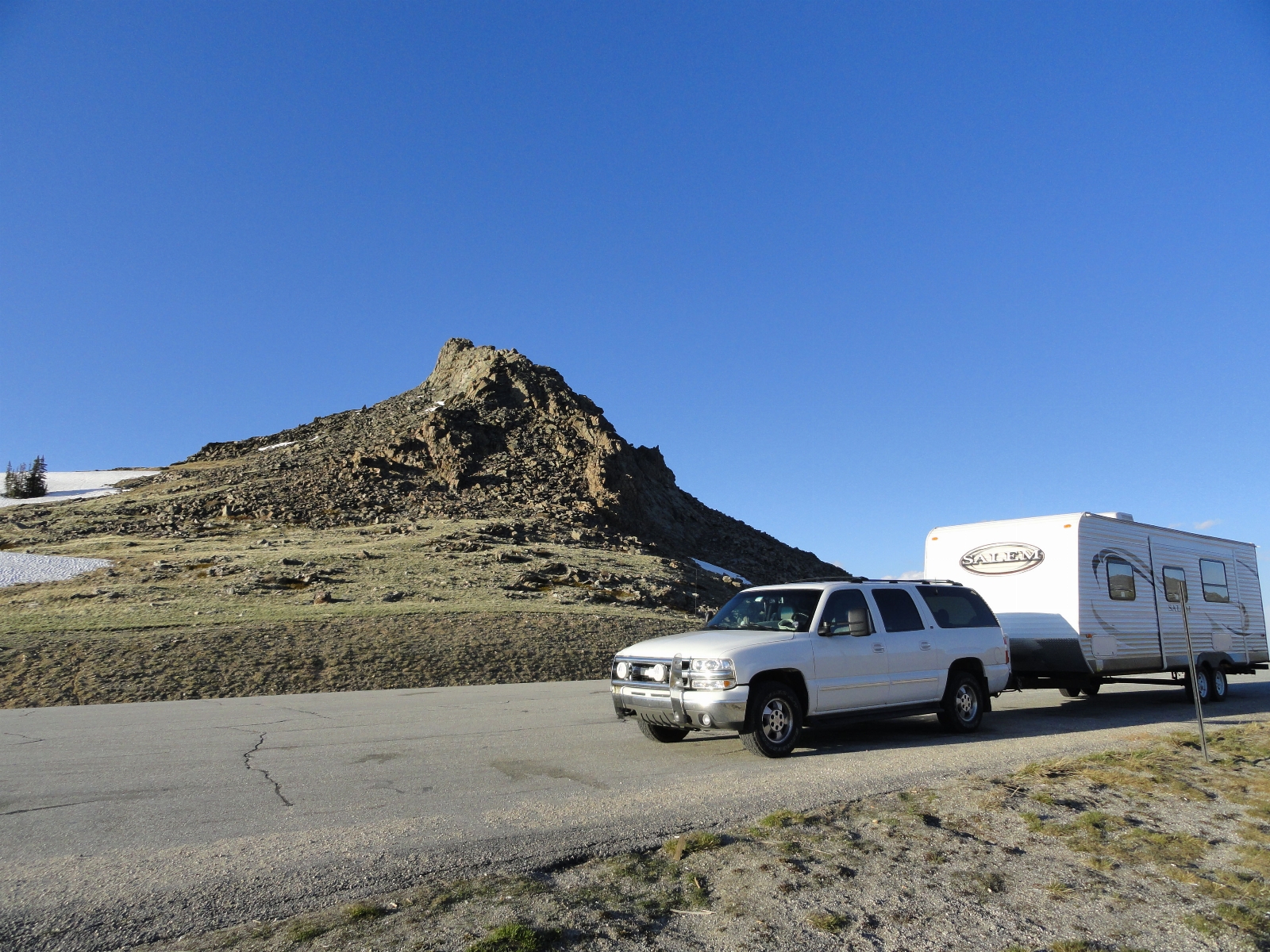

Just do a search 4L80E towing transmission, Summit racing has a well defined build inventory to inform you of what is replaced/improved. I am not part of the HP driveshaft twister club, But when i pull the grade from bishop to mammoth the first 23 miles are tough, our travel trailer weighs approx 5k loaded and everything in the driveline is put to the test. It is a paradox to replace the trans as preventive maint or wait for the big bang and potentially ruin a vacation. o8 yukon denali xl1500.
