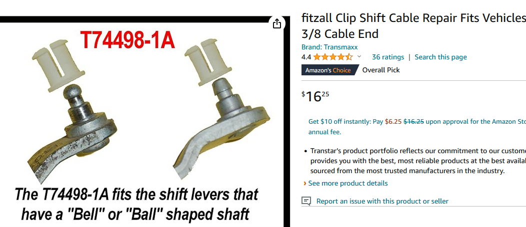

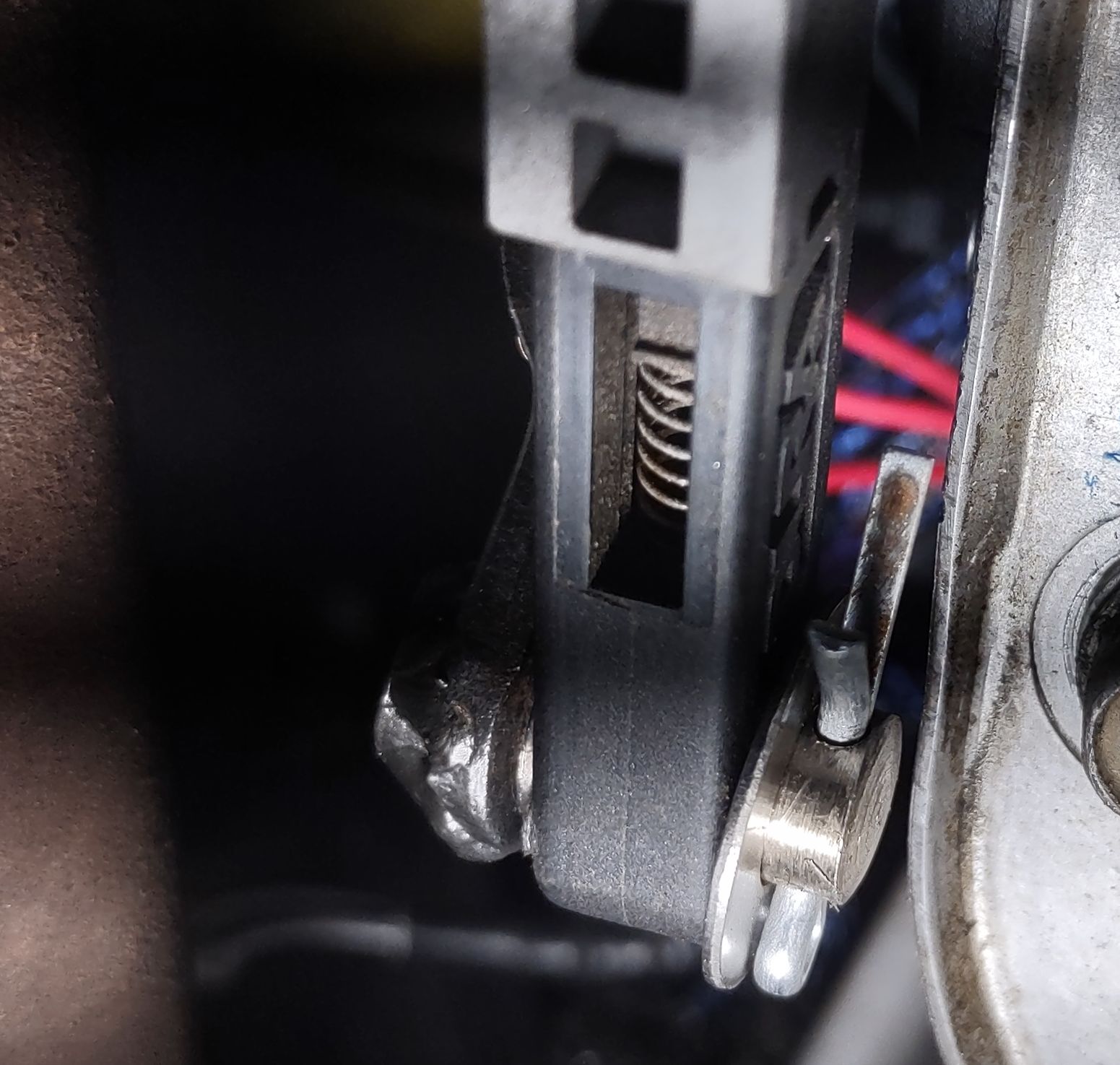

FITZALL T74498-1A $30 shipped in CA but ya it works been on there for a while now, I had already drilled it and put a cotter pin and washer so now it has both
THE DORMAN ONE SHOULD WORK AS WELL

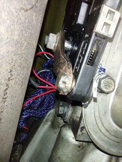

The cable end on my 6L80 had been re-repaired at least 3x. The inexpensive bushing fix wasn’t an option.
Our Indi used the same half cable you mentioned. Paid about the same price as you because, locally, nobody else had it. Works great, no need to pull the forward section out that’s not broken and a PITA to fish through.
Anyone out there ever just do the bottom lower shift cable and has worked for them?

How did you remove the plastic piece on the new linkage and installed it on the old one?
I warmed it up just a little with a heat gun, pulled it out and slid it in the old one. Literally took 2 minutes. Didn’t even jack the truck up.

Just did this on a 2013. Dorman part for $12. Just scooted under there and installed it. You have to make sure to get the part to snap in fully when inserting it into the cable and also when putting it back on the lever. If it pops off you didn't install it correctly. Didn't have to jack it up either. Maybe 5 minutes to do as I had to struggle a little to get it to clip in properly. When it did you know it as it made a distinct click when inserted properly.

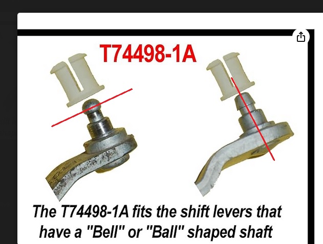

Fitzall, washer, cotter pin it's been like 3 years already
Yep, thanks! I did see the Fitzall #T74498-1A. Not sure if that is the one you used.
It looked the most promising of the bunch, but unfortunately it's not getting here until the 10th or so.
So you have to drill out the nipple on the shift lever?
