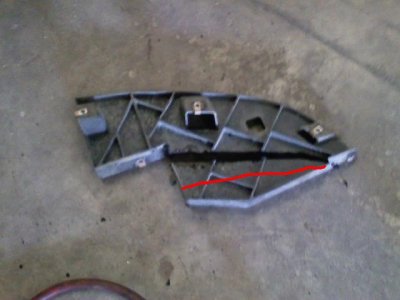

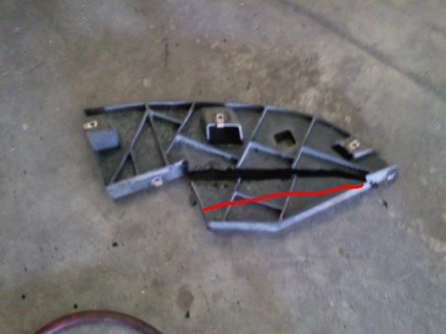

Got a few requests to show the trimming of the front Z71 valence caps needed to fit 285/65/18 on stock wheels with 2.5" front level kit. The picture was from someone else fitting wider tires and the red line was where i trimmed ~2 inches.

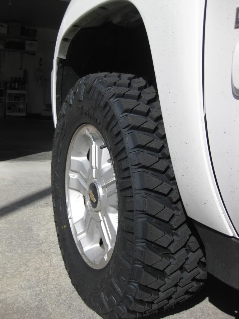

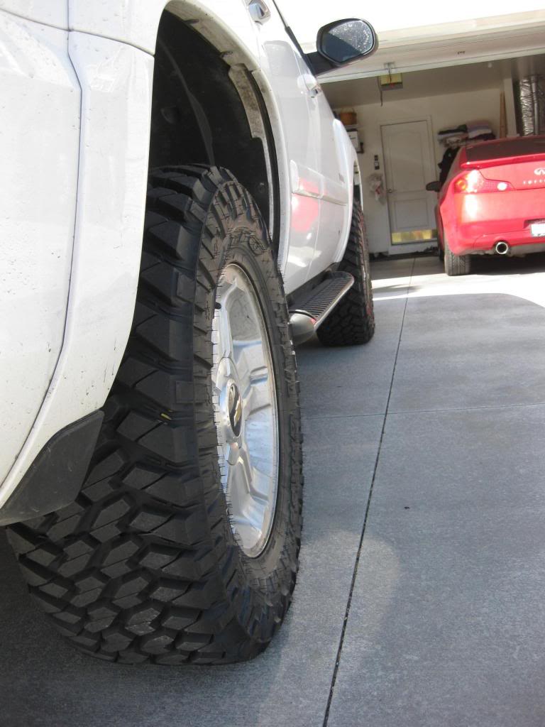

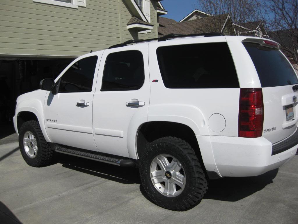

Pics from the post install.

thanks for the pics, how is the clearance at the rear of the front wheel well ?
if or when you get back by it, do you know the overall height at the tallest point of the roof rack....I visited a parking garage that was 6'-5" ....I do like the width of the tire, but I am going with an AT.

Clearance is good at the rear of the front wheel well. No trimming or modification required there. Some trucks may vary though and adjusting the caster should help if you have an issue.
I limit parking garages to at least 6'10" which is the opening of my garage. I can fit into 6'8" but it is pretty tight and those signs are not that accurate so I like to have a little wiggle room. I also have the roof cross bars.

You shouldn't have a problem fitting through 6'10" openings.

I am planning to do the same thing to my tahoe soon. Was the trimming all plastic, or did you have to trim metal too?

I had to trim plastic, plus alot of metal in front wheel wells. Rear only some of that plastic liner, but my tires were 325s.
