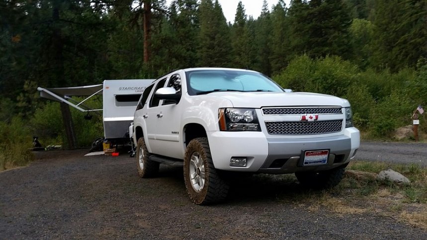

Got a few requests to show the trimming of the front Z71 valence caps needed to fit 285/65/18 on stock wheels with 2.5" front level kit. The picture was from someone else fitting wider tires and the red line was where i trimmed ~2 inches.
Pics from the post install.
Hope this helps.

They are Nitto Trail Grapplers and have about 40k miles on them. Could probably get another 5k, but will assess how they do this winter. I would buy them again, but this is now my wife's rig. Next set of tires might be Nitto Terras or Goodyear Duratracks. Trying to get better mpgs...
FYI originally put them on when they came out in 2009 (I think), and this recent thread was responding to *** regarding trimming.
