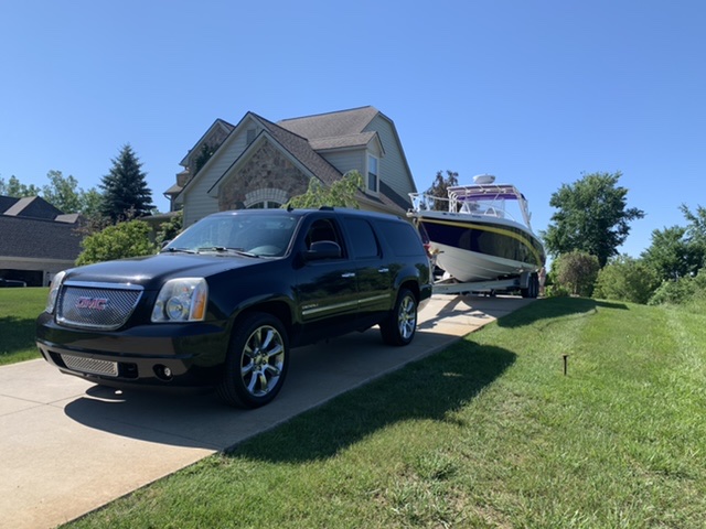

My current rig, parked at Wall Drug:

that transmission is not going to last very long at 241F.. you should get some upgraded cooling for it or at lest turn on the heater full blast with the windows open
Well, 202k miles, still the original transmission, in fact the entire power train is original, I guess I'm just lucky., right? Should probably go out and buy some powerball tickets because my transmission didn't blow up near the Eisenhower Tunnel or Powder River Pass. :crazy:
And actually, when that picture was taken, we had the A/C blasting because, even at that high of an altitude, it was still hot outside. :cool:
Or maybe, just maybe, along with good/frequent PM, the engineers at General Motors actually built the cooling system to do what it's supposed to do? :wtf:
Nah, all the shade tree mechanics on here know a lot better than the guys designing/building/validating these components. :manos:
