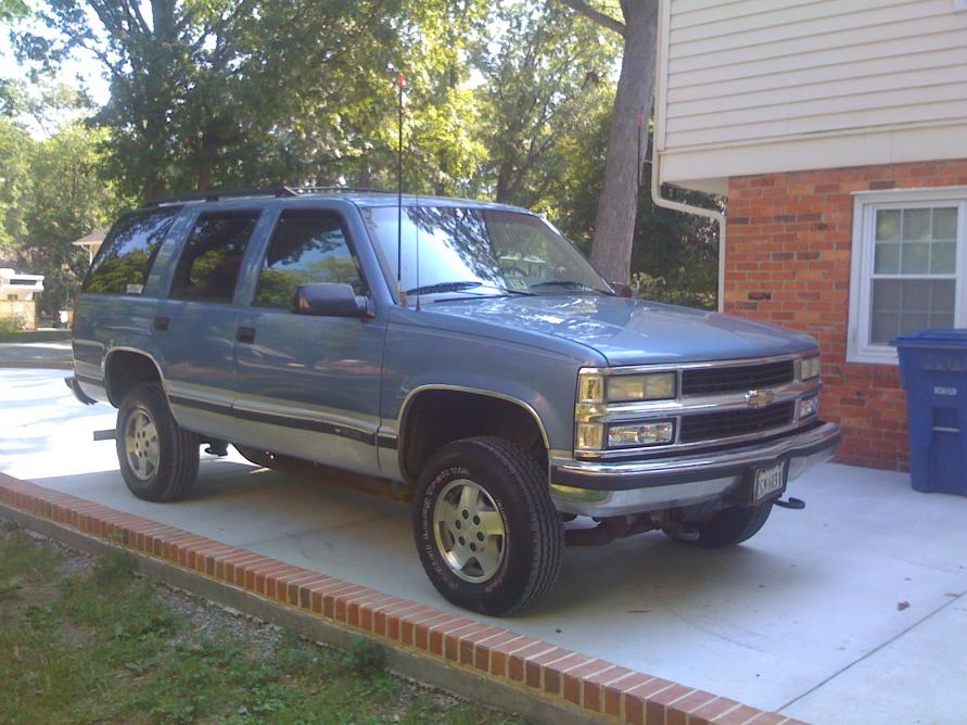

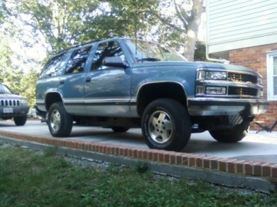

mines nothing special to look at but i like it alot more after painting...
first ones are before. u can see the rusty frame. the afters are kinda dark ill have to get better ones. but i painted the control arms too and leave springs and stuff out back as well. still need to make my gap guards...
