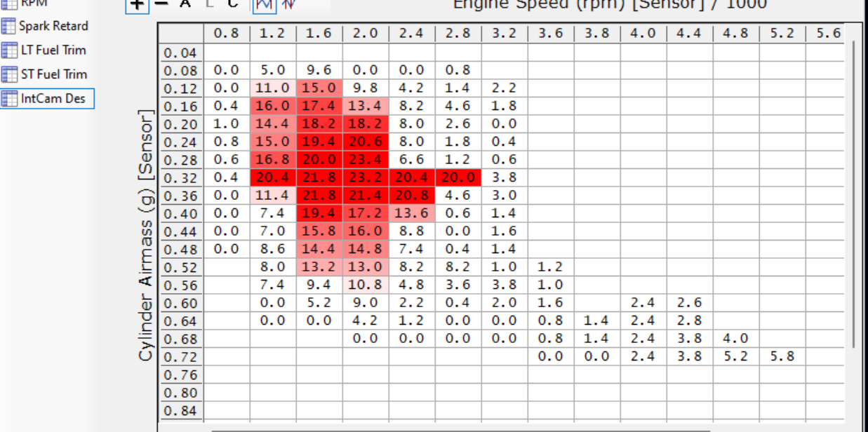

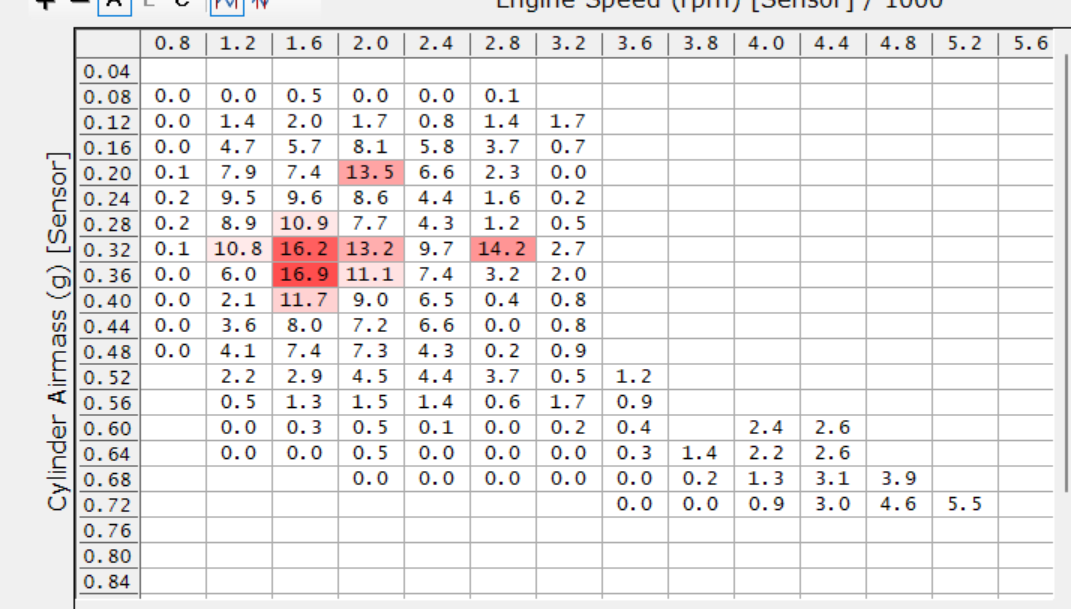

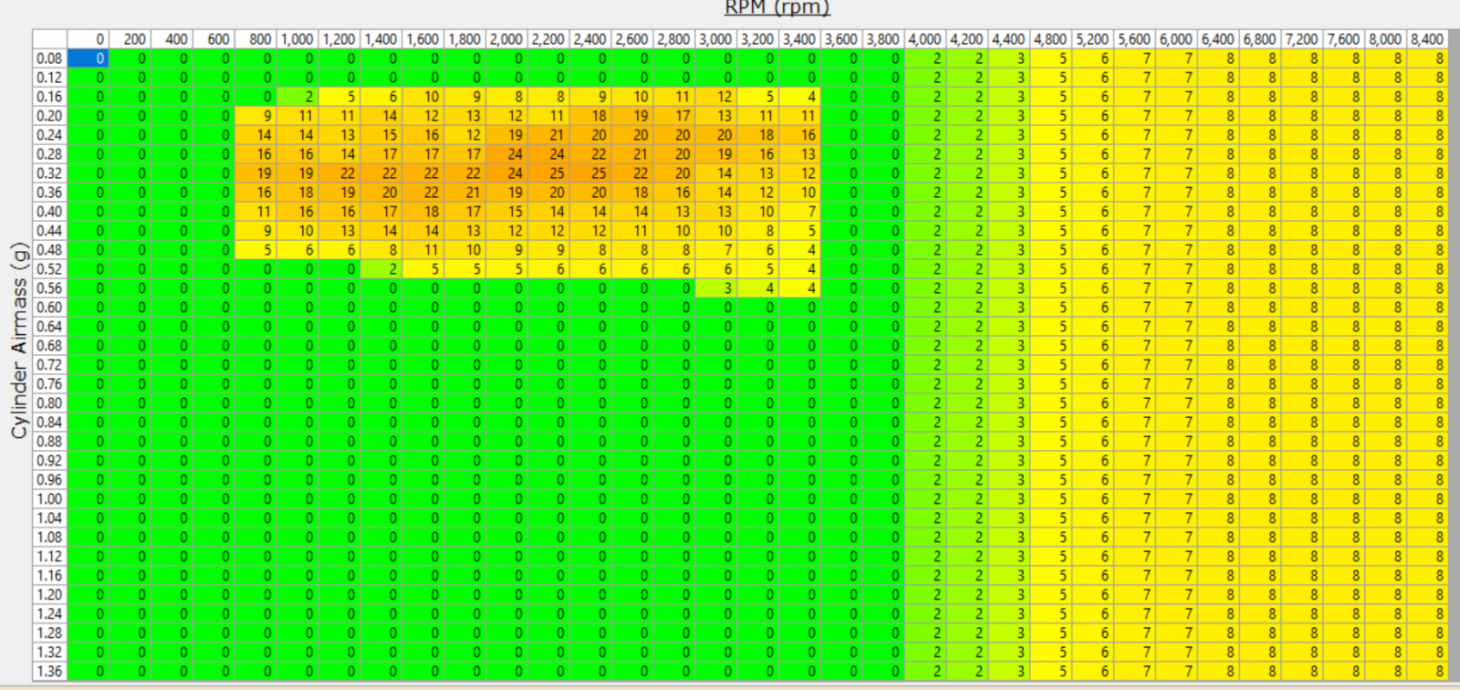

(718)-
'Burst knock' dampens throttle response. It is also indirectly responsible for a minor MpG improvement.
With signal throttle, the engine computer delays throttle movements and dampens how quickly the throttle moves.
GM programs VVT to improve MpGs, not to improve throttle response or power,
until after the throttle has BEEN ALLOWED past a certain percentage.
Under that TPS%, VVT is indeed also discouraging enthusiastic driving.
This is another one of those things that can be tuned to improve (or worsen) engine response.
Finally, GM also 'tunes' the 6L80, 8L90, & 10L80 to upshift as early as possible,
and to not downshift unless you've given it enough throttle - I mean
unless the ecm has allowed the throttle to (stay) open wide enough (long enough) to finally allow / command a downshift.
