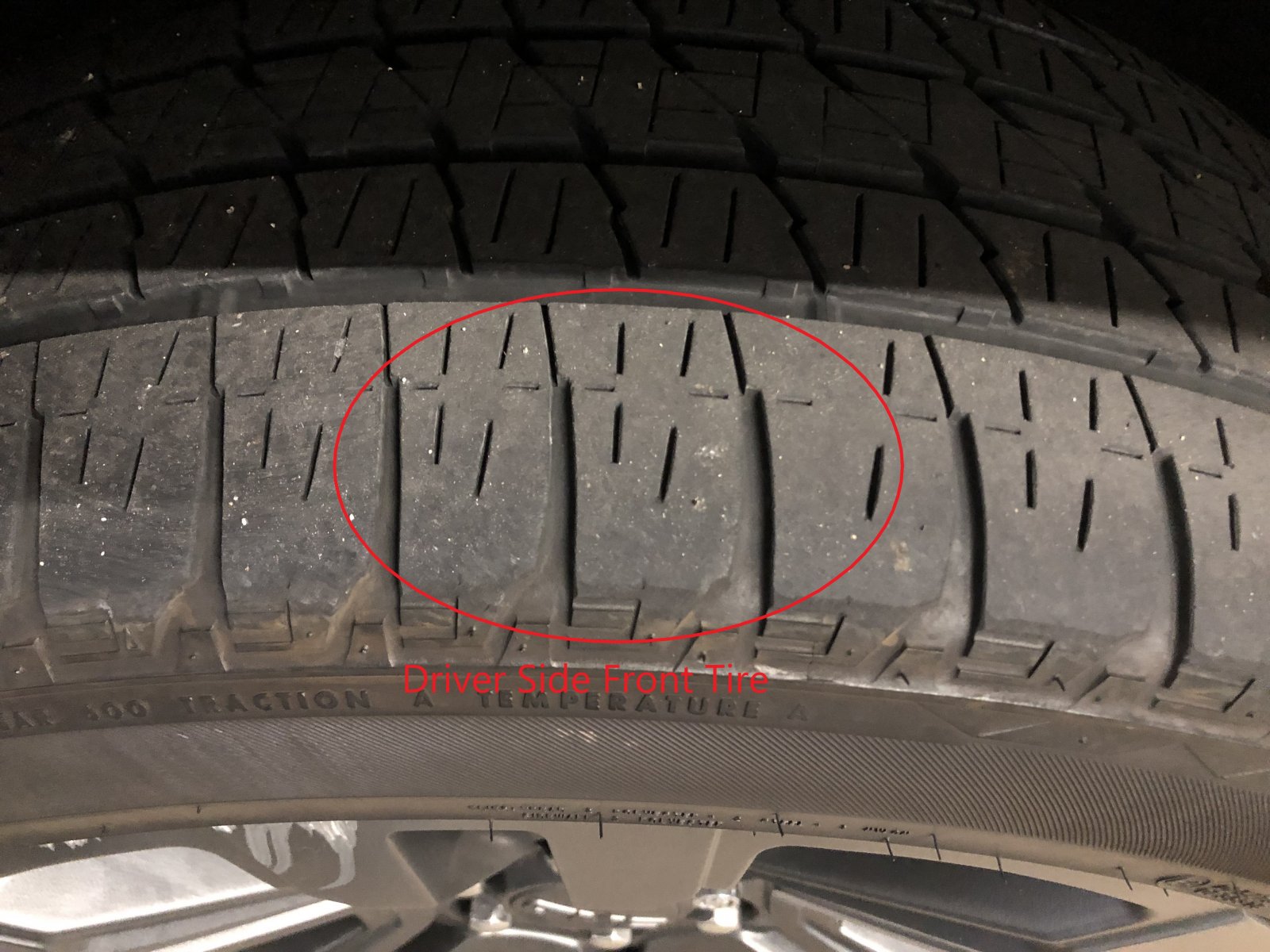

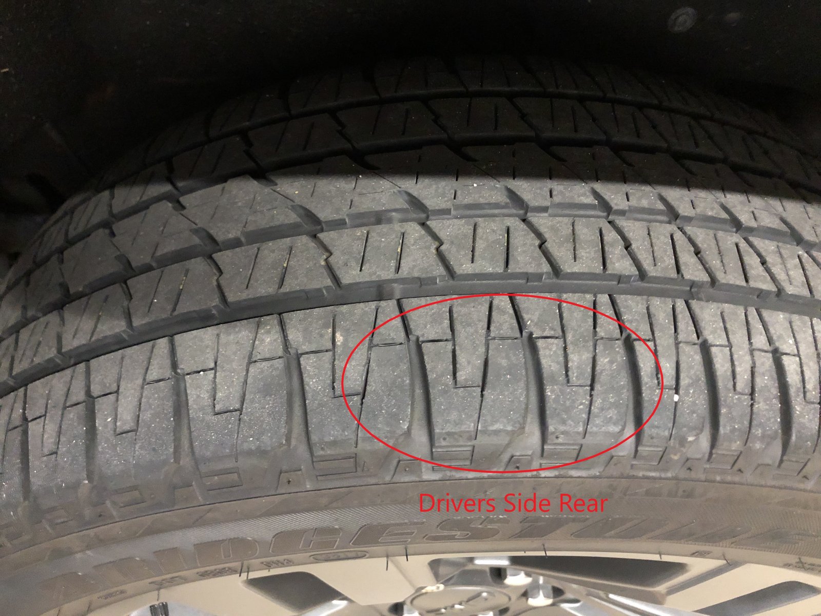

I think you are over analyzing it, if the alignment technician finds anything out of spec they will tell you, for instance if they cannot get the alignment within spec there could be a worn tie rod, etc, plenty of reasons to be needing a alignment like pot holes, hitting a curb, minor accident, etc
Over analyze...LOL. I tend to do that. Appreciate the advice. Time for a alignment.

How is a 4-wheel alignment performed on a vehicle with no adjustment provisions to the rear axle?
Unless that's what they're calling a thrust angle alignment.

You need an alignment. The alignment sags after it leaves the factory and a proper alignment (meaning all things adjusted to center-of-spec even if "green") should be performed in the first few thousand miles and then it should be checked once a year or 12k miles after that. I'd bet you have something like -0.7 to -1.0 degrees of camber and the toe is out. Also, 12k miles is far too long on a rotation, it should be done every 5-6k miles tops. The Bridgestones are bad about wearing funny if you don't rotate enough or have a good alignment.

I'd bet on a slight alignment issue that has manifested itself over the 25K miles on your rig. I just put on new tires at 19K miles and had the alignment checked - found right front was slightly out of toe spec.
