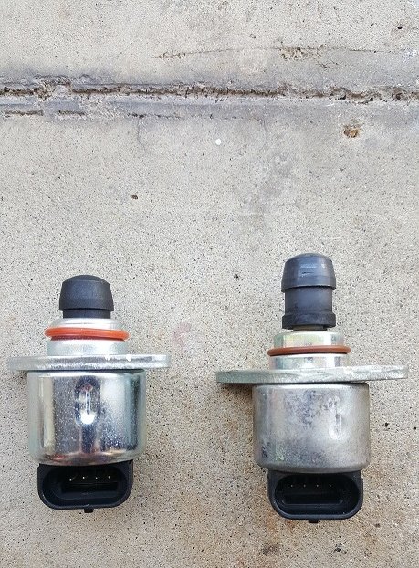

I took off the TB and gave it another good cleaning. I took the IAC out and it seemed to be out more than it should. I could see the spring. So i pushed it in a little and it stayed. It does appear that it is getting stuck some how internally. I put everything back together and fired it up. The idle is higher that it should, but no more bouncing around. It fired up and its staying at 900 rock solid. So it does appear to be the IAC is getting stuck some how. I ordered another IAC and that should do the trick. Once its installed I will post my results.

Installed the new IAC and its still doing the bouncy idle when cold. Idle steady at 450 when warm. What else should I look at now?
Here is the new IAC and the old one. You can see how far out the plunger is from the new one, but its still doing the up / down idle.
Is their a cold air or cold coolant temp sensor that is giving bad readings when cold>
Thoughts?
