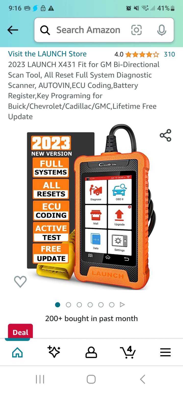

but...I just ordered this:
2023 LAUNCH X431 Fit for GM Bi-Directional Scan Tool, All Reset Full System Diagnostic Scanner, AUTOVIN,ECU Coding,Battery Register,Key Programing for Buick/Chevrolet/Cadillac/GMC,Lifetime Free Update https://a.co/d/ffxI9sV
For about the same price that supposedly has free updates. I watched some YT videos of it, seems legit, cheap enough for a first "real" scanner to learn with hopefully.

Please let us know how it works out for you. Does it do idle relearn?
