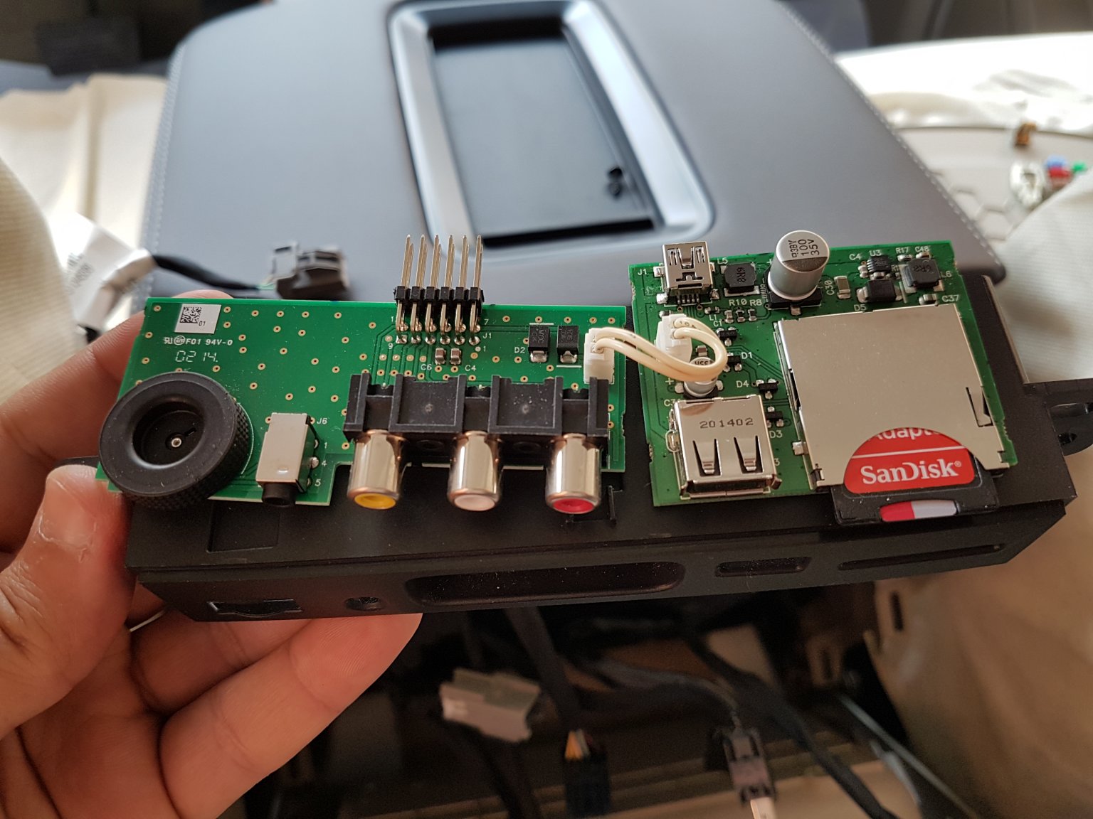

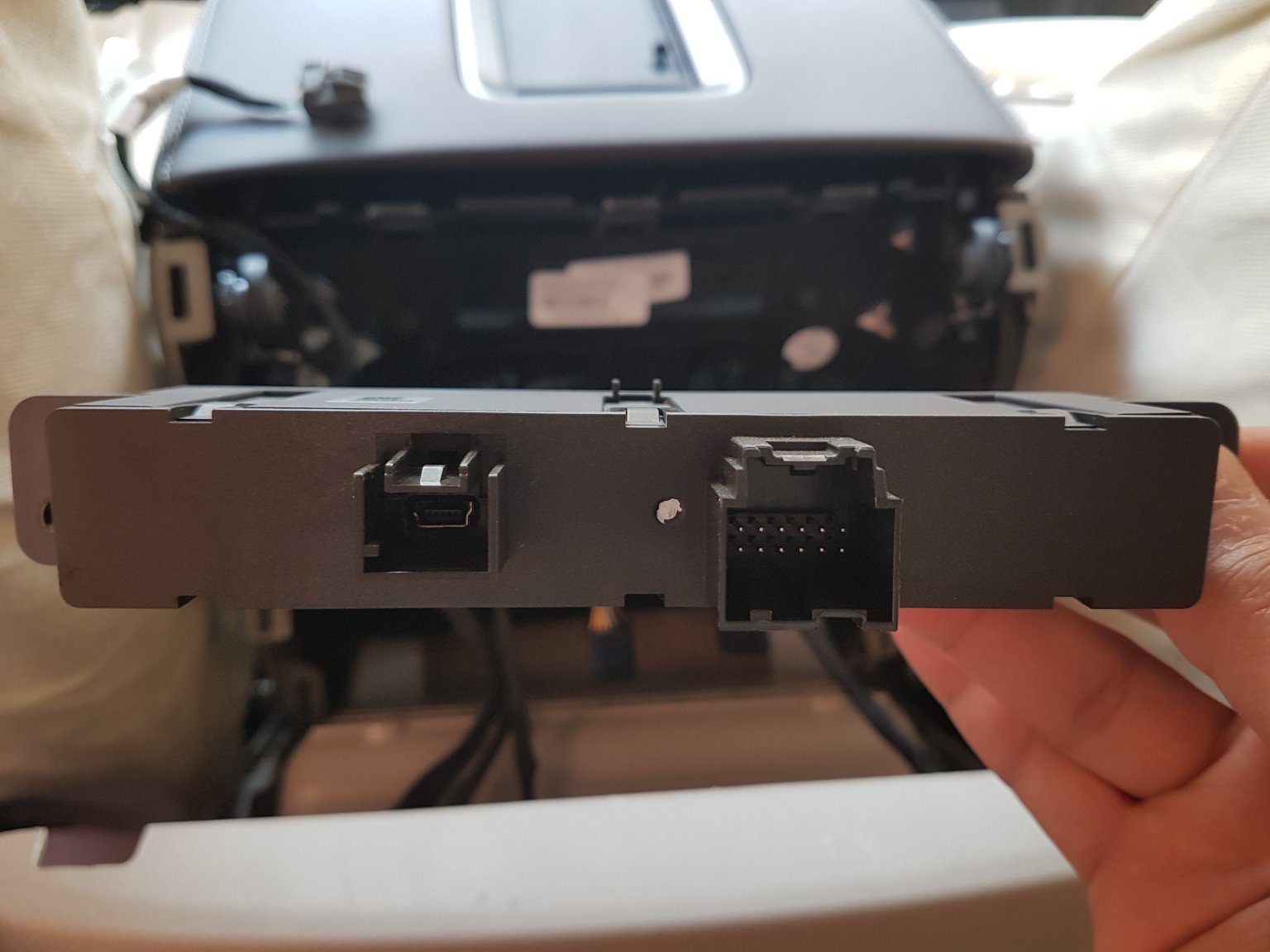

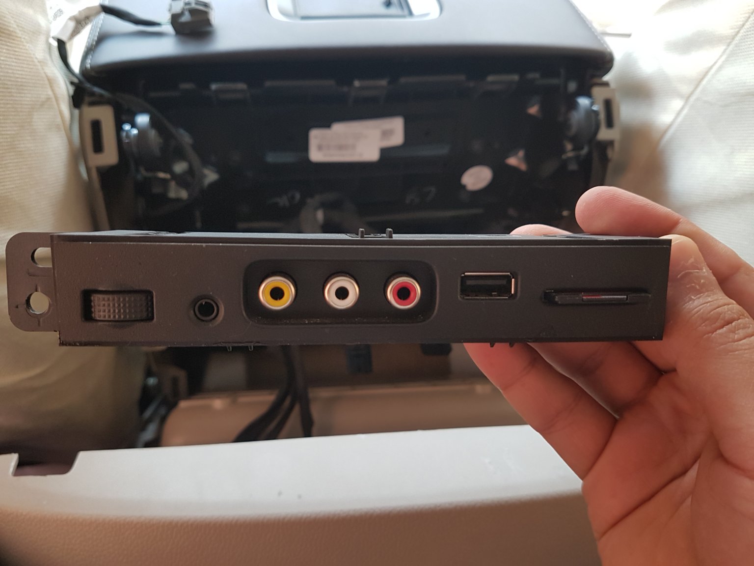

Here is what the 2017 input board looks like.
I do not have a 2015-2016 to test it on.
Anyone got pics of the older version?IMG_6515.JPGIMG_6516.JPGIMG_6517.JPGIMG_6521.JPG

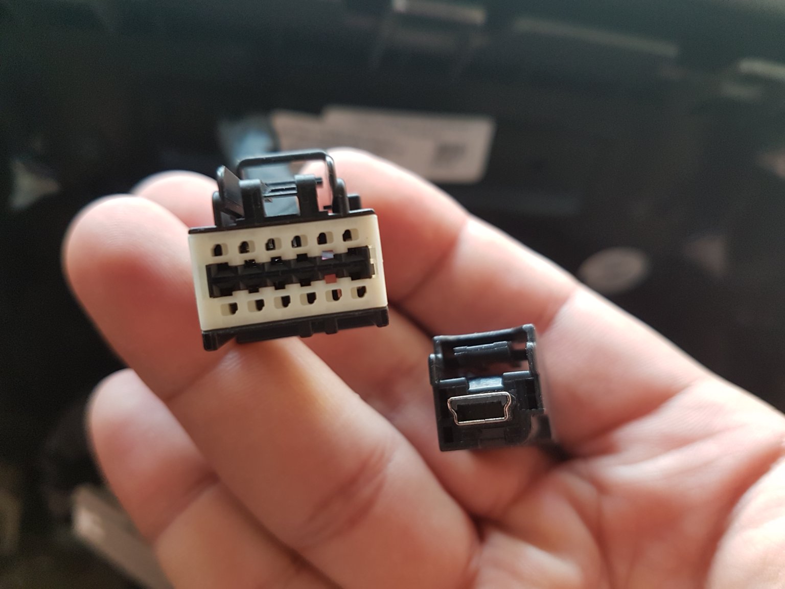

From the looks of this unit, if the connectors are the same as the 2015-2016 trucks, it should be plug and play.
Of the three major chips on this board, one of them appear to be a digital to analog converter.
http://www.ti.com/lit/ds/snls336j/snls336j.pdf
http://www.latticesemi.com/~/media/...alsummary_SiI-RS-1063-C.pdf?document_id=51701
http://www.microchip.com/wwwproducts/en/PIC18F26K20
