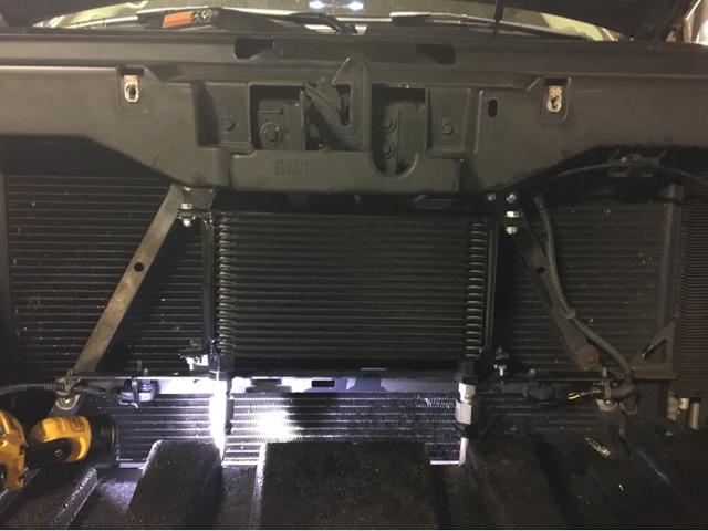

I wanted to update this one last time for the temps I have been seeing:
Morning: 80F/70% Hum ambient, trans temp runs about 160F
Afternoon time: 95F/ 85% hum ambient, trans runs about 170F
I just added a PML deep trans pan which so far is dropping the temps about 10F.
Keep in mind this is at highway speeds so cooling is much greater. When I hit stop and go traffic the temps will rise roughly 10-20F depending on how long I am in it but top out there.
This morning was the first morning I drove with the trans pan on and was running 150F @80F/65% hum ambient. I had the blessing of having to do stop and go for about 10 minutes this morning (idiot drivers) and maxed out at 170F.
At this point when I start towing, the temps are going to be what they are going to be.
Summary: with upgraded aux cooler and trans pan I see about a 20-40F drop in overall temps in any condition/environment.
If the fluid hits 200F or slightly above it is only for a very short period of time and is cooled back down quickly (trans housing never goes above 160F) so I am not going to worry about it. I will change the fluid more often (every 30K).

20-40*F drop seems pretty solid to me.
