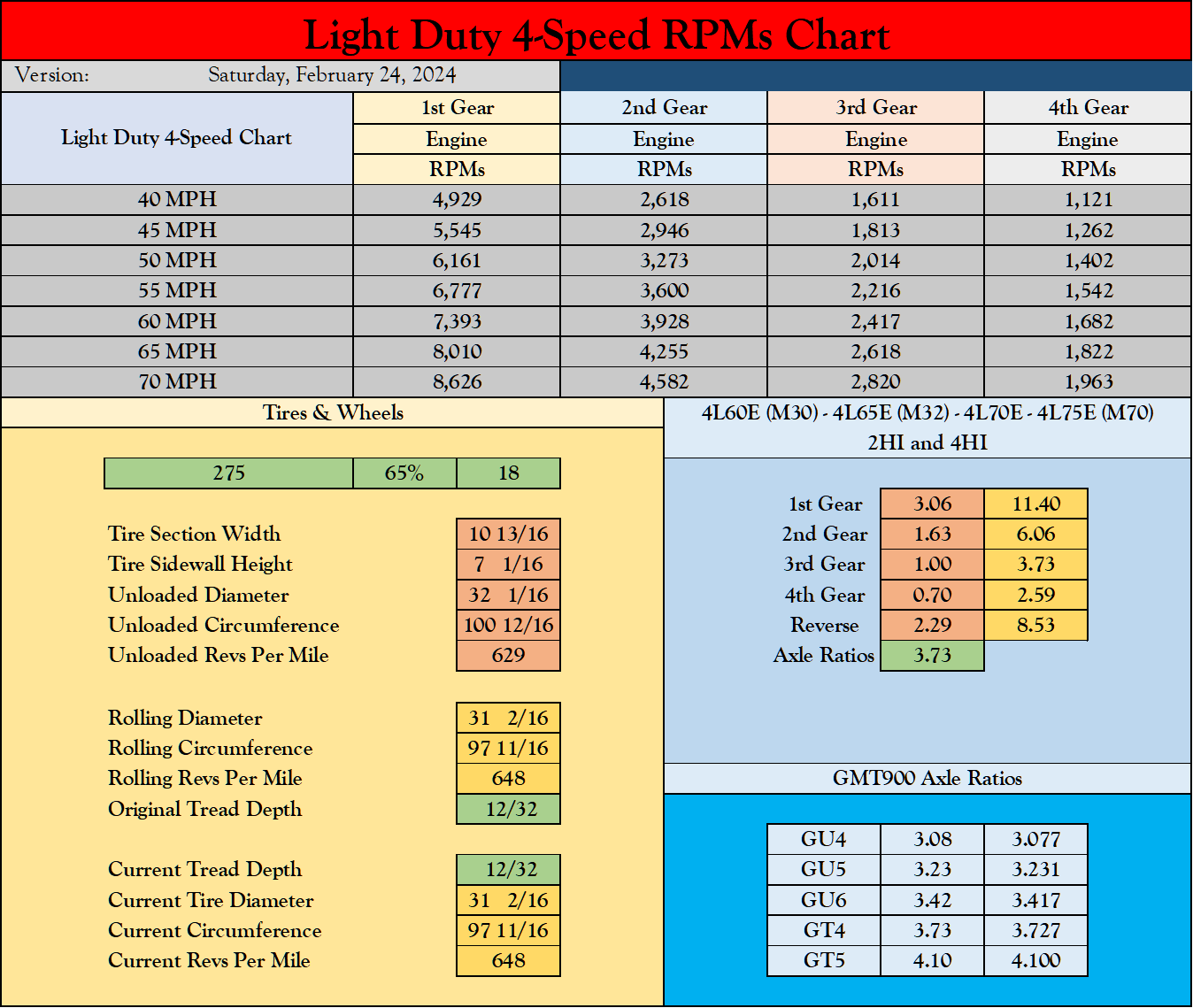

Well, I started out with 3.42 and cruising at around 1,750RpM and now just over 1,900. So 4.30 would be 300RpM more at the same speed.
Going to hear those extra RpM through the cab. If I were a kid street racing, maybe, but not now.
Use my calculator, it's more accurate! ;)
3.73, 275/65R18, 70MpH, 4L60's 4th = 1915RpM . . . Makes me miss my Caprice wagon with 3.42 & 235/75R15 . . .
4.10, 275/65R18, 70MpH, 4L60's 4th = 2105RpM . . . Soon as I find a 4.10 rear axle and a 4.10 front diff . . .
4.10, 275/65R18, 70MpH, 6L80's 6th = 2015RpM . . . Schidt. Just convinced myself. If I ever get a GMT900 with a 6L80, 4.10 - and I may never tow anything.
By then I'll be old enough to have suffered just enough hearing loss that I either won't mind or won't notice the extra RpMs through the cab.
Close but no cigar!

6L80 has a much lower 1st gear (about 4:1) than the 4L60e (about 3:1). 4L80e was an even higher 1st at about 2.5:1.
10L80: ... 4.69 ... 2.99 ... 2.15 ... 1.77 ... 1.52 ... 1.28 ... 1.000 ... 0.85 ... 0.69 ... 0.64 (7.32 Spread)
8L90E: ... 4.56 ... 2.97 .... 2.08 .... 1.69 . . . . . . . 1.27 ... 1.000 ... 0.85 . . . . . . 0.65 (7.01 Spread)
6L90E: . . . . 4.03 . . . . 2.36 . . . . . . . . . 1.53 . . . . 1.15 . . . . . . . 0.85 . . . . 0.67 (6.01 Spread)
4L60E: . . . . . . . 3.06 . . . . . . . . . . 1.63 . . . . . . . . . . . . 1.000 . . . . . . . 0.69 (4.43 Spread)
4L80E: . . . . . . . . . . . 2.48 . . . . . . . . . . . . 1.48 . . . . . . 1.000 . . . . . 0.75 (3.306 Spread)
Reason why I included 8L90 & 10L90 is, after FIVE DECADES of undergearing to lick CAFE's undercarriage, EVEN GM CONCLUDED:
yea, needs more gear.
4.03 x 4.10 = 16.52 ... 6L80's 1st, times the axle gear GM offered optionally for 2500 & 3500 with 6L90
4.69 x 3.23 = 15.15 ... 10L80's 1st, times 3.23 (nearly every truck / suv with 10L80 has 3.23 axle)
4.03 x 3.73 = 15.03 ... 6L80's 1st, times the axle gear Dave09 suggests (which GM gave to 1500 pickups but NOT suvs with 6L80)
If you care more about unladen highway MpG than towing MpG, 3.73.
If you care more about towing MpG than unladen highway MpG, 4.10.
