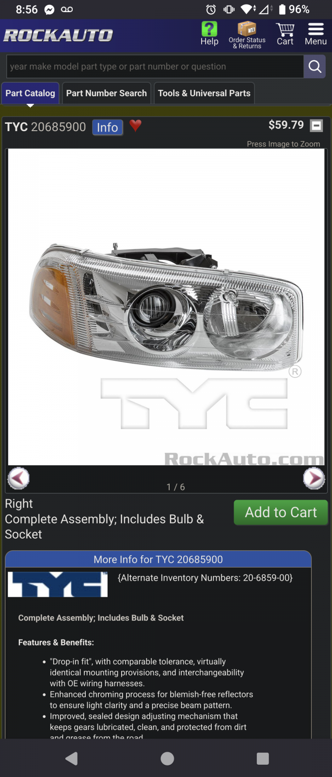

On your Yukon I would go for the factory Denali headlights. Looks like the TYC's on RockAuto are about $60/ea plus shipping.
The lower assembly is just running lights and turn signals. Replacing those won't do anything for light output, but if they are discolored you can get a fresh set on RockAuto as well.

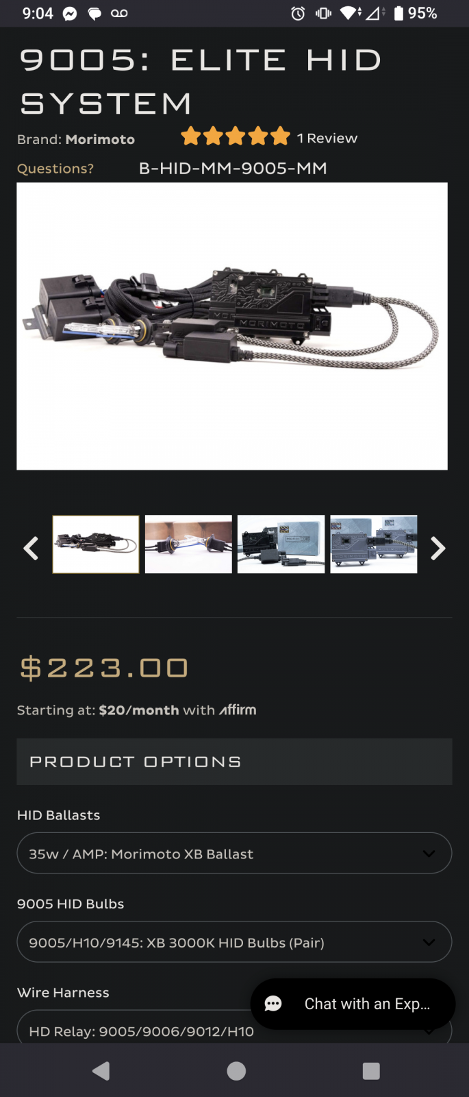

As for bulbs, I had good luck with Morimoto stuff back when I was doing conversions. I haven't done one in several years, but they were very high quality with good light output back then. I'd recommend their 35w 3000k HID kit. I'll drop a link and a screenshot.
A couple years ago I bought the Morimoto HID for my Yukon fogs. ( I'll install then one of these days)..... But the Denali housings..... a great price, for sure!
