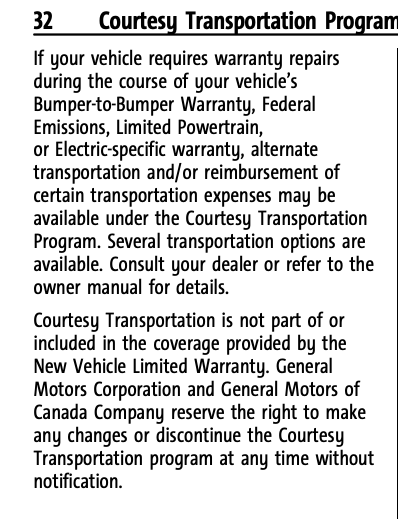

They should rent you a vehicle from Enterprise and GM/The dealership should cover it. No questions asked. If they are not willing to do this, they are a LOUSY dealer. That's the least they could do for a customer of a brand-new vehicle. I wouldn't be afraid to get the GM of the dealership involved.
If you did not buy the vehicle from this particular dealership, would you feel that we should have the same right in demanding things? I'm in the same situation where my brand-new Yukon with less than 8K miles on it has and is the shop for the 6th time. The dealership I bought it from is 100 miles away from me and I feel weird complaining a lot to my local dealership
