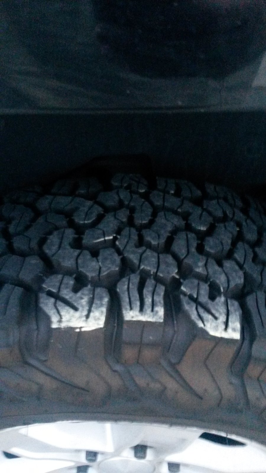

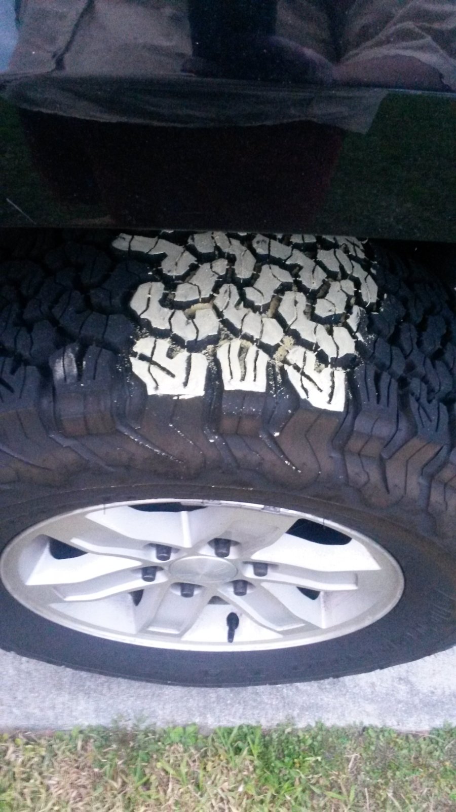

3 days since last refuel and 14.5 mpg now. Babying it, not revving past 2,500 rpms mostly, running the speed limit. Staying away from idling situations and heavy traffic. Tires at 41 psi cold. BFG says to put them at 50 psi. Keep forgetting to do the chalk test, but keep forgetting where I put the chalk!
The sidewall says 50psi or does BFG specify 50psi for that tire on your particular vehicle?
20,144
27,454
I spoke with someone at BFG about my vehicle and those specific tires. On the 2500s the front pressure for an LT tire is recommended at 50 psi and the rears 60 psi.
I was trying to keep them as low as possible to give as nice a ride as possible without wearing them out prematurely. I ran them at 30 psi and it was smooth as butter but the load rating at that psi doesn't even support the truck empty, let alone each axle and the whole thing fully loaded. 41 psi was calculated to support the GVWR and the GRAWR but the lady at BFG insisted on sticking with 50 psi which is more than enough.

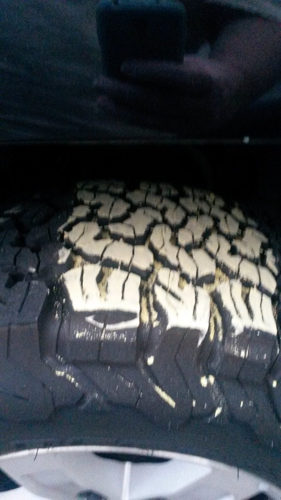

I still haven't done the chalk test, two weeks with the flu and the aftermath am dealing with still. It was a major milestone just to get to the store and buy a new Lucas grease gun, even with help from my bride. Was supposed to do all this stuff today but the kids are off to church for an event so maybe later or some other day again. Too weak to work on it by myself.
44,962
Props to you for understanding the tire manufacturer's psi rating on the sidewall versus your vehicle's pressure recommendations. :waytogo: So many people think that any pressure under the maximum PSI listed on the sidewall means that the tire isn't "full" and is being ran "low", regardless of what that tire is on.
I find that the chalk test isn't accurate enough for me, but I tend to geek out on details.:oops: The difference between under-inflated and over-inflated is too wide of a range to be seen due to the available resolution of chalk on concrete. You have to have fine-quality chalk (maybe a pool cue chalk?) and super smooth concrete. Even then there are other factors. I just compare the tread wear when I rotate the tires. I'd like to see your results if you ever get around to doing it.

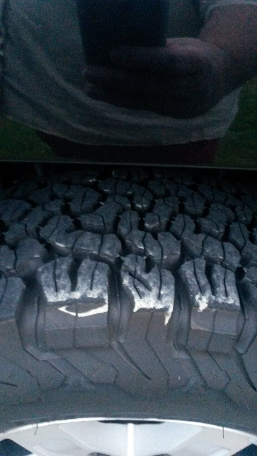

Thanks! I was in the tire business for few years and got good training, drag racing didn't hurt either, adding much to the knowledge base.
The tires have worn 2/32 since new and evenly across the whole tread on all four. So there's no sign of over-inflation or under-inflation even though I've been running them mostly in the 30s for the majority of the time. For the past month or so they've been at 41 psi cold. The weather has changed so they'll need checking again.
