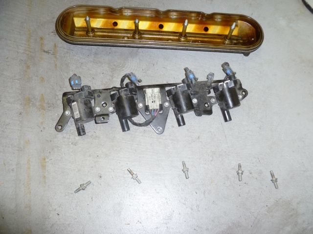

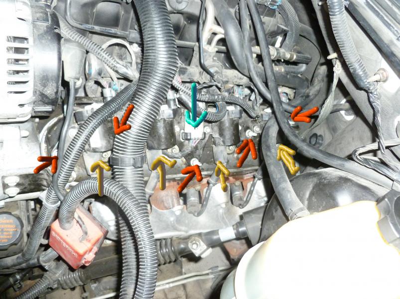

First, take off the coil packs. The pics show the driver side. They are held on by 5 bolts that bolt onto the valve cover (orange arrows). You only have to disconnect the ONE electrical connector harness in the middle (green arrow)...the individual electrical connectors do not have to be removed. Didn't know that at first so the pics of the parts on the ground show the coil packs disconnected from the little wiring harnesses. remove the spark plug wire from the coil packs (yellow arrows). I do not recommend removing them off the spark plugs themselves (I broke the first one by trying this--10 year old wires beak). Leave them dangling from the spark plugs.

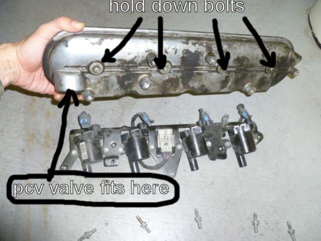

After you get the coil packs off, then clean the dirt from around the valve cover. Then you can back out the 4 bolts that hold down the cover running along the center of the cover.
Remove PCV valve from cover...it just pulls up and out, ( near the firewall), then remove cover.

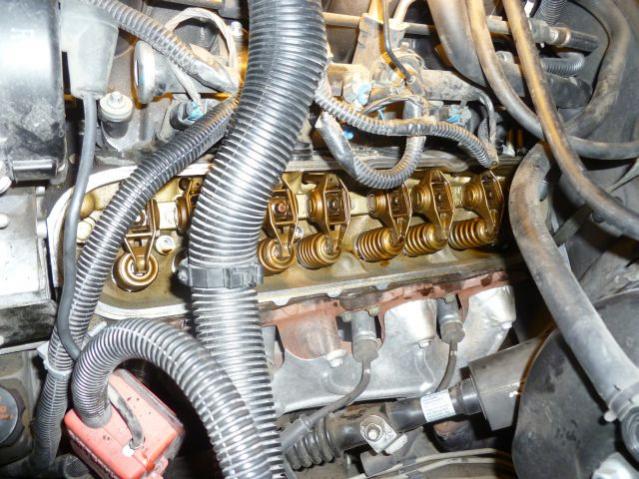

The third pic shows whats under the valve cover. 4th pic shows the underside of cover, with hold-down bolts.

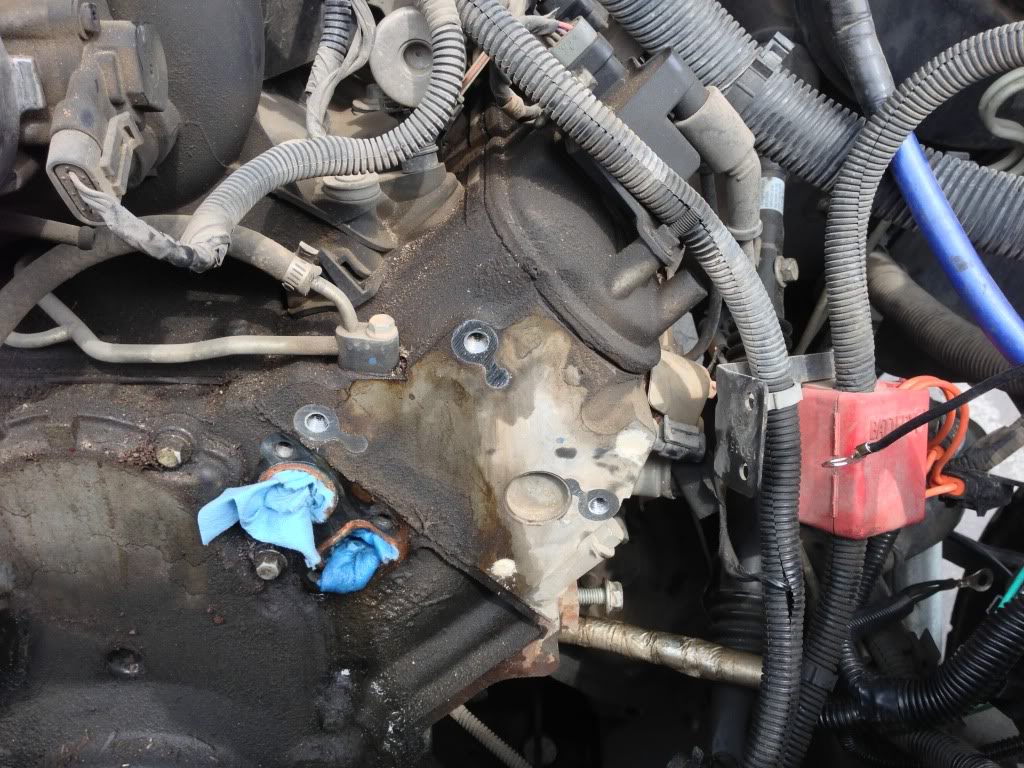

The gasket sits in a groove around the base of the cover, easy to remove and replace. Since it's rubber, it does not require any sealant, or so I have been told.

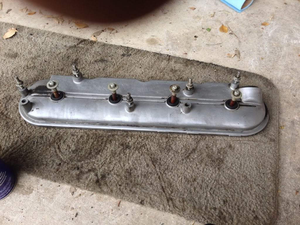

Thanks for the kind words everyone. Had to do this again chasing down an oil leak. I used felpro kit with grommets. I don't remember having a hard time keeping the gaskets from falling off when putting the cover back on, but I sure did this time. I had to use some dabs of silicone glue/sealant in a few areas (like little spot welds) to keep the gasket in the cover groove so it won't fall out. If anyone has better method please chime in. BTW, dealer here wanted $480 to do this, so doing it ourselves makes me feel even better now.

So how the heck do you replace the grommets? I did VC gaskets and have the grommets but couldn't figure out how to get the damn bolt out to put the grommet in...i feel foolish because I used to swap cams in my old LS1 like changing underwear.
In short, brute force. It helps to have it slightly warm, and the bolts slightly oily. I pulled on the bolt to remove it from the valve cover and the grommet comes with it (170k miles on these grommets though...didn't change them on the first go). Then I pulled the grommet over the lip of the bolt. Getting the new grommet back over the bolt was far harder...lots of twisting, pushing , pulling, cursing in disbelief, but it does manage to pop over the bolt lip eventually. I didn't warm up the new grommets, and I should've as an afterthought. Then pushed the grommet and bolt combo back into the cover. Hopefully someone has a more elegant method, but that's just not my style.
