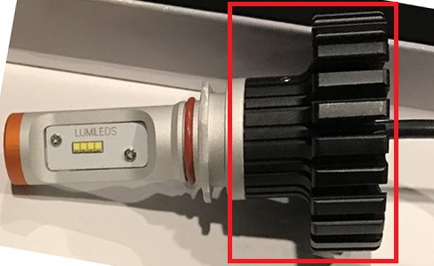

It's just a small set screw on the side of the heat sink base (see red circle below). It requires a small 1.5mm allen wrench to tighten which IS included in the package you will get from Vanquish Auto. Tighten the screw all the way, just remember it is aluminum (a soft metal).

Is the main heat generated from the lights mainly outside of the housing? This is my biggest concern as I've seen many reviews discussing how much heat is generated from these setups. If it is inside the housing, there's no doubt that it will eventually cause problems. I do prefer this easy plug and play setup over HID.
The heat is generated by the 8 LEDs within the housing, but the main portion of the heatsink (which dissipates the heat) is outside the housing. Everything in the red rectangle below is outside the fog lamp housing.
