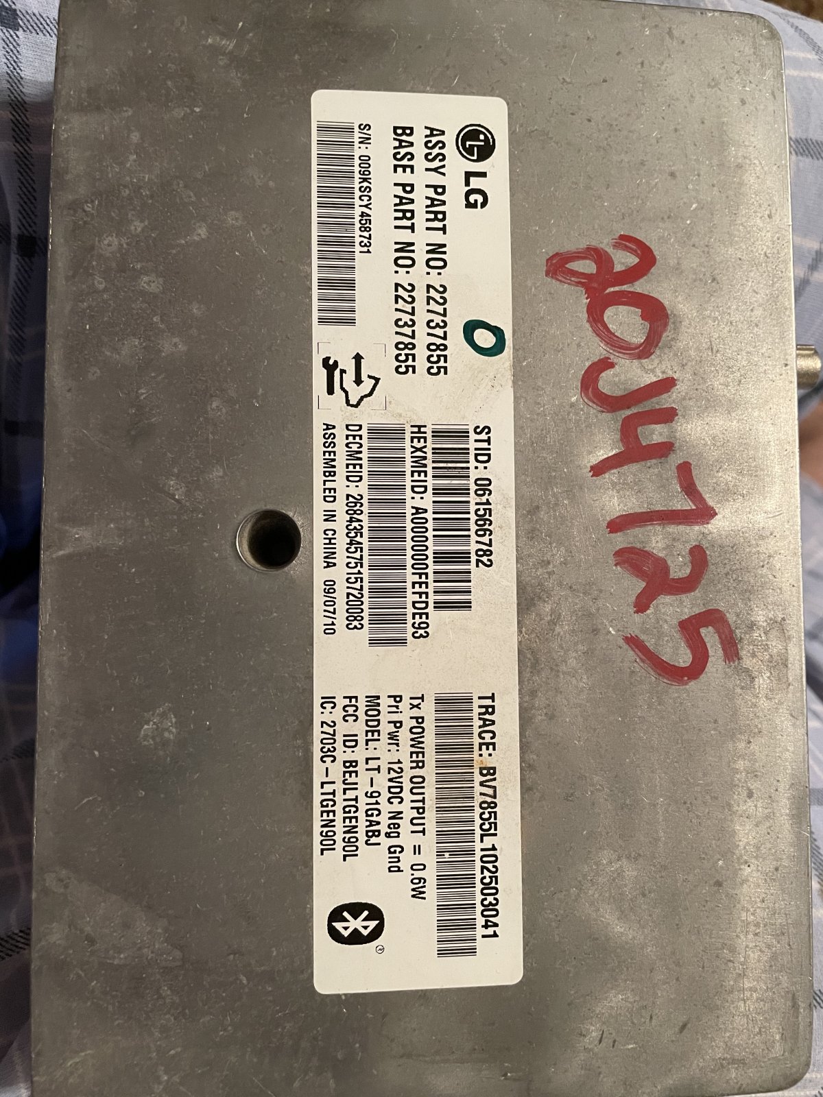

sodbuster
Jul 26, 2021
Are you talking about bluetooth radios or bluetooth accessories that will work with OEM recievers? I'm only interested in adding bluetooth functionality to my OEM radio. I picked up a vcim at kosisky and am waiting on the Y cable I guess will see. UpandDown mentioned a 5V bose module for streaming music, are you talking about the vcim, or is there another part I need? thanks much
