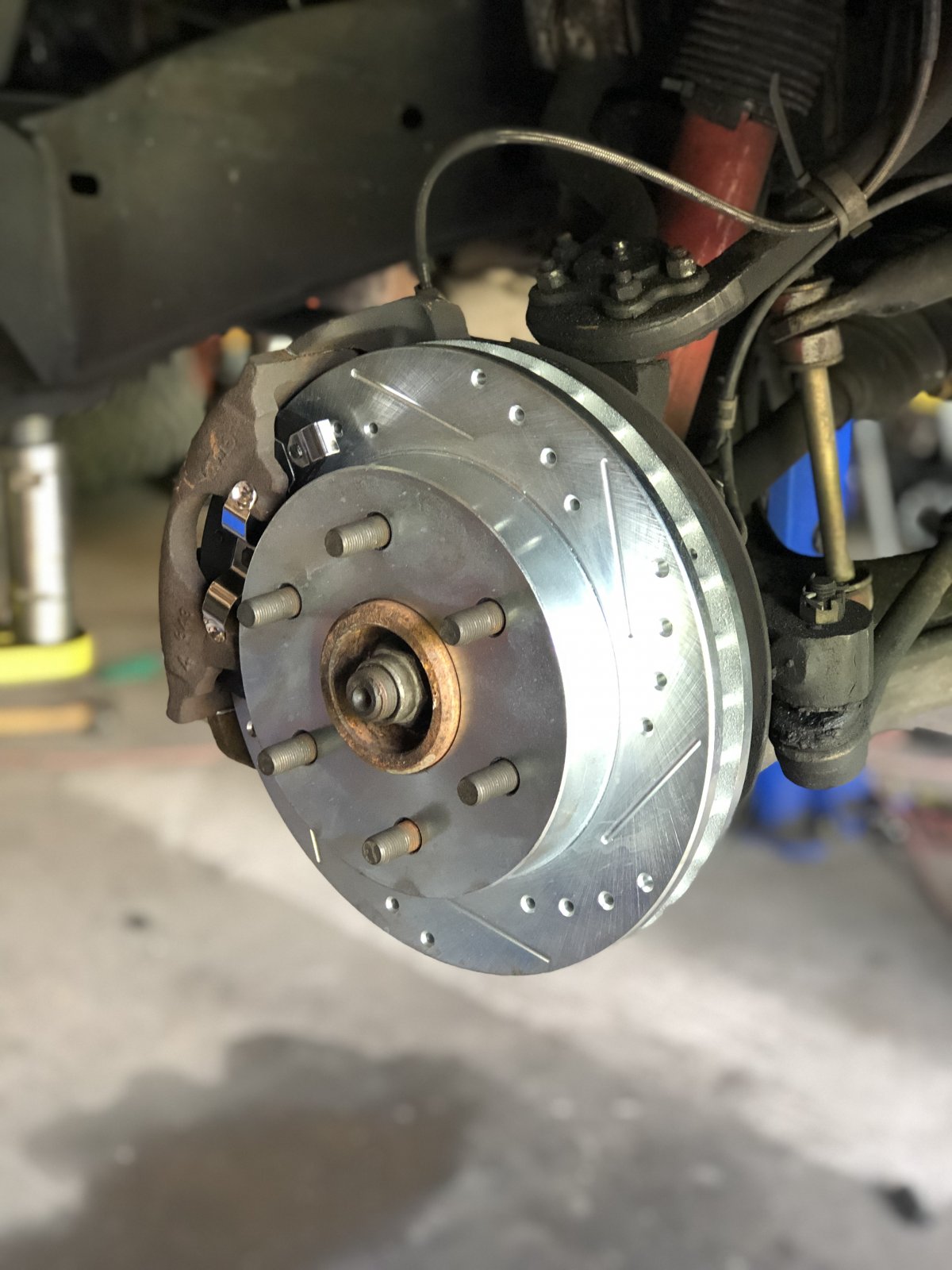

No hydroboost yet fellas. Forgot the steering pump at home. Still stops better than before though lol
kbuskill
Mar 11, 2017
5,378
8,484
NE. FL.
I know you are going hydro boost but...
Just FYI... you can install the rear wheel cylinders for a 1 ton pickup on the rear end and get a little more braking power. The wheel cylinders on the 1 tons are a bigger diameter piston.
When I had my first gen Escalade I did that along with swapping the master cylinder over from the newer gen trucks because they run a bigger diameter cylinder inside the master as well. It only required one adapter where the brake line screwed onto the master as the newer trucks run a different size fitting on one side than the older trucks.
The newer style master gets rid of the spongy/soft brake pedal feel the older trucks had.
Wow, that’s great to know! I love little nuggets of knowledge like these
