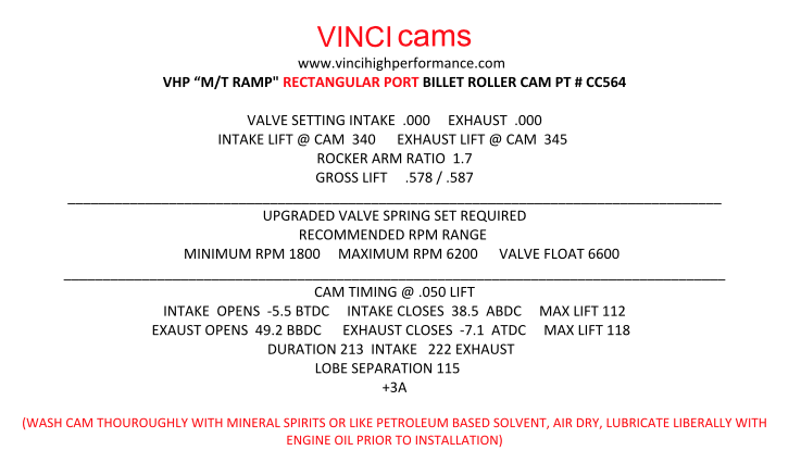

You don’t have to sacrifice low end grunt. Have a talk with Roger Vinci @ www.Vincihighperformance.com and tell him what your plans are.
I had a really good experience with Roger Vinci's support. His cam didn't work out for me because I had some oiling and foreign debris issues when I installed it that led to a lifter failing and damaging the cam. However, Roger did warranty the cam for me anyway and sent me a brand new one. Unfortunately, it was too late because I needed to move ahead on the project and went a different way. But, that means that I have a full set from Vinci for the 6.2 that I could give you a good deal on, including the cam, matched dual springs, matched keepers, matched pushrods, and brand new valve stem seals. All you would need is a set of lifters - the Morel 6504s would be perfect.
I can tell you that while I ran this cam the performance was stellar. Big gains in both low and top end power that pushed me back in my seat. It would also be a good cam for future power adders.
Roger doesn't do VVT cams, so it's a 3-bolt cam and I haven't missed the VVT on either the Vinci cam or the Brian Tooley cam I ended up using.
If you're interested, OP, let me know, and I'll make you a good deal.

Roger is a genius in matters of LS engine valve trains imo and the dude is seriously into helping people out. When I was doing a cam swap after my blower install and thinking of getting a trans built and converter, he answered so many questions I had and made recommendations based on my current and future plans. Your offer sounds awesome.
