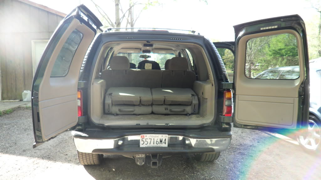

Is it the same with Burbs? Mine is an '02 and has barns.
That brings another question, can you swap from Barn doors to Lift gate? Is it feasible, and if so what does it implie?

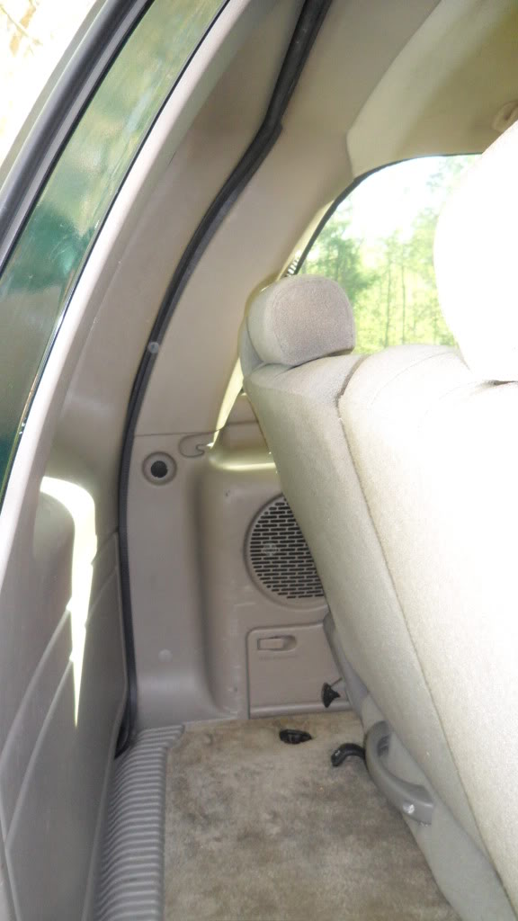

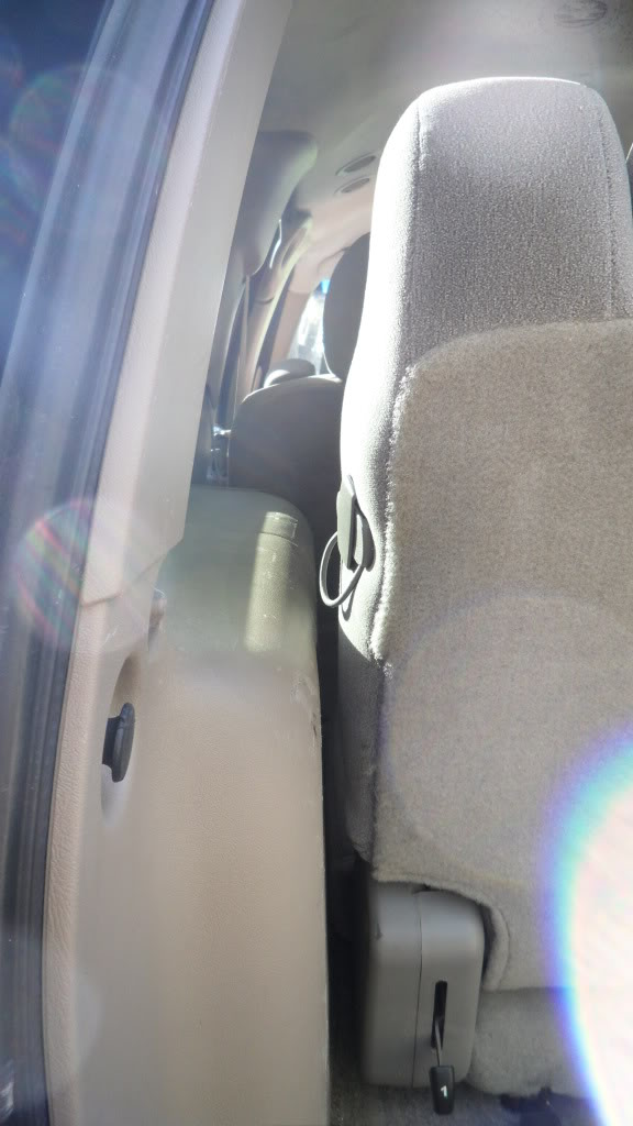

Everything I have read indicated that the barn doors would hit the back of the seat when they are up.

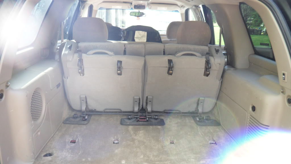

well, unless it is a Escalade ESV (Esky burban) you may be in trouble.
I am not aware that the 2nd row interchanges, nor that the 3rd row can swap between LWB and SWB SUV.
Suburbans have a significant cargo area behind the rear seats. I see no reason why rear door type would make any difference on fitting a 3rd row in a Burb. The Factory on the other hand never offered a 3rd row/barndoor combo on SWB.

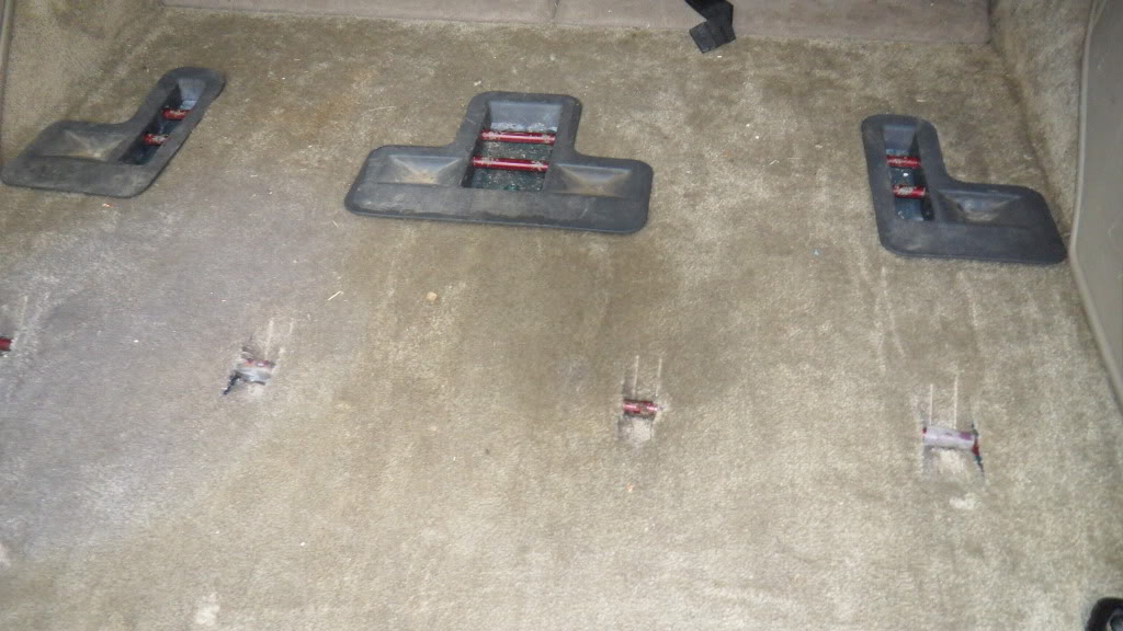

Great video I was just looking into that the other day. I thought the hoes came with the brackets already hidden up under the carpets. Good to know, that they are not just incase I decide to proceed with adding a 3rd row.

I checked in my truck today and i have the pockets in front and i'm like the others at the rear portion, it looks like i need to remove those caps and get some brakets.
