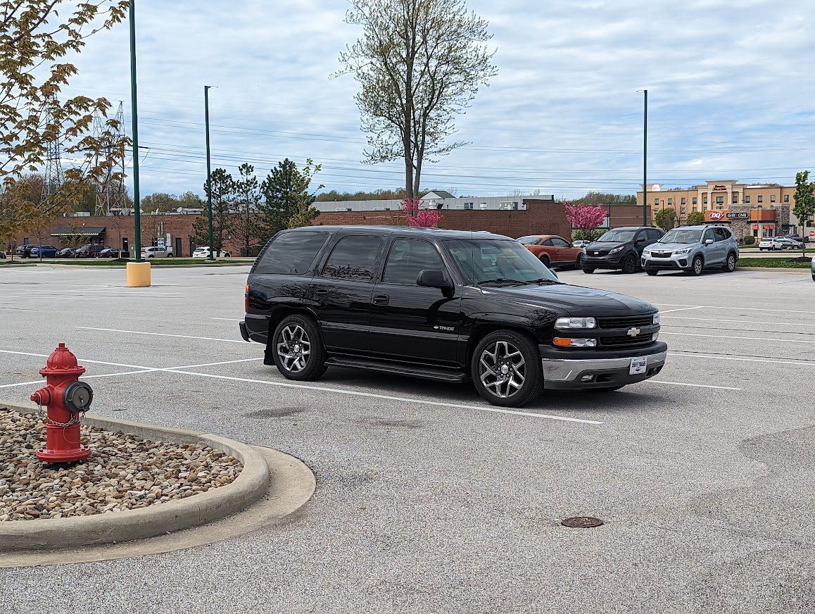

I would like to get the back down another inch, right now sitting on 4" Belltech Pro Coils. I like the way they feel and the way the truck tows.
Conflicted on if I even want to mess with the suspension anymore. lol.

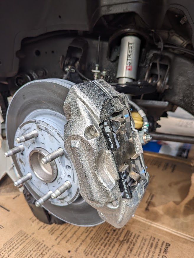

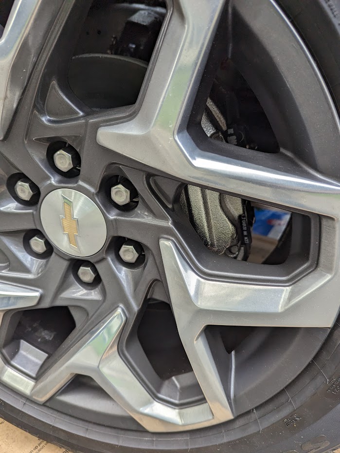

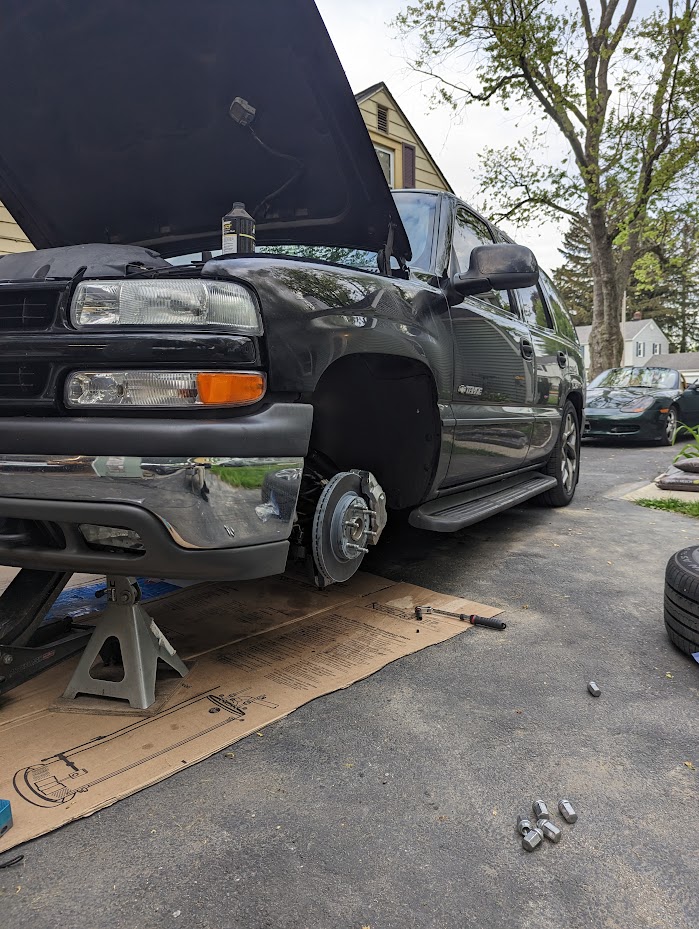

I did finally get rotors and pads off a 2022 truck. I've had the calipers since I sold my 21' back when you could get them *NEW* for $75 before all the NBS cavemen went crazy for them. (Wait. I'm them.)
I drove it today for the first time since December. lol
Still have one side with steps, one without. I think I like the steps and I'll put them back on eventually....but I still can't make up my mind fully.

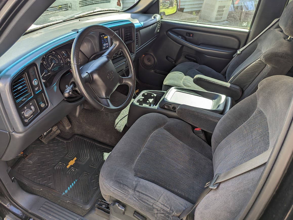

But this 2001 does everything I need and more, gets 20 mpg, and includes some of the best seats ever put in a vehicle. Add the cheap parts, ease of repair, and no payments and I'll run this as long as I can and enjoy it all the while. Plus its way better looking imo.

Have a link to them Pro coils? I Googled and what I saw looked like TBSS coils used for big rear drops. With those coils, the top 3-4 coils are compressed and touching. They're "dead" and just acting as spacers. They can be cut out for more drop without affecting the ride or load capacity.
Otherwise, try stock Jeep TJ rear coils :p
