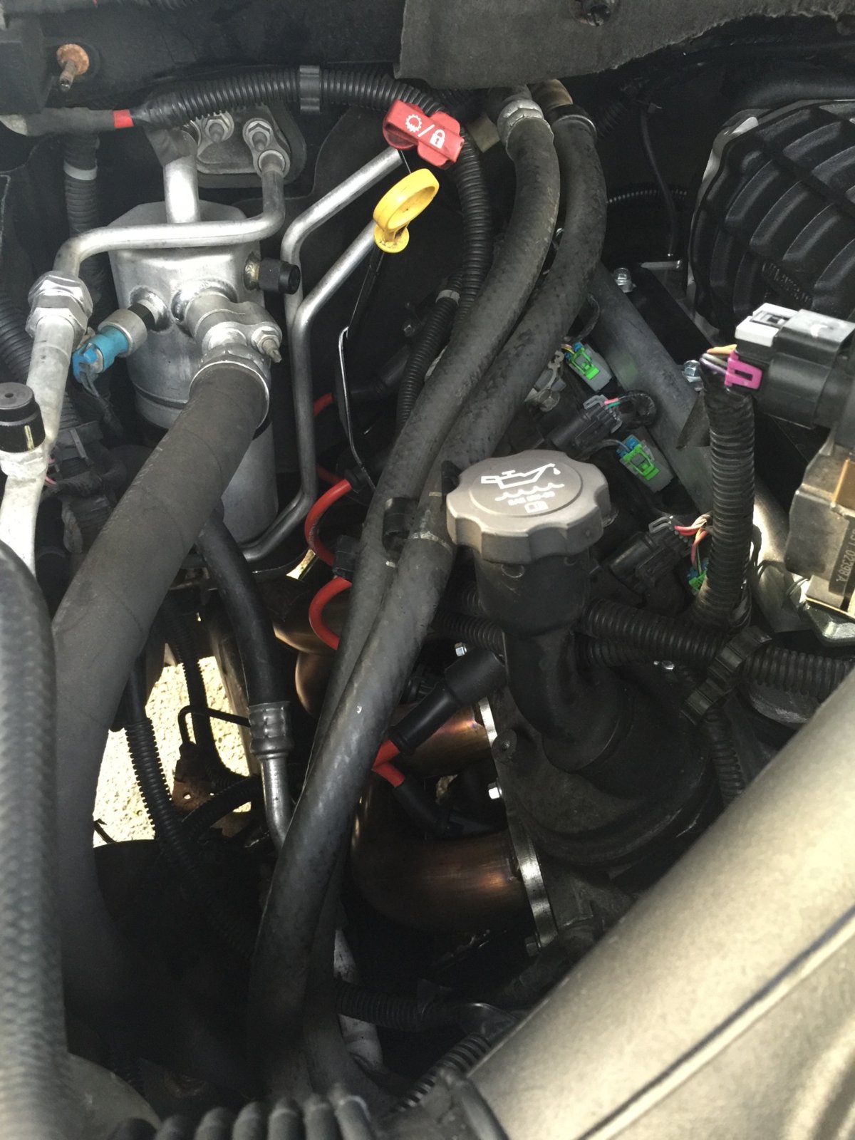

No problems with NGK TR5 and magnacore wires for my Maggie
