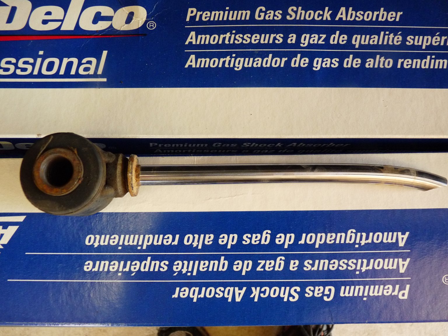

Back on topic and back to the shock. This is/was not a manufacturing issue.

My problem with Arnott is they call the autoride shock a rebuilt shock, when in fact it is not. I mentioned that Arnott shock as being an “old shock,” because the OP mentioned autoride, (these are active shocks) and the other shocks (passive) are not autoride, it doesn’t matter if it has an airbag or not (this is how the manufacture defines it, not me). You are painting this with a wider brush than I am. The manufacture defines autoride as active shocks. I do know a bit about these dampeners, I designed assembly cells for Delphi for these dampeners, when you take the “active” part away, it’s no longer an autoride shock. And I do know the MR shock was not offered for the GMT800. The two shocks, bi-state and MR look physically the same (and are still called autoride), but are in fact very different internally. The only way of telling, is part numbers or looking at them internally. The MR shock was reserved for higher end cars, and my GMT900 (top of the line Yukon Denali) still did not receive an MR dampener until later years of the GMT900. To be able to tell if my truck came with a bi-state dampener or MR, I had to call an old co-worker to check the Delphi part numbers, (now BWI) to verify.
Yes, hard to tell what caused this, but with the bag fully filled, and the shock fully extended it should not put the piston rod in a bind and cause the rod to break, they are designed to do that.

@02Lightning yes I understand what you're trying to say and in a technical sense you are correct in the nomenclature of the exact definition of what an autoride shock is but for the most part most of us use a broader definition. As I said earlier you are technically correct, but let's stay focused on helping the OP and not making this a " you're wrong and I'm right" thing. I disagree with you in the broader sense but agree that you're technically right, if that makes sense. Please post to the OP if you have help and I'll stay out of this. I don't know how this could have happened, although it does look like the shock was overextended somehow. Good luck @MercerRec .

I'm going to take a stab here and say the auto ride was working fine. The shock being faulty probably caused the auto ride to over compensate. If it's sensing weight and not getting the proper resistance back from the shock then of course it's going to do something odd.
Good comment. I was thinking that the bag was fully filled, and at that fully extended position the leverage on the shock caused it to bend, then break due to the geometry involved in the rear suspension.
