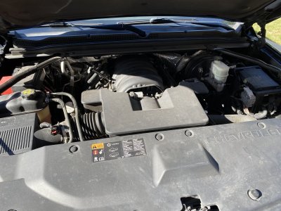

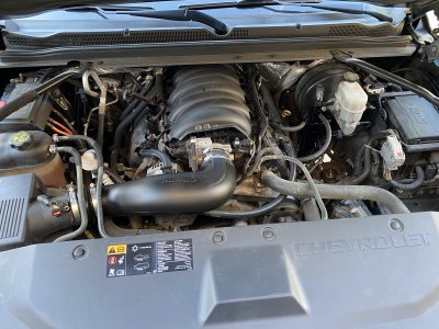

Next order of business was Airaid MIT and Elite Engineering catch can. Was also hoping to be able swap the belt tensioner but Amazon is running late. Sounds to me like the pulley is making noise, ordered AC Delco replacement.
Yeah, I need to clean the engine bay a little bit, too.

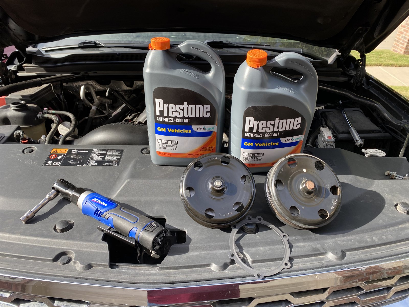

Changed belt tensioner and while some of the sound disappeared, I guess it’s time to change the water pump.
Pretty sure the bearing is shot since the pulley has probably 2-3mm play in it. Compared that to my Silverado and that thing doesn’t have any play whatsoever in it.
So... On to the next little project it is. Good that I didn’t pay a whole lot for it so it gives me room to fix these things.
